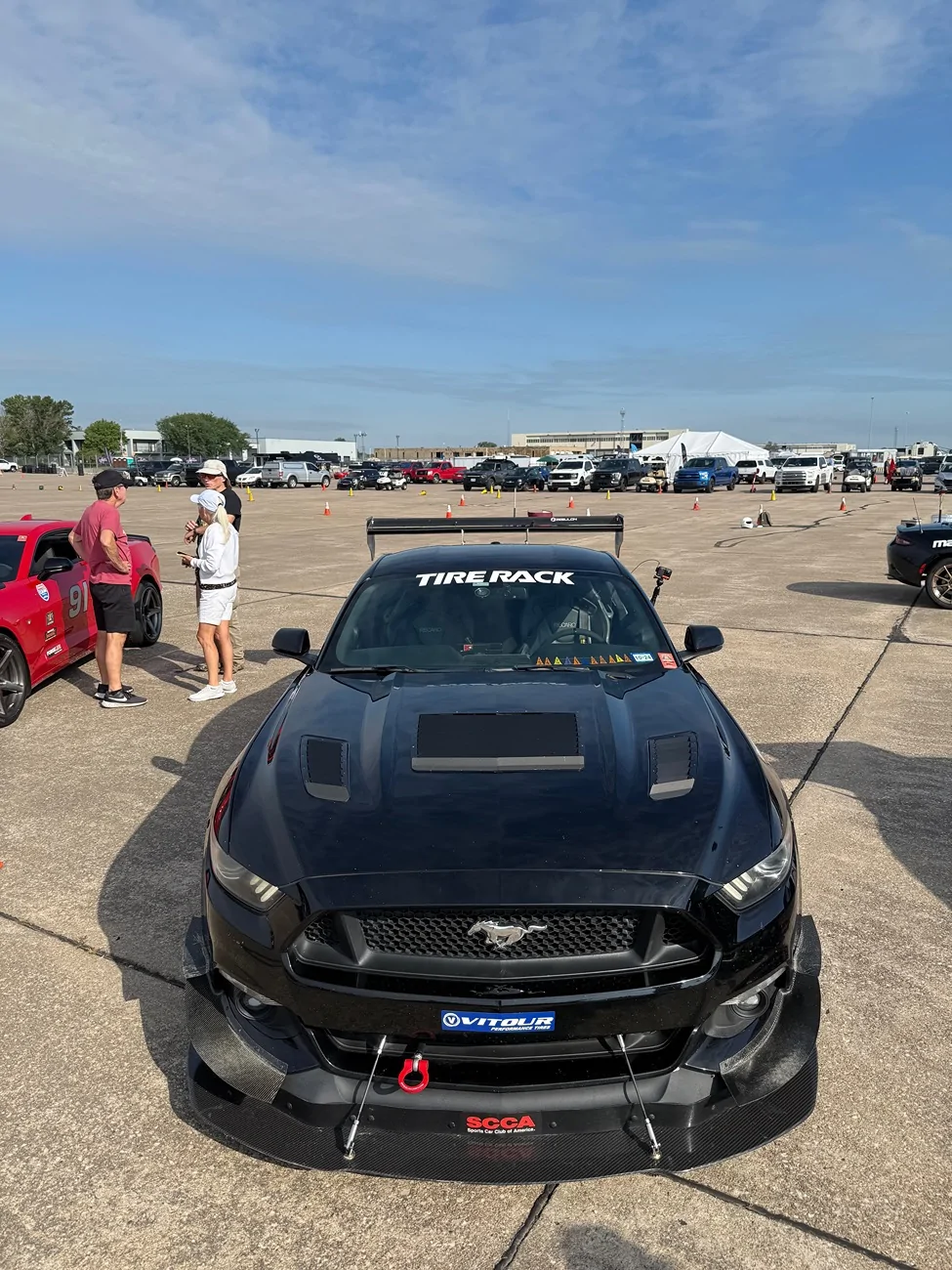

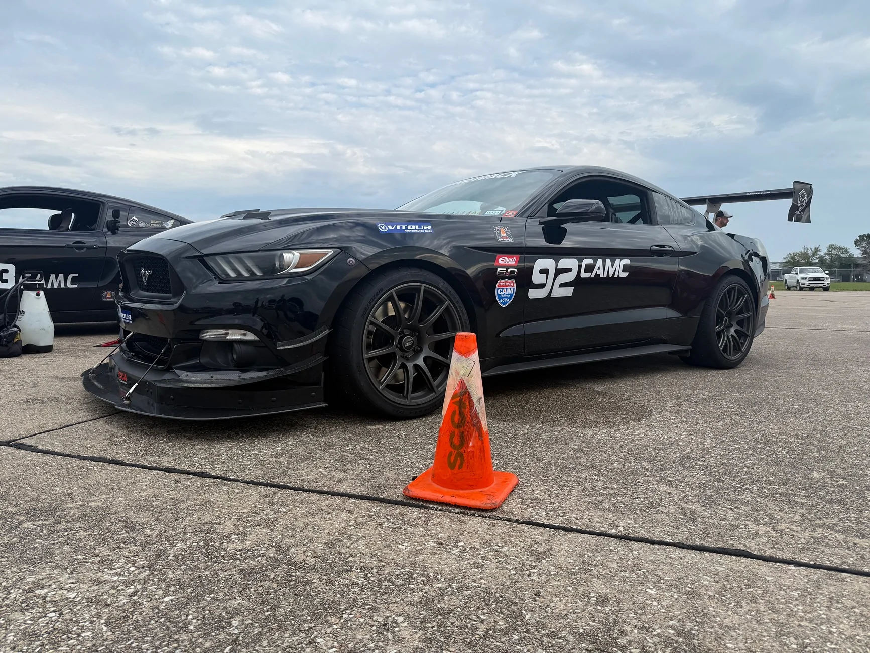

Im maybe considering rebuilding the splitter this winter for the 3rd time to the new rules (wider on the sides) and adding some more contouring/depth to the bottom edge like a GTD or Ford GT
