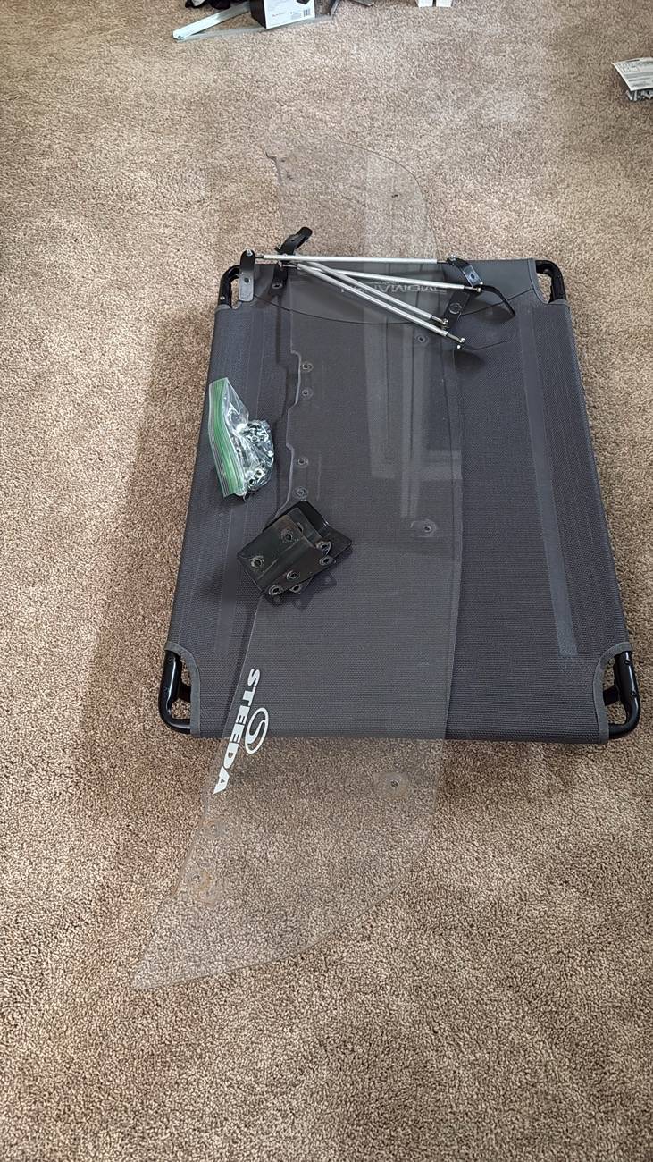

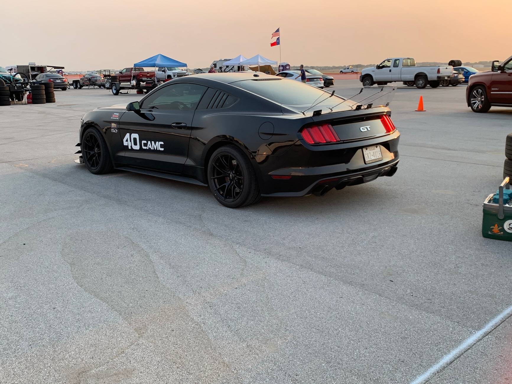

If anybody wants a good 2022 CAMC Solo Nats winning lexan spoiler, Im trying to get rid of mine before I move.
Comes with mounting brackets and supports. You’d have to modify a decklid you provide, but its set to work well on a factory spoiler trucklid widening but basically reusing and covering existing spoiler holes.
DM me if interested. Lots of DF and stabilizing drag for confidence in those high speed offsets and sweepers. I can even throw in a smaller variant for track use (slightly shorter).
im happy to make a classifieds post but this is a pretty niche offering.

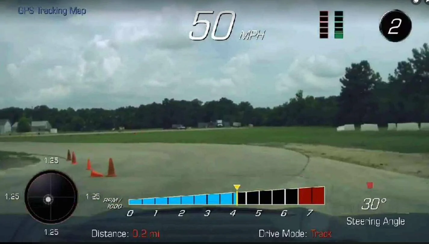

Ended up getting a lot more testing this weekend than expected with the new build.
Refresher, setup is pretty basic on a heavy Premium/A10. MCS 2WNR (internal doubles), 450/550 spring rates, 18x11.5 w/315 A052s (2yr old tires from other car). -3.5/-2.5 camber. Custom 3pt rear upper rear mount.
We got 19 runs in the car. Wife ran 5 saturday with me as passenger and tweaking shocks between runs. I hot lapped 9 runs in an hour just driving. Sunday I ran 5 more.
Wifey has been racing with me for ~13yrs, typically 2-3s off my times. We ran in track mode with TC/AT on. She's not super aggressive on throttle so likely only hit WOT coming into the finish. But she found a flow and we were able to go "too far" on the shocks so at least got a decent baseline.
She ran a ~57.5 on her 4th run in the car. Caveat, we drive AWD. RWD is totally new.
Afternoon we had a Test-n-tune session and I was hot lapping the car only bleeding tires for 5 runs. Then I only stopped long enough to spray tires and get back in line for another 4 runs. THEY WERE HOT YOKS! I ran TC off but AT on.
Take-aways, off throttle the car was shockingly good. Better midcorner control than my Evo. Exit was rough. I had to be very cautious/gentle on throttle. If the back started to move it was really non-progressive and took a big time hit to get back under control.
I managed a non-perfect 54.4. A competitive PAX run would have been a low 52. Fun, but not quite fast enough yet. It seemed obvious we needed more front sway bar.
Sunday, our plan to run a Tesla we're working on fell apart so hopped back into the Mustang. Since I know we needed more Front bar, I decided to simulate that by disconnecting the rear bar. Otherwise, exactly the same as previous day. A solid A/B comparison. The car was going to be floppier but data points are data points :)
Lawdy, that was a whole a$$ revelation in balance. TC/AT both off, it just drove like a car I actually had control of. A little bit more push in certain sections, but completely usable throttle. Each run was picking up more and more time as I'm learning both RWD and the car. With a push deep into a showcase sweeper I ended up with a 51.1. Forgot my tablet for SoloStorm but have a good enough feel for the potential to be mid 50s.
A PAX competitive time would have been mid/low 49s. Which sounds a ways off, but not terrible considering no rear bar, soft front bar, ~3800lb car, stock power, and 2yr old tires. The courses were also extremely transitiony (if thats a word). Like almost no pure acceleration zones, and hands were very busy at all times. MX5s and Twins heaven.
Learning was the goal, and the goal was met! So what's the plan?

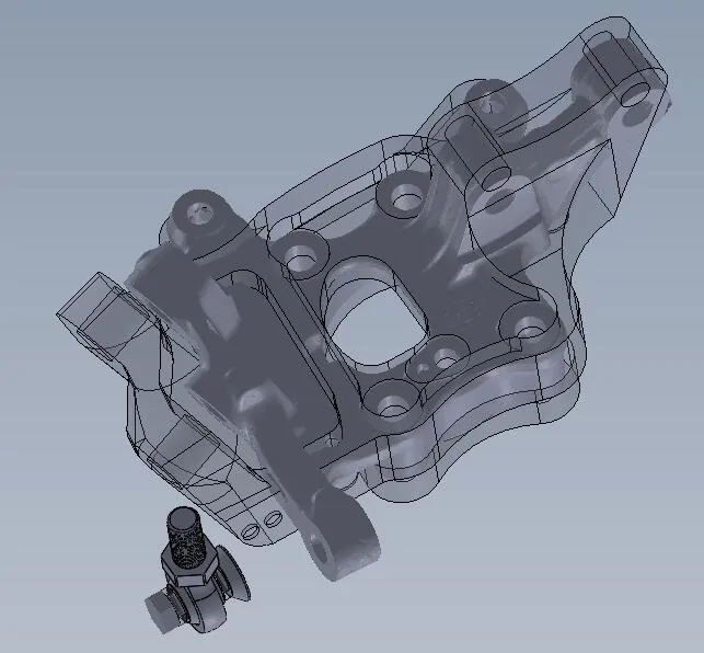

Im still working on the billet uprights but the steering arm part is tricky. Its mounted really low and wheel clearance is an issue to get a standard double shear adjustable mount. On the plus side, increasing steering rate by 10% (16:1 to 14.6:1) actually helps clearance.

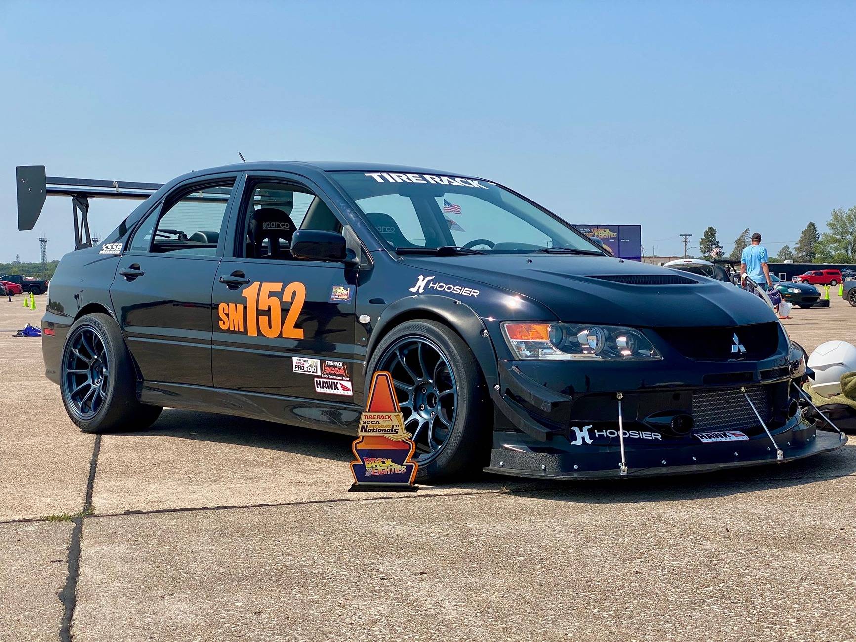

I am looking for a spare trunk lid to make wing mounts and swap over the Evo/Ciro wing. That one is pretty high on my priority list, at least for major winter changes. Ciro doesn't make (or I haven't found it) a mustang specific mount so since I already have a wing I'm gonna make my own.
