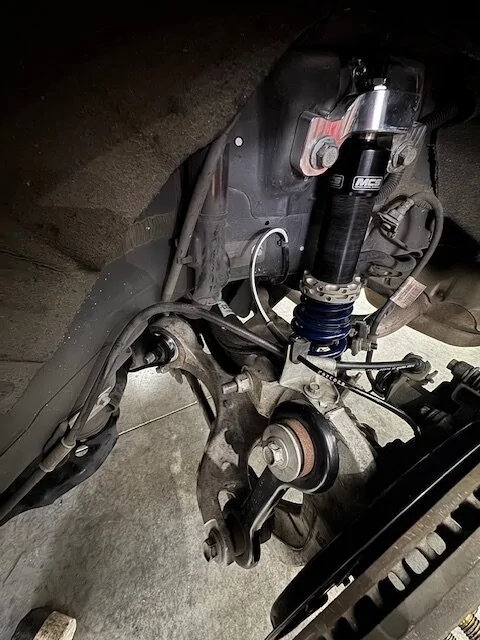

Got some of the changes knocked out over the last week.
  • Rear lower control arm - forward spherical
  • Rear Upright - Toe Arm FP spherical
  • BMR rear cradle lockout
  • Swapped from 450/550 to 550/700
  • Waiting for Steeda 35mm front bar that got lost and returned :(
Forgot how much changing bushings is a pain in the arse. Spent way too much time trying to press them out. In the end drilling around the rubber to push out the core then a hacksaw to break the shell was the most effective approach.
Dana Pants
Oct 11, 2018
1,179
1,216
Burlington MA
Dana
2018 GT PP1
The easiest way to deal with bushings seems to be a push-pull kit, not a press or ball joint tool.
