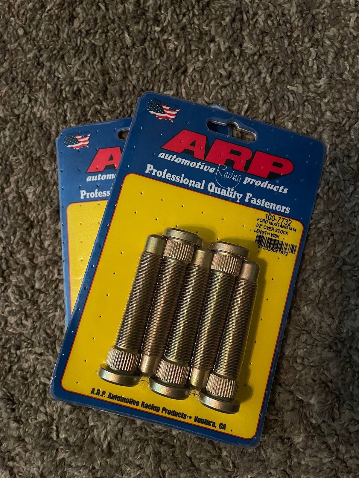

summit racing impressed me. $80 cheaper than anyone else. Received within 24 hours.
The build begins:

Right, except I’m pretty sure you needed the 1” longer than stock, not the 1/2 longer ones.
Welp. I thought 100-7732 was the number most said in forum. Its a 3” long. 🫣

100-7733 is the 1” longer stud for use with 25mm spacers. You needed the 3.4X” long ones.

https://www.summitracing.com/parts/arp-100-7733
So i don't make the same mistake. 2 sets of these correct.

Understood. I just ordered these ones since the part # matched what Nightmare said.
Should I keep the 1/2"ers? They are $13 to return and I am so miffed at myself.
I feel very old in this moment.
I think I will keep and put on the rears later on for increased stud strength/if I need/want spacers in rear later on.

I'd keep them personally, assuming they were under $100. Worst case, you can always sell them yourself.
I still run stock studs on the rear with open end lug nuts. No real reason to swap them unless you need to. (Someone will come along and tell me why I'm wrong, it isn't the first time)
