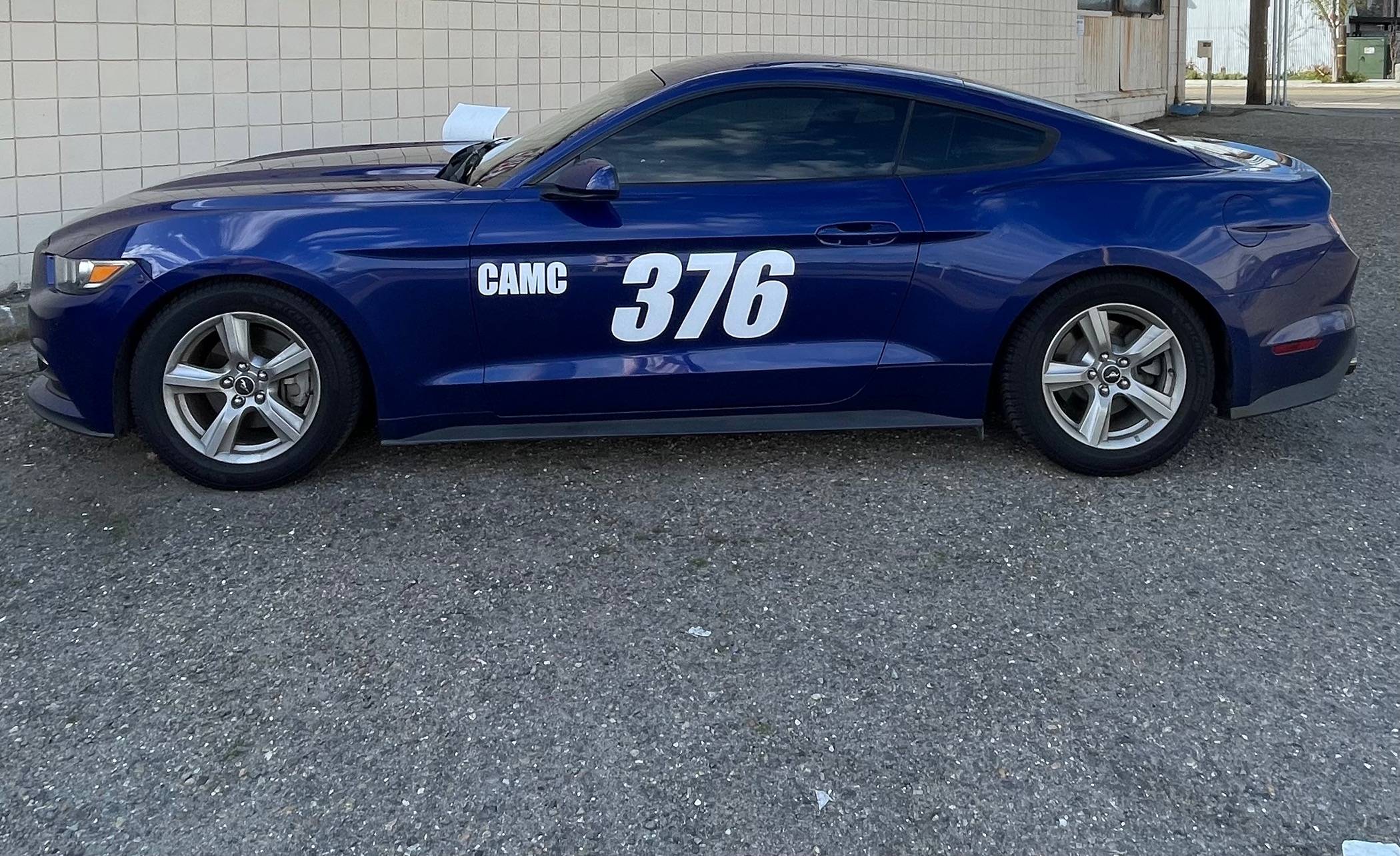

The morning session was cold, so I did a burnout to heat the rears up. No issues. For the afternoon session, the air was still cold, but the pavement heated up pretty good under the sun. I think there was a lot more grip in the burnout box, and my tires were not as cold. My tire pressure guy said I had a wild wheel hop, but it's odd because in the car, I felt nothing unexpected, and reviewing video, there is no shake in the camera.
The issue was forscan showed an erratic left rear wheel speed sensor code, consistent with wheel hop. I tried restarting the car in between runs, and no luck, the car wouldn't clear the code. I was able to get TC to turn off on my last run, and made up a second on that run, with the service advance trak, ABS, and steering fault codes flashing at me. What is annoying, in post tech jail, the car cleared the code, and everything was working again. I think the car needed at least 30 seconds to reset itself.
If this was a tour event, I could have quickly scanned and cleared codes and been fine. But the Solo format...just gotta make it work.
Steeda's kit doesn't "stop the hop" during a standard burnout, I need something that will. I'm confident I had 1st place but for losing out on the best session of the weekend due to the wheel hop. I am very thankful more stuff didn't break.

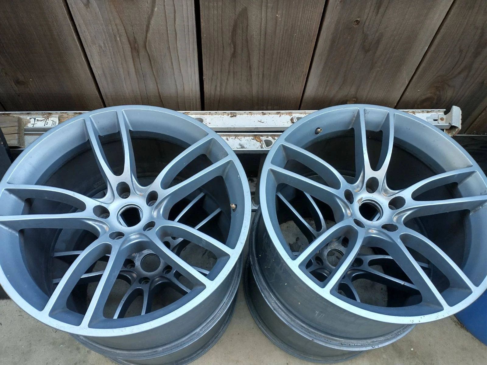

@NightmareMoon @mavisky @WltoTX Hello my friends, I secured a sweet deal on 19x11 SVEs that I absolutely could not pass up (i.e. nearly free, a couple days worth of beer money). I don't have perfect info on fitment, but I believe I will need to swap my front hub bolts to 3" and run a 25mm spacer on the *front only* to clear these monsters running 285 or 295s.
I am considering Apex Wheels Spacers (25mm) for quality purposes, what are your thoughts/suggestions if any please! Am I correct in thinking I need new hub bolts/spacers? Suggestion on good sets of lug nuts, or can I reuse OEM?
Super excited!
kz
Oct 26, 2014
4,627
2,943
West Chester, OH
Mustangs & F150
You need new long studs and at least 25 mm spacer - Apex or Optimum Performance (who also sells studs and nuts).
Why not go to 305 if you have 11" wheel (short of some gearing considerations) ?
Lug nuts - open ended Ford Performance ones work just fine. In fact I have unused set of SVE 19x11" in the basement I am considering throwing 305 71RS on.
