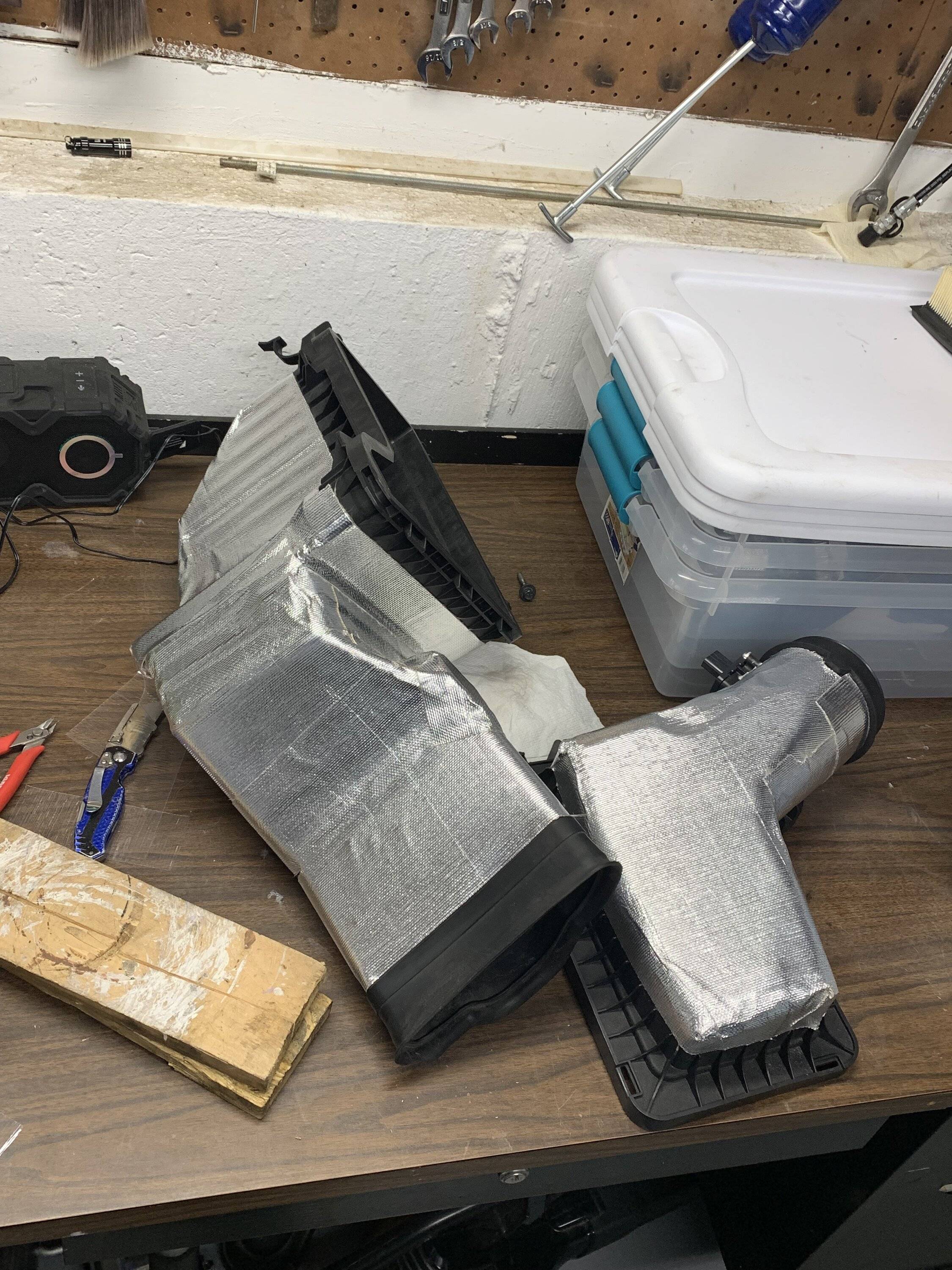

It seems like no matter what intake temps are 130F after one run sitting in grid, even if they are 90F and the end of the run. The outcome is that I have low power and a flat throttle for the first ~10 seconds of the run.
Having the hood open and spraying the intake does not solve or even really improve the situation. I suspect the exhaust and engine are nuking the airbox with radiation.
$100 in heat shield later I have this piece of artwork. Will report next week if this actually does anything.

My guess is that the heat barrier will make a difference. I use that stuff all over my RX7 (entire intake system, floor boards, trans tunnel, etc.) to manage exhaust heat and it works great. Also noticed the wide spread use of that stuff and the gold reflective material on the factory Boss 302s at an IMSA race. Report back!
