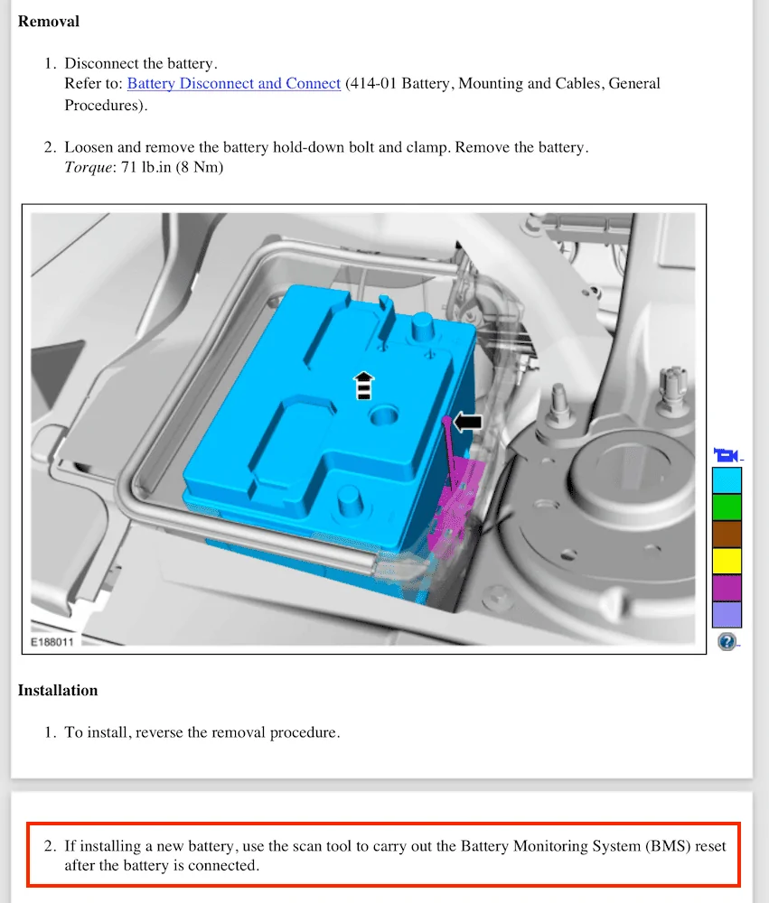

The BMS also knows the age of the battery and takes it into consideration when choosing the charging strategy. The age counter must be reset when you install a new battery, otherwise the BMS will treat your new battery as if it were old and will charge it accordingly.
I know of instances where some systems (particularly the stop&start, but also the heated steering wheel, or heated windscreen if fitted) had stopped working due to the load shedding caused by a weak battery, and they continued not to work after having the battery replaced. A BMS reset fixed that.
Here's the battery replacement procedure from the service manual.
It doesn't say it's optional. It doesn't say that simply leaving the car parked overnight will do.
