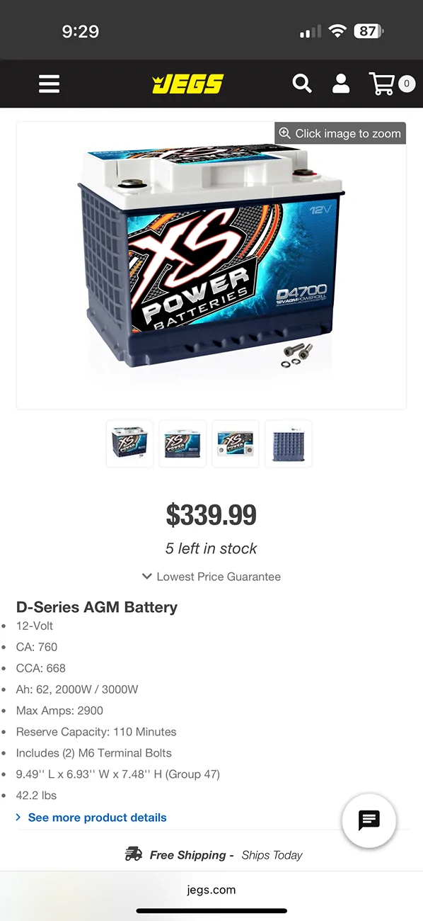

I have this :
I also have that battery. It fits but if I install the cover it contacts the hood and pushes it up enough for me to notice.
