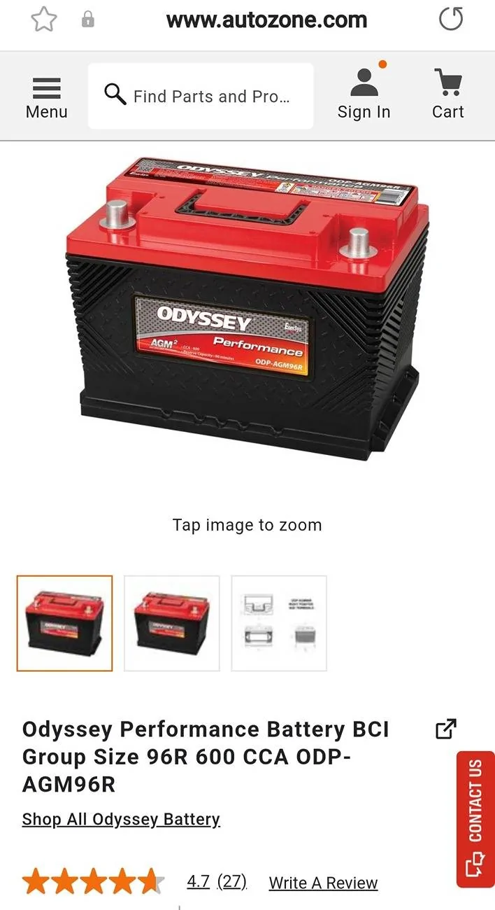

It would be wonderful if you could post a link to a 96R AGM battery with 700CCA. I, and I'm sure many others, would be all over that.
Best I could find is one that claims 600 CCA
This is the one I have, its a beast.

I bought this as well, to clear the air it is rated @ 600 CCA, 700 CA. Car is always on a battery tender and is a weekend cruiser (if that). Also, fit perfect in the stock tray w/cover.
We'll see how long it holds up, the stock battery lasted about 4-1/2 years, died of old age I guess :).

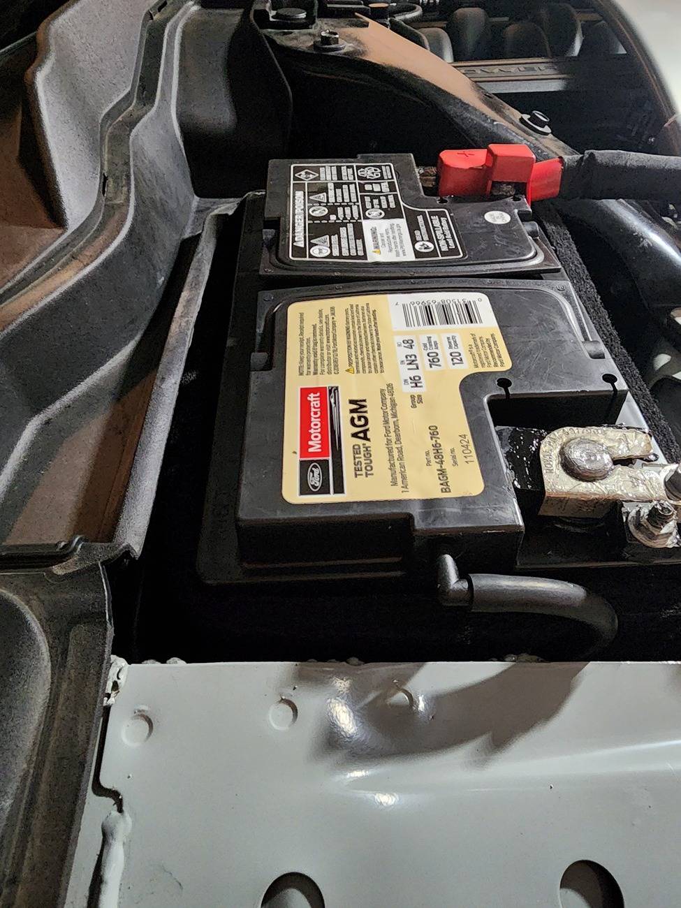

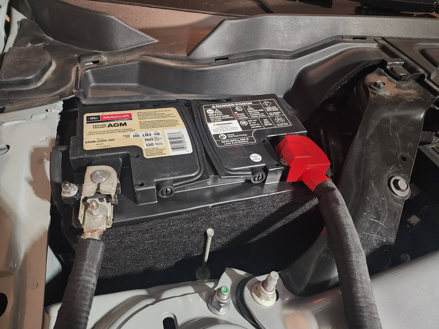

I’ll be attempting this swap over the next few days. I have the S650’s tray, just need to figure out exactly how to mount it to my S550. Battery is an XS Power D4800.
Op, any shot you have photos of mods to the box or of the spacers you made?

You also threw this in an S550? How’d it go? I’m doing the install as I type this out. I had to slightly trim the tubes at the bottom of the S650 tray but I can now get it in. I’m going to enlarge the mounting holes and reevaluate.
Dropped right in
