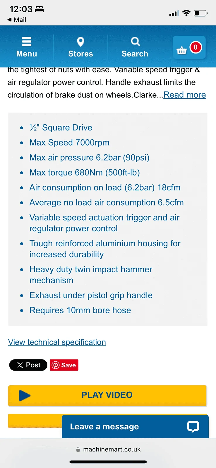

No, only the impact wrench used at some of the tire dealers. If they set it at 120 wouldn’t that be putting 120 lbs of force on the nut?

So an air compressor with 150 lbs max could actually torque much higher just by changing the colored extension stick?
Torque does not come out of a compressor, pressure does.

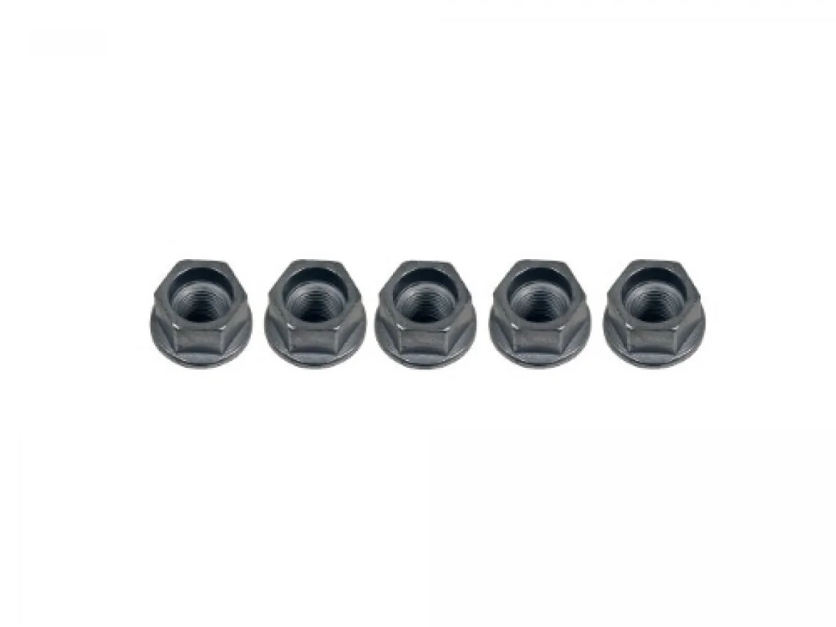

these are great lug nuts for street and track. they are strong and no nonsense.
a must for extended studs to accommodate wheel spacers.
  • Kit contains 5 Lug Nuts
  • Fits new M14 x 1.5 wheel stud
  • Included with Ford Performance Parts Front Wheel Hub Kit with Extended ARP Studs M-1104-AB
  • Included with Ford Performance Parts Rear Wheel Hub Kit with Extended ARP Studs M-1104-B
  • Can be used with Ford Performance Parts ARP wheel stud kit M-1012-N
