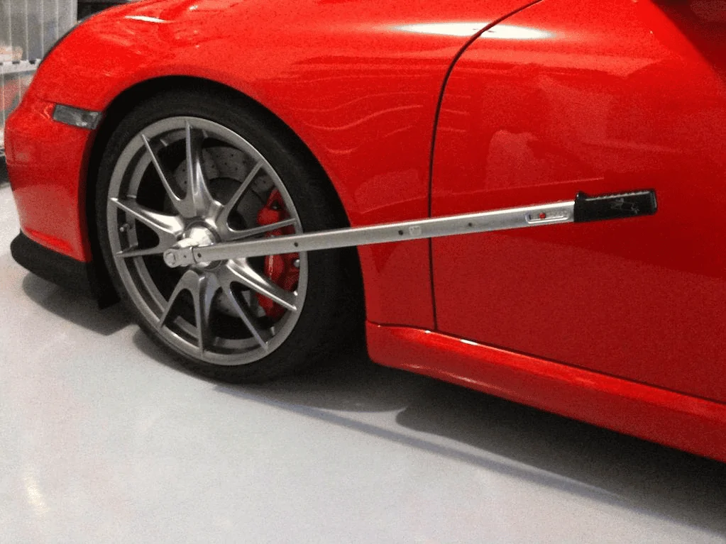

Another interesting comparison would be the center lock/nut type wheels on some Porsche and other high end sports cars. Those get torqued to over 400 ft-lbs. You have a single giant nut doing all the work of providing the clamping force between wheel and hub. Now, since these are also aluminum alloy wheels, should we only torque them to 100 ft-lbs? Oh thats right, the wheel has nothing to do with anything.

Honestly, I wouldn’t be comfortable driving any car that had the wheels held on with only one nut even at 400 ft lbs. Where would you even get a wrench capable of 400 lbs?
Ask NASCAR drivers if they’re comfortable with a single lug holding their wheels on flying around Daytona or Talladega. The NextGen cars moved to a single center lug. If they trust them, I wouldn’t be concerned.
