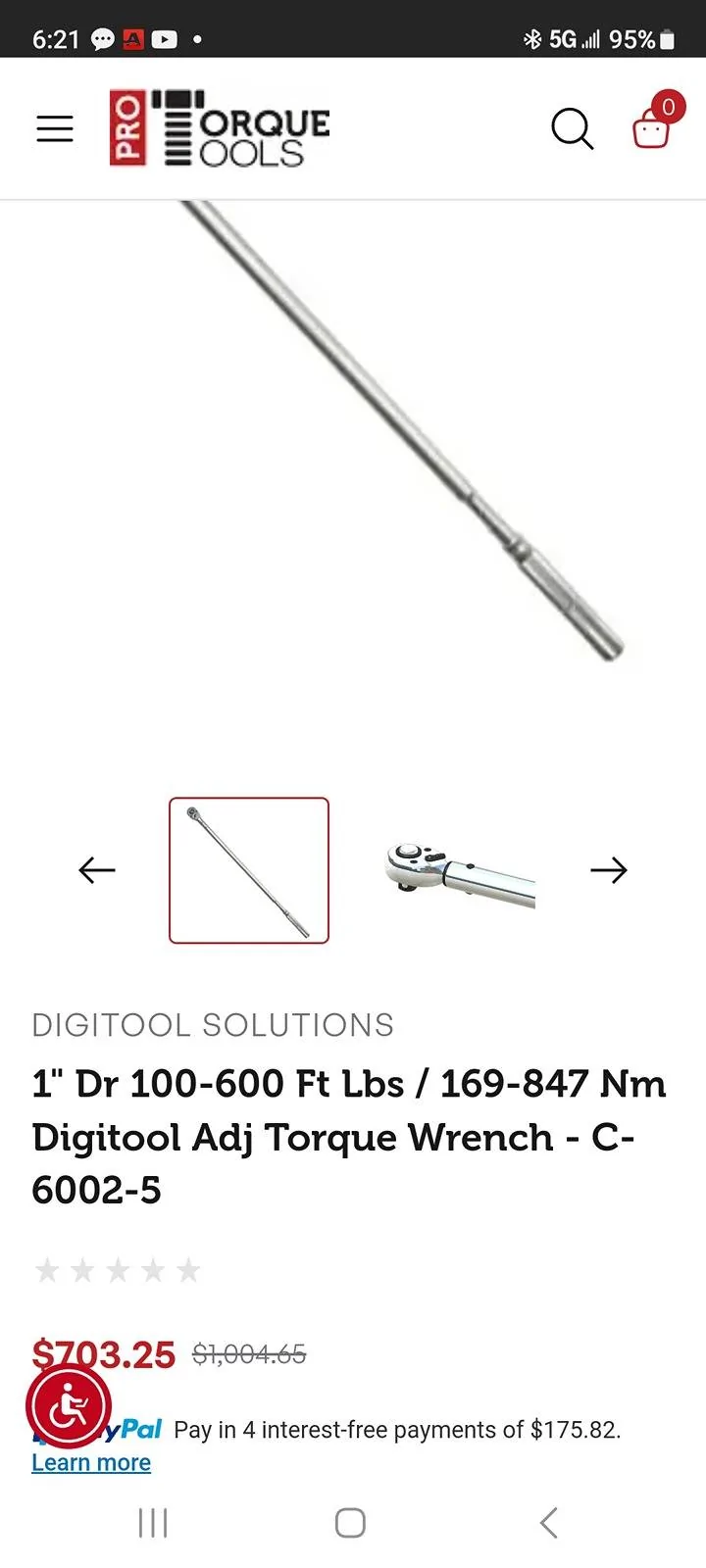

Honestly, I wouldn’t be comfortable driving any car that had the wheels held on with only one nut even at 400 ft lbs. Where would you even get a wrench capable of 400 lbs?
NASCAR switched to a center lug 3 years ago. If there's going to be an issue I'd think it would be there.

Several exotics use them already and have for a while. ORRadTech posted a 1” 600 ft-lb torque wrench. It’s all about leverage when torquing that high. Look at how long the handle is on that sucker. It’s quite the large handle for that very reason
