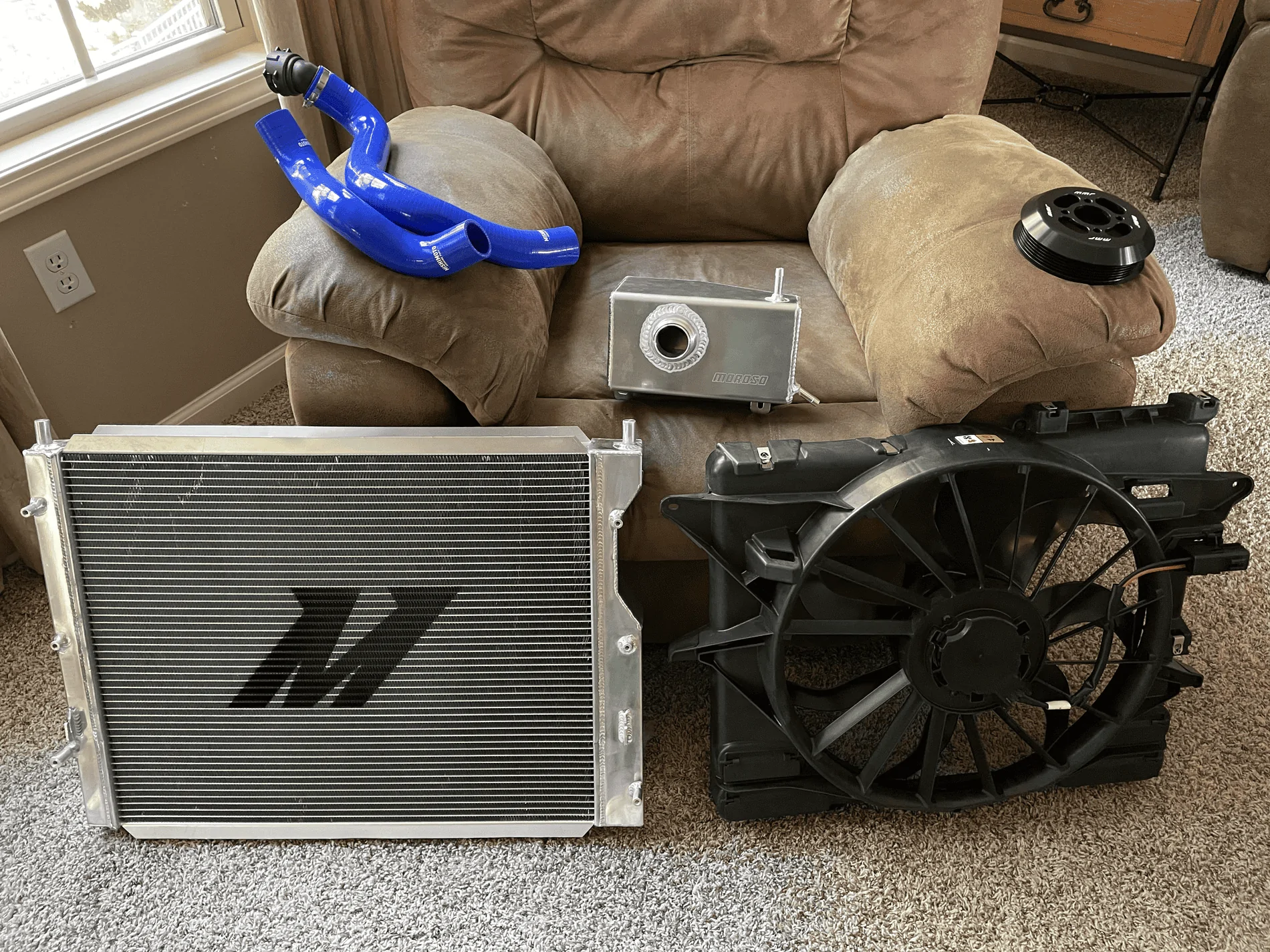

So, here's what a good radiator does for you! Just sharing a good story you guys will appreciate while we're on the topic.
@Tomster ...I am upgrading this mod from tasteful to full on functional. Caveat; I acknowledge the results or "need" for our cars may be different, but still impressive. So, without further adieu...
Earlier in the thread. you guys know I got the Mishi radiator for my sons S197 car. Back story on the car -- Gen I coyote putting 421 to the wheels. Bone stock cooling system. Car runs a fairly rock solid coolant temp of 194-198 all the time; hot weather, in traffic, etc. That's admirable. Can even say zero concerns there. Even call that ideal! May see an occasional 200-202 on the nGauge every now and then when it's really hot, but get some air going and back down to ~195 it goes.
That's where that good bit ends. One, maybe two WOT pulls on a freeway ramp or back road and the temp is rapidly up in the 200's. You can absolutely forget an epic day in the mountains up hill, much less even dream about a track day. Too much playing around will net you 210+ temps and climbing (and climbing very quickly). It cools down quick when you get out of it, but spurts of fun are short lived. Still no huge big deal and no dangerous temps.
Now enter the gorgeous Mishimoto radiator. Stock water pump and thermostat still. Now, in traffic this week, 98 blazin hot humid midwest day, the coolant temp is running slam down against the thermostat at 180. Normal driving regardless of outside conditions, in traffic, you name it, it will not climb above 185. We can't even get it touch 190. Not much time to play around with anything major, but a few back road pulls just to test the install and short curvy road screaming in second gear the whole time netted something around 188 (was the hottest we saw) with no indication of climbing much higher. And you can read between the lines what that would net on an epic uphill mountain road all day.

I just put the mishi in my 350 for preventative with the whipple install. I thoutht the out of the box quality is outstanding.

@stanglife Jeff...yeah man, I don't think that's the case any longer. This radiator inside and out is gorgeous. you can tell. I get what you're saying though; heck, I was shocked with this thread to hear the people bagging on Fluidyne. When we started down this path for the car, Fluidyne was my top choice. Thus this left me confused. So I started doing homework. The feedback I found out there on Mishi radiator was stellar, and my received product has lived up to that. Utterly perfect fitment, gorgeous welds, ancillary attachments all in the right place, everything works. And I posted the results. IMO would Fluidyne been the same result? Most likely. But I'd say things have changed from your experiences.
