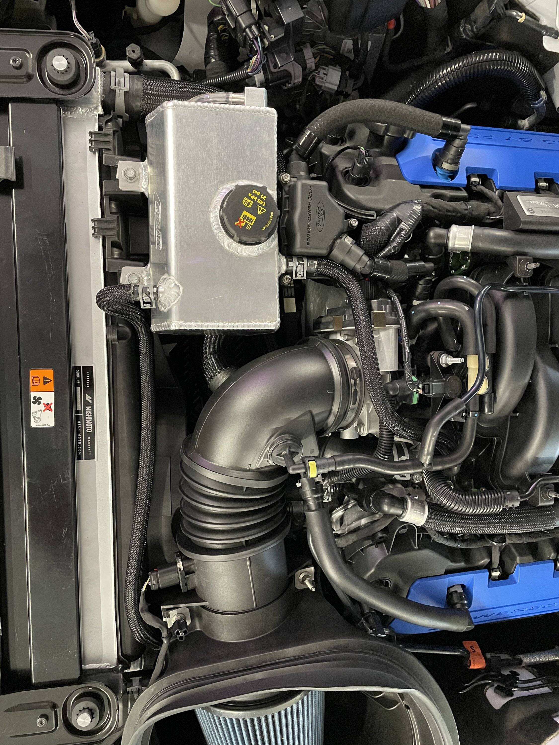

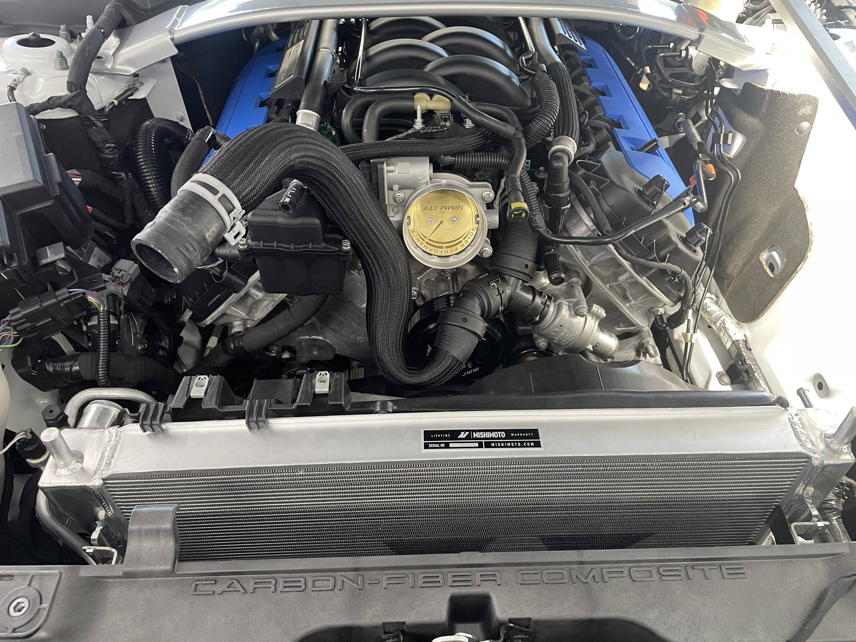

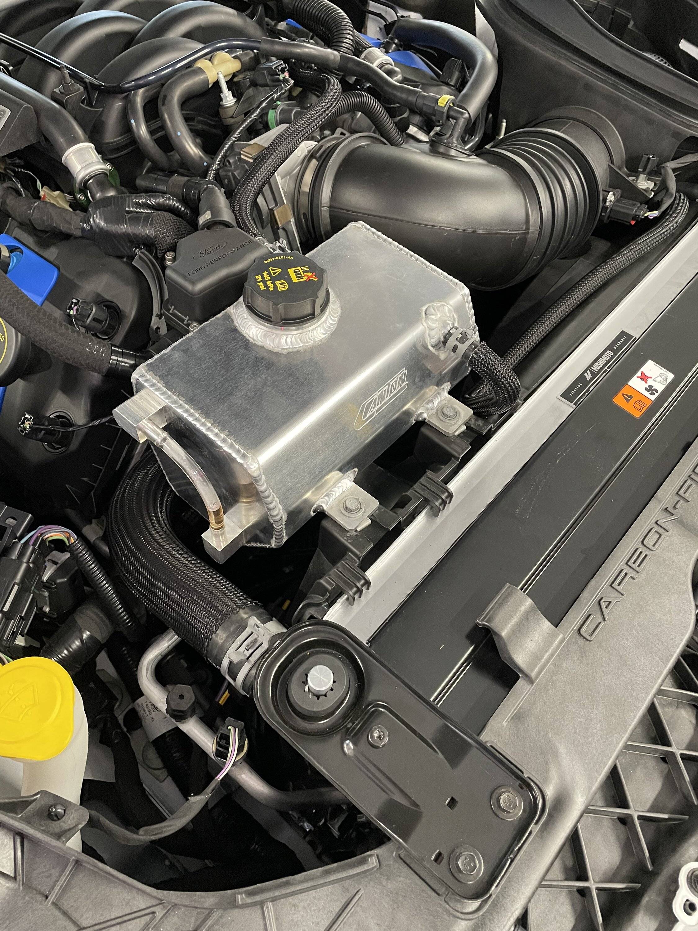

I don’t think it is an issue. It’s just a cool
Mod. BUT…after putting it in my S197, I noticed two thing right away; much more stable, easier maintained temps at the lower end (it doesn’t run any cooler, but it sure stays there a lot easier, if that makes sense), and noticeably decreased under hood temps in general. Will those repeat on this thing?? We bout to find out.
Reducing underhood temps is also a bonus. I seem to be having the starting issues when underhood temps are baking.

Zero change. But…I’d really like to have a coolant temp gauge and done a before and after on that.
The one thing I did notice was this however; when it warms up to the fan kick-on temp (seems like around 219°cht), my fan never turn on high. It only seems to turn on low, and once on, the temps drop like a rock.

I have a base GT that I initially replaced the tiny stock unit with a Mishimoto until it developed a leak less than a year in. Thankfully I was able to get it replaced under warranty pretty easily, but ended up selling it and going with a stock PP/GT350 rad.
I say that because I noticed 0 difference in temps between the two on the street and track (20 minute sessions). If anything I think the 350 rad actually works a little bit better.
If you're looking for better heat control on track, look for a way to 1) box in the radiator and 2) vent the hot air out through some sort of hood vent or louvers. This will make the biggest impact on your temps.
