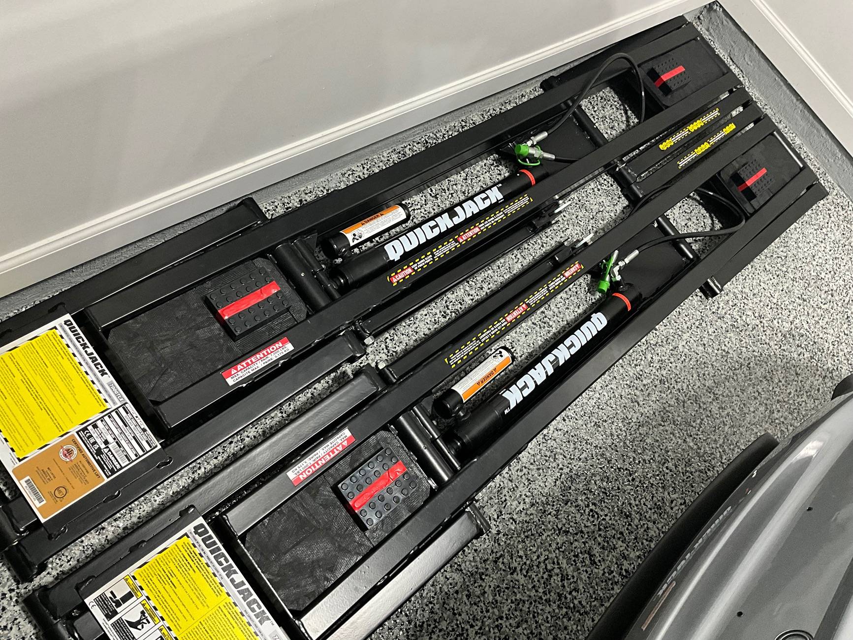

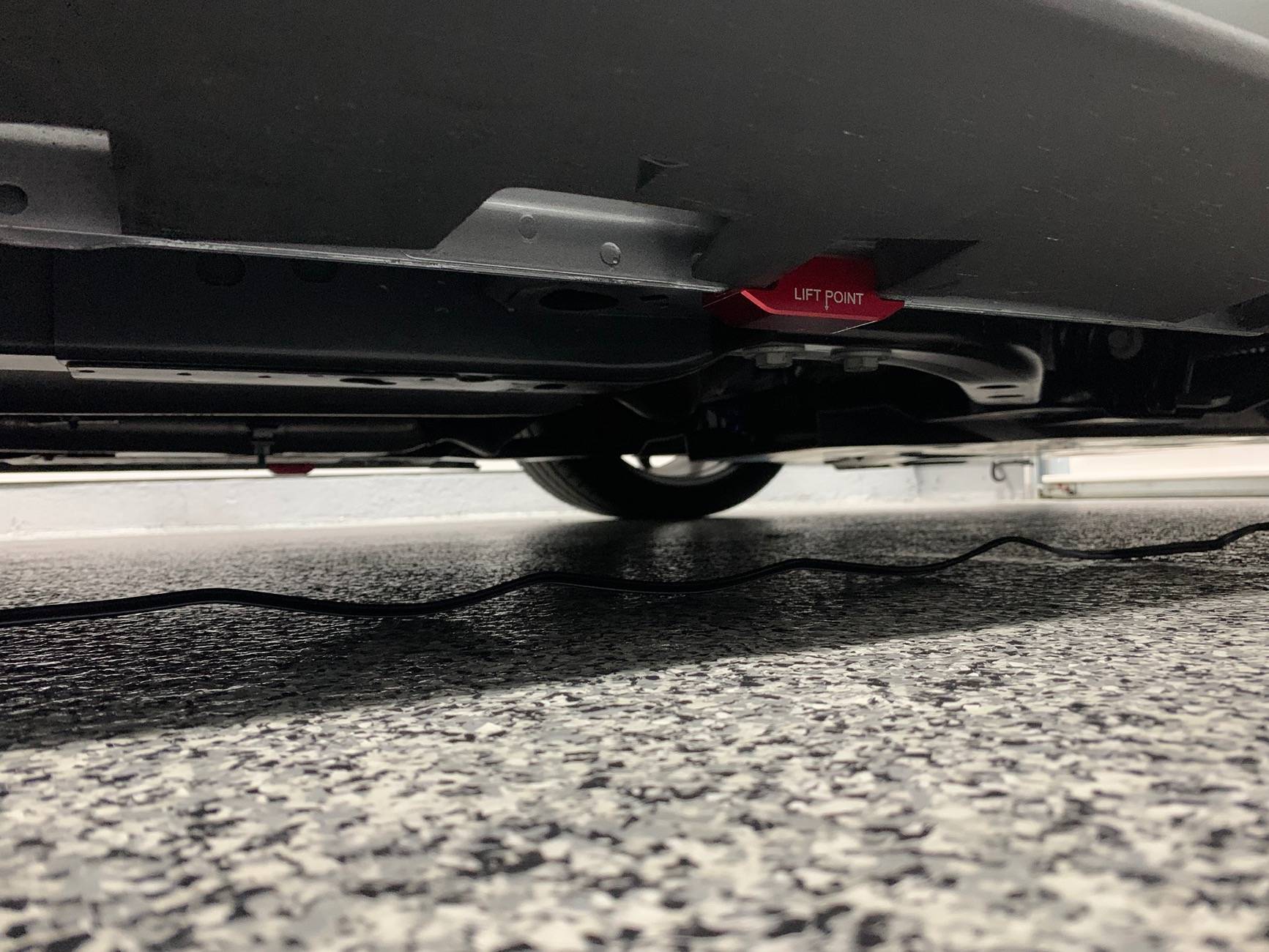

All great advice mentioned above on set-up and use, not sure I can add anything there. I did buy the zl1 addons pinch weld lift pads and set up my QJ pads so there wasn’t any guess work where the jacks went. Also some people have added a roller ball bearing so the jacks roll easy on the floor, plenty of YT videos on that. I have an epoxy type flooring so I added vinyl strips to the bottom of mine so I could slide them around

What you see in my QJ picture are the QJ pads, the zl1 lift pads attach to the pinch welds on the car at the lifting points seen in this picture. I bought mine directly from zl1 addons
EDIT: mine may not be at the exact suggested lifting points recommended by FORD

Nice, I have been wanting these but I have the Steeda Jacking rails. Would this make it easier I wonder. The jacking rails sometimes makes it a little more difficult to place the pads correctly.
