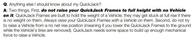

Can't tell if you're at full height, but for what it's worth, the manual specifically says not to raise the jacks to full height when unloaded....

We had 5 people standing on them, about 1000 pounds then I took the picture when they jumped off. Was checking for leaks at the time. Wasn't putting a car under them without a test. It says to make sure they come up at the same time. Made sure that happened too. All is good, used them over a dozen times now. Got more fleet maintenance this weekend.

One mistake I made during installation is I raised the jacks under no weight. Please do dont this lol. Also buy like 3 bottles of Transmission fluid.

Yep, I had two people stand on the stand just to get them to lower. And yes, always clean the ends of the couplers prior to connecting them.

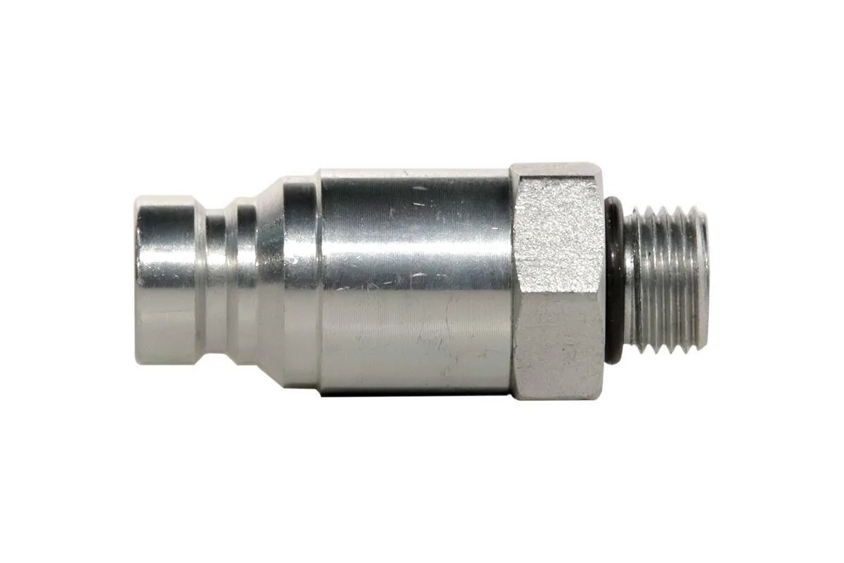

I had the same thing happen. The couplers are very cheaply made (chinesium). apparently you are suppose to use them if you need to or not. Its usually the couplers on the power unit that fail. They want a million dollars for the the Quick Jack OEMS. I bought 2 pairs of enerpak couplers for the price of a single fitting.
The cylinders fail, namely the air cylinder that slows down the decent

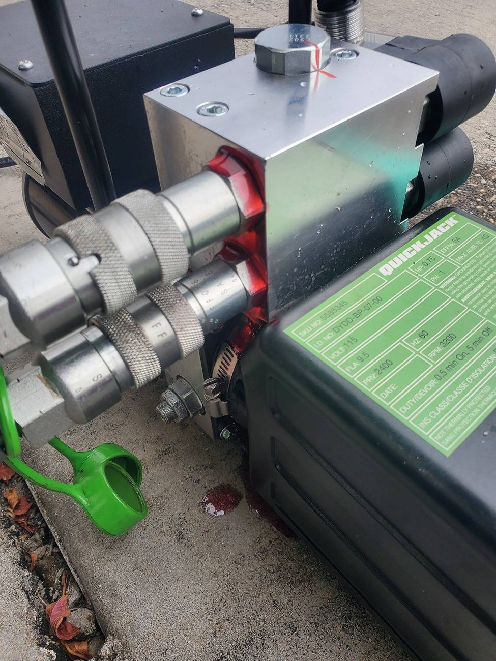

Waa using my quickjack while doing track prep on my other car and this started happening.
It oozes out from the screws whenever I raise it. I think the power unit is failing lol
Everything else works fine. Its just the power unit that will just ooze out the fluid whenever I go up with it. It will ooze out and then stop

what I mean by use them, they want you to use the Jacks at least once every 3 months
