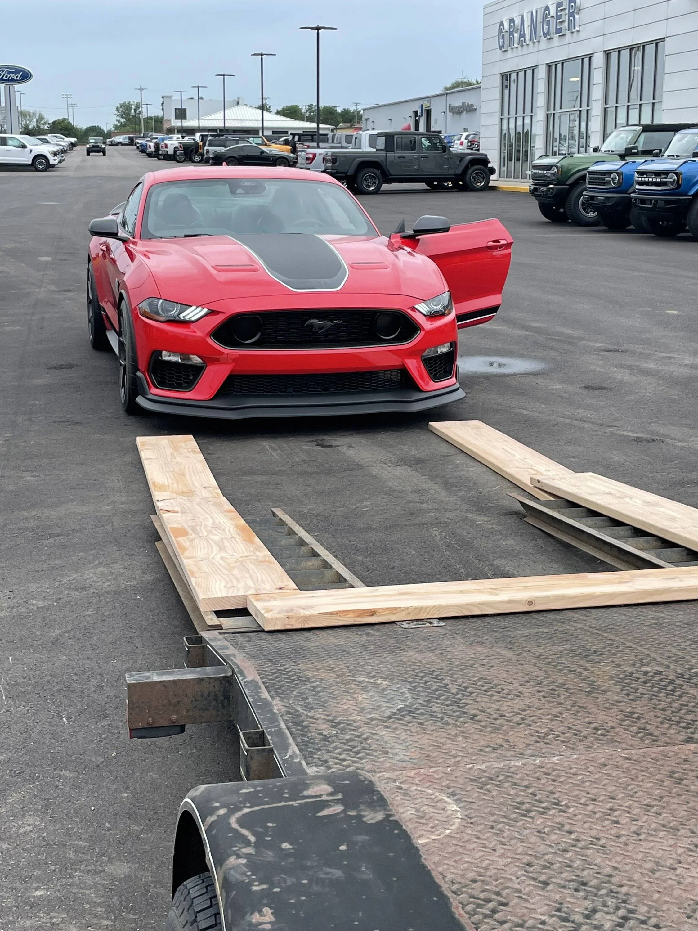

Need the clearance height and distance from front tires for trailer ramp angle. Have to know if I need to make some ramp extensions right now.

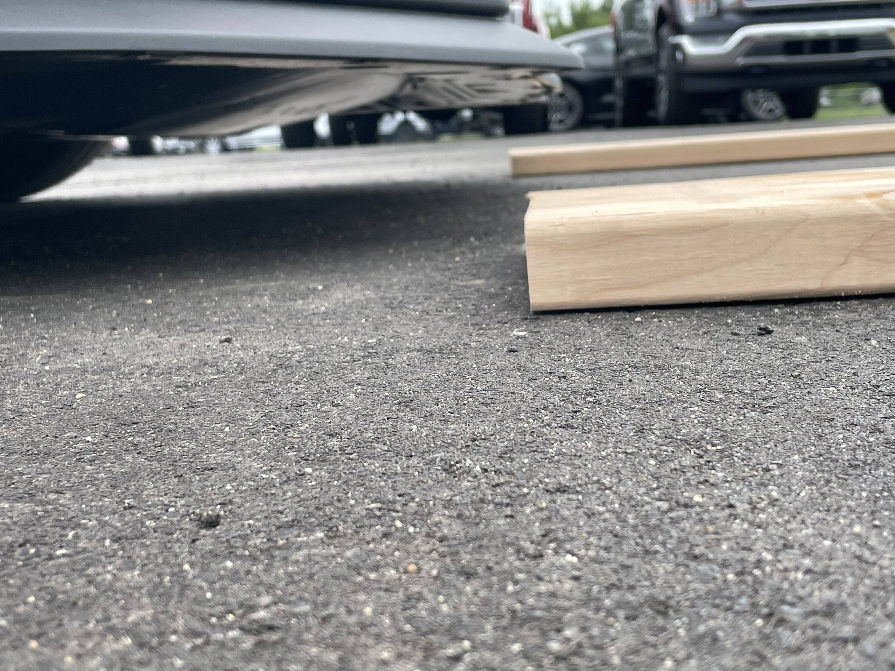

HP lower splitter sits at 5 & 5/16ā€

I think I wanna say in the owners supplement/manual it states to use nothing more than an 11 degree ramp I believe. The 5" clearance sounds right as well, believe it is a hair more but not much.

My splitter is about 3.5 feet from the ground hanging on the shop wall. I removed it the first day . It was just under 5 in. from the road. The problem it is so far forward of the front wheels.

Wish they were in right now. We’re off to Menards to buy wood to make ramps

For reference, my ground clearance is right at 4.5ā€ and splitter is 36ā€ ahead of front tire. Had to rig a ramp

Looks like you got things sorted. Nice ride. Happy for you. Great color. :like:
When things settle down, the Mach 1 supplement, Page 32 and 33, offers detailed diagrams.
Grades no higher than 7% are recommended.
Not a lot of room. I'm surprised I have not scraped mine yet.
Safe travels.
