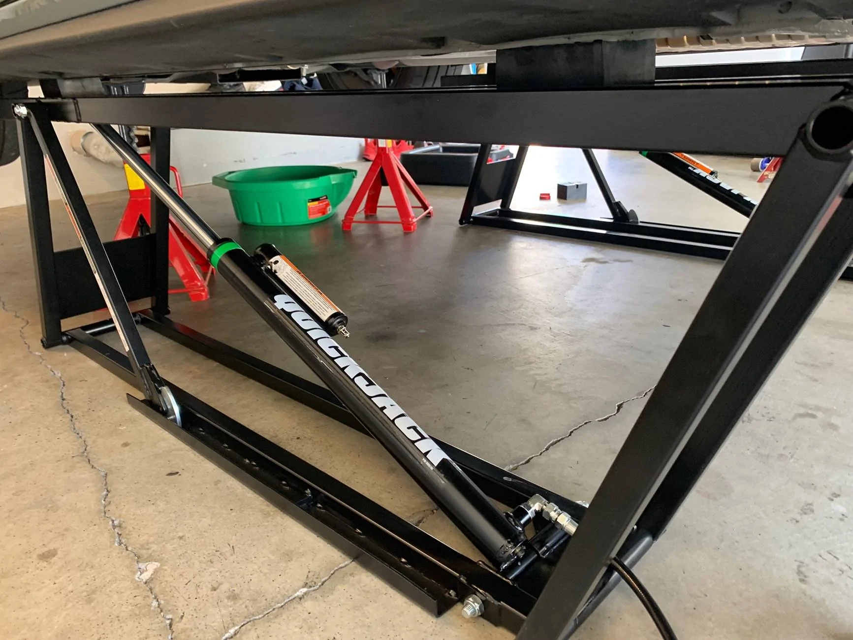

If you have an issue with clearance or find it's tight, you can always park your car on rubber mats. I also use jack stands for extra "insurance" if I'm going to be working under the car.
Yeah I place jack stands but the Quickjack is very safe. Doesn't hurt to be extra safe, just in case there is an earthquake or who knows.

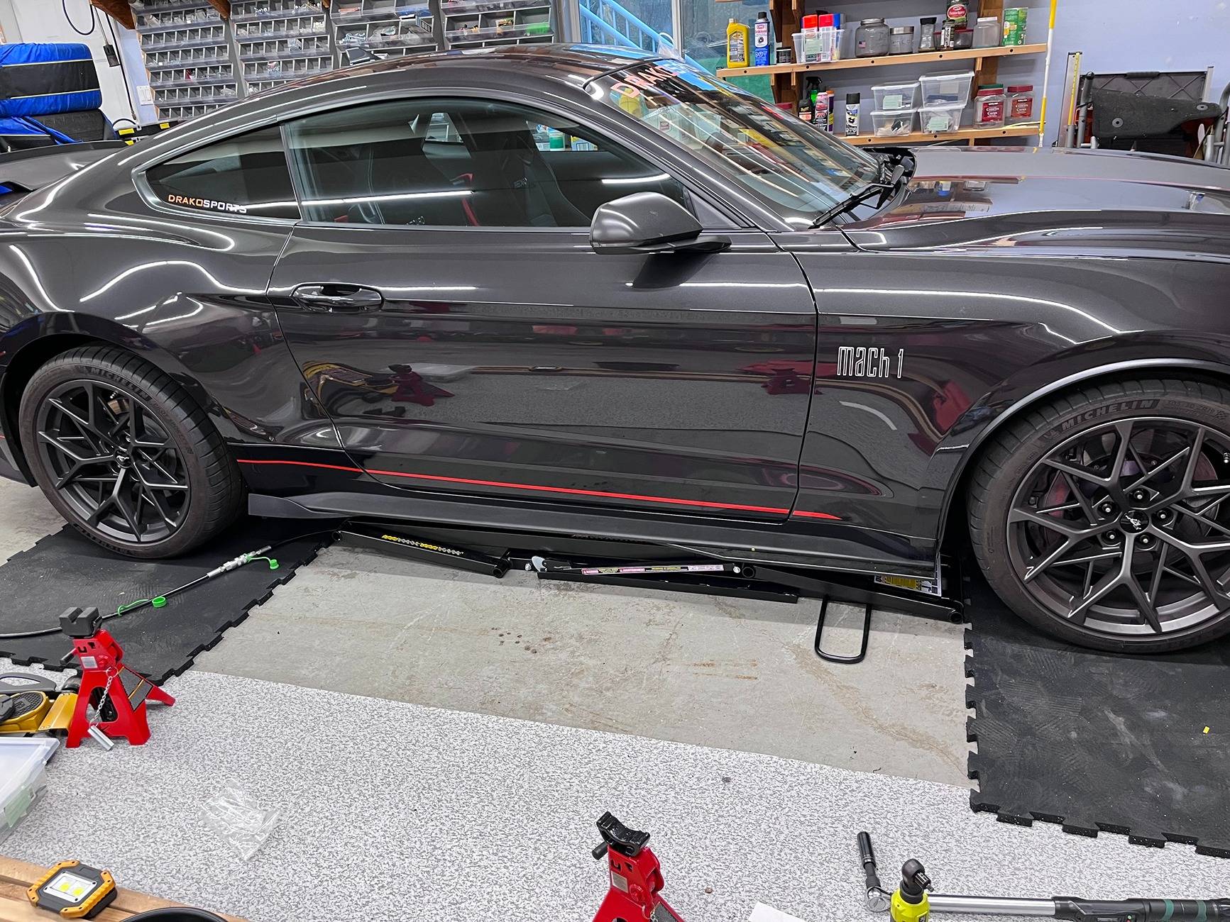

Here is my method.
I also added the roller balls under the frames. It was tricky to find the perfect locations for them. Too far up the angled frame and the lift still drags on the floor. Too low on the frame could cause clearance issues when positioning under your car.
May want to remove my jacking rails too, I feel it would make it way easier.

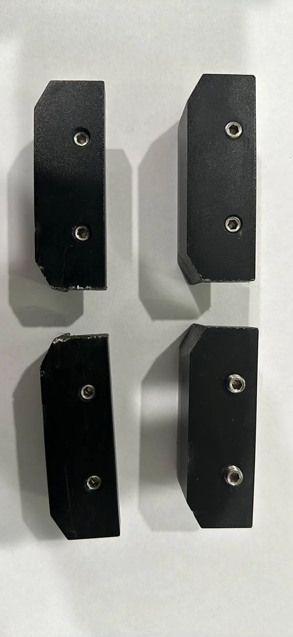

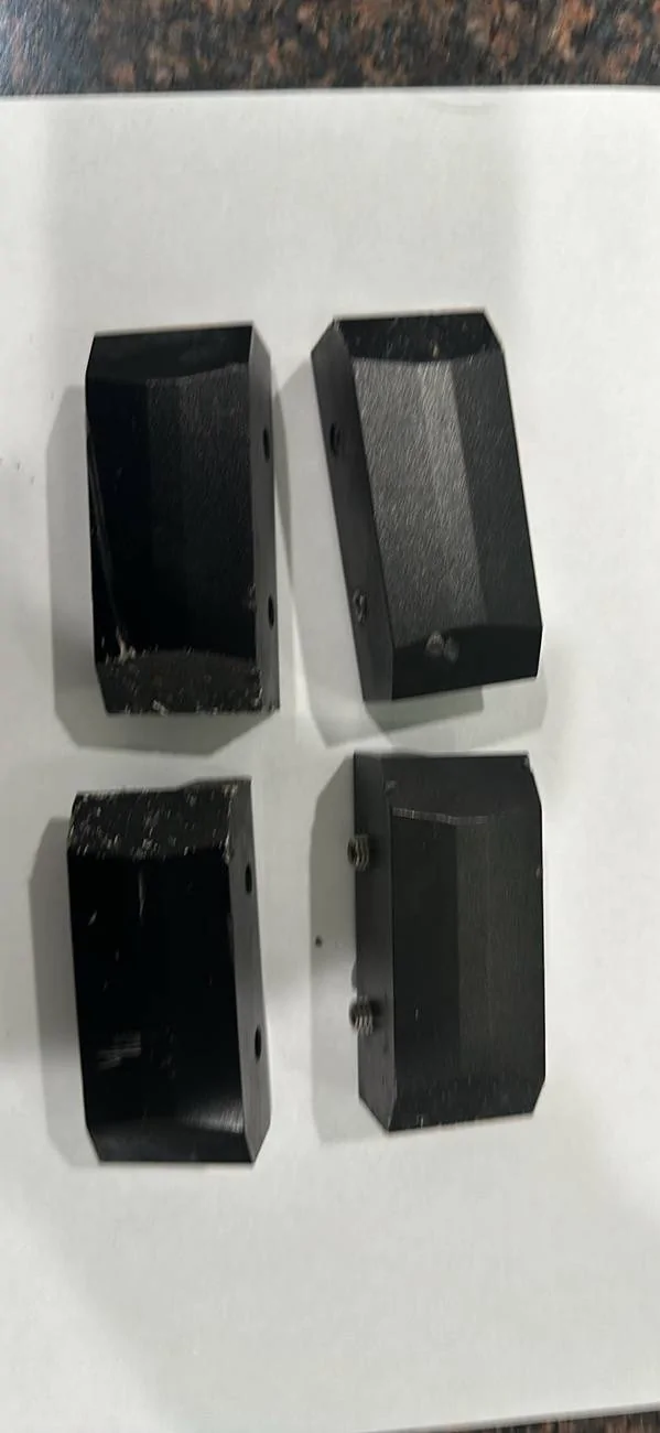

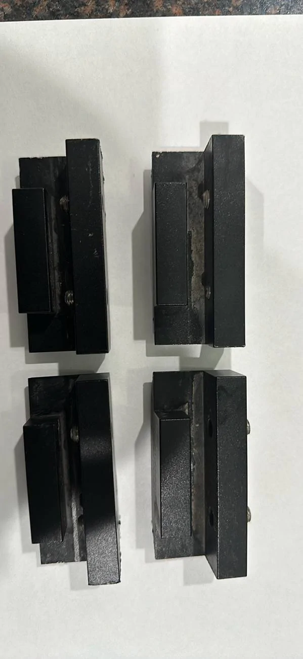

If anyone needs a set of the ZL1 Addons jacking pads, I just took a set off my GT350 after I installed Steeda jacking rails. They're black and have some minor scratches on them. $50 - buyer pays shipping.

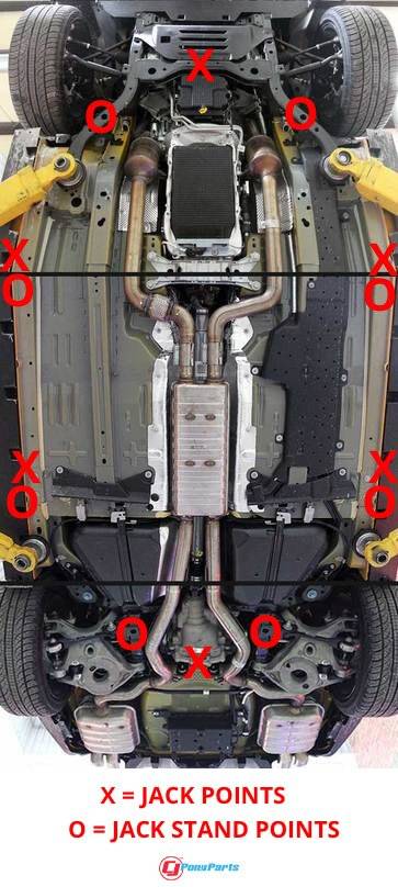

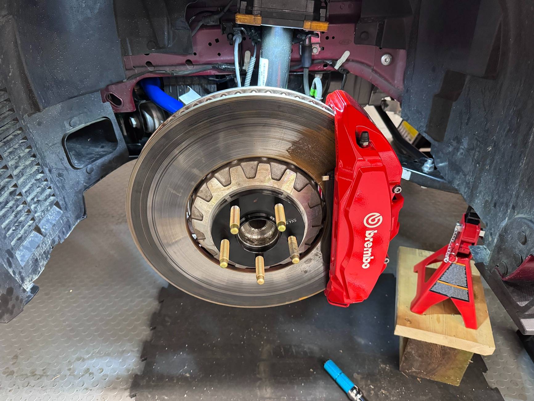

Potentially stupid question, but where are you placing your jack stands for extra "insurance"? And what jack stands go that high?

Nah not stupid. If I go to the 1st level (click) jack stands extend ok. If I go to the maximum height of 2 ft, I put the stands on blocks. There are jack stand points for the car.

I have these jacks stands under that go really high up. They are called US Jack. High quality made in USA.
