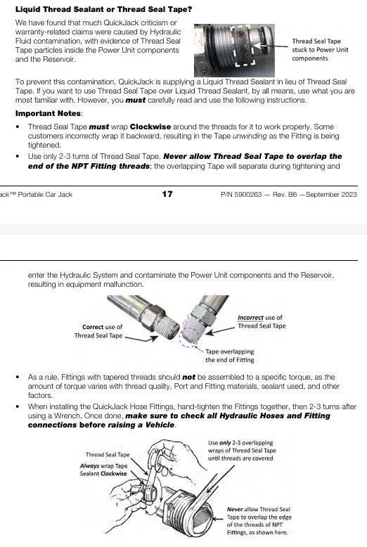

If this is the connection, looks like there should be an o-ring, also.
I cannot remember what I used on the coupling threads but here is Quik Jack Instructions
Wow where did you find this? This is exactly what I will be needing. Thanks
I've been working so I haven't had time to dig around their website but I did call them and they sent out the couplers I believe. Their warranty service guy didn't sound like he knew anything. Im going to try to get another whole power unit lol
I actually asked him specifically if I would need some kind of thread sealant or a type of plumbers tape like the ones used on the couplers for the hoses and he said no

I'm not going to lie but, if I seen a O-Ring seal on a coupling I wouldn't put teflon on it. BUT, If it said to I would. I will down load the PDF and attach for you.
What exact model did you buy?

If it's just a threaded connection with no flared surface you either need tape/paste or an o-ring depending on the type of connection.
Hmm yeah thats a tough call. It doesn't seem like that use either teflon or a sealant so anything is better. Its weird that they suggest using it for the hose couplers but not the ones for the power unit
I bought the 5000TLX and thanks again
