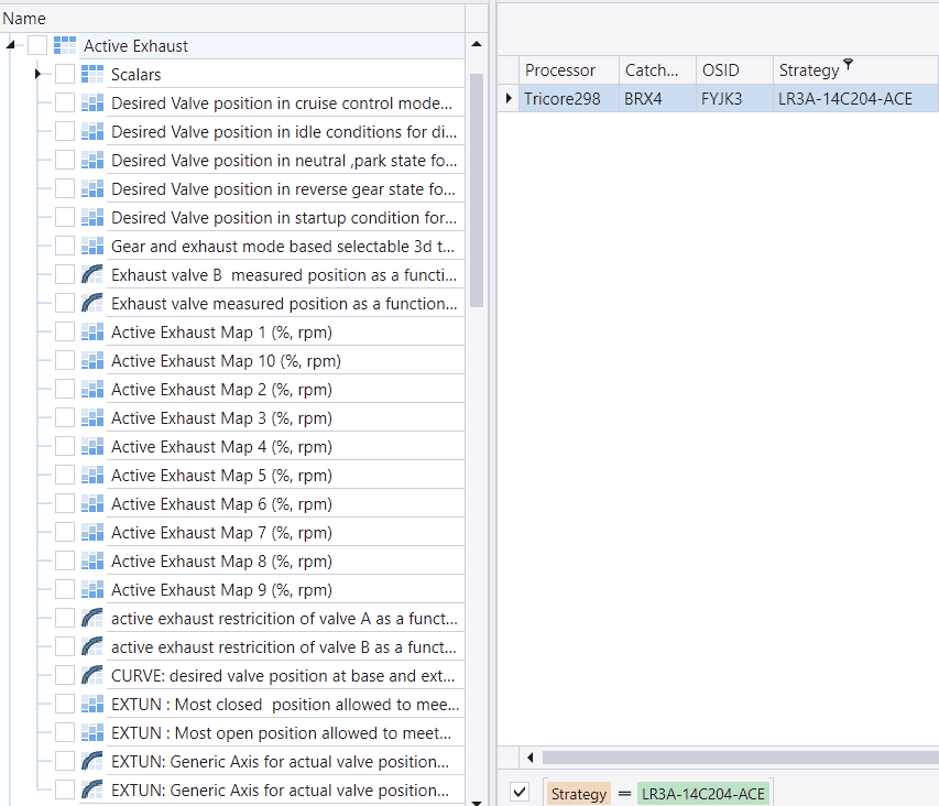

Can't say for sure if the controls work, but PCMTec has the strategy in their library and the Active Exhaust parameters are defined:

I have an issue with HPtuners and the active exhaust configuration. The tables don't seem to be taken into consideration. No matter what changes I do to them, the valves seem to work the same. While I can't be completely sure of this, I suspect it's because my car is Euro-spec. It may be that in Euro vehicles the exhaust valves are controlled a bit differently. I also cannot monitor the commanded position of the valves - it always shows zero.
Can PCMtec help with that? Can it configure the active exhaust and, more importantly, can it do it with non-US Mustangs?
I had that issue with HPT on my US-spec car, they were no help and assured me it was something I did.
PCMtech worked, we have a different strategy, maybe it was the same issue though.

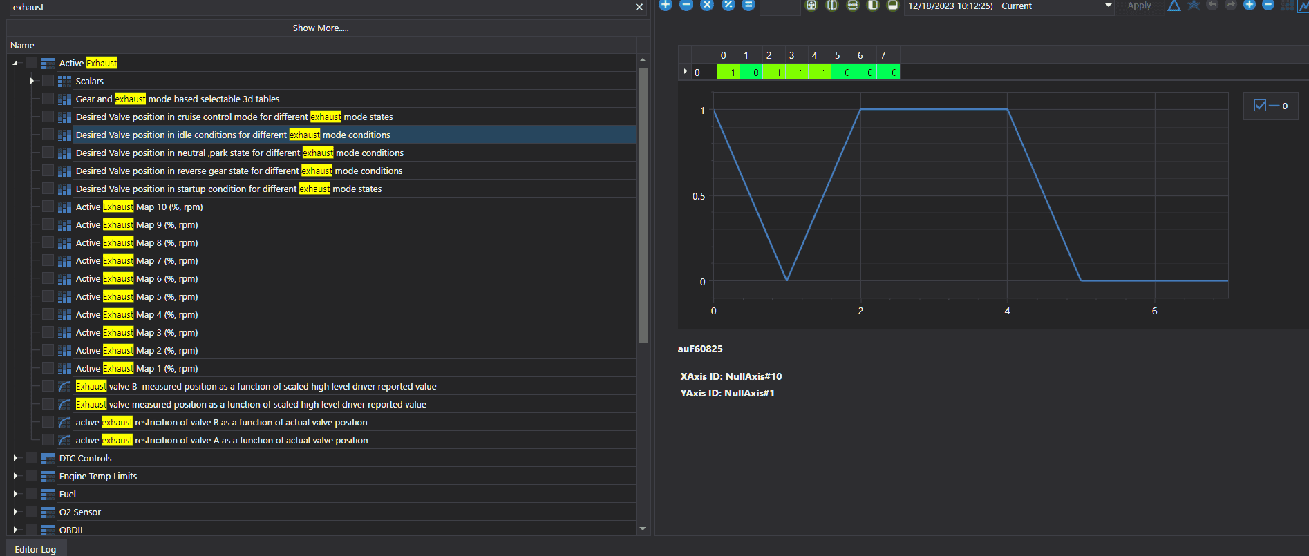

Thanks, Dan. So PCMtec can control the active exhaust. That's good news. Now, whether this also works with non-US Mustangs is anyone's guess. I was hoping that Rolls might chime in and confirm it.
My understanding is that PCMtec doesn't rely on a proprietary hardware interface, like HPtuners does, and that they only sell you the software and the licence to use it on your car. What kind of hardware interface would I need? Would an OBDLink EX work?
