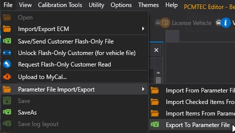

If you paid for a base file, you could ask for a copy of the multi-tune setup. That part is exportable and the other tuner can layer than on top of their own base tune.

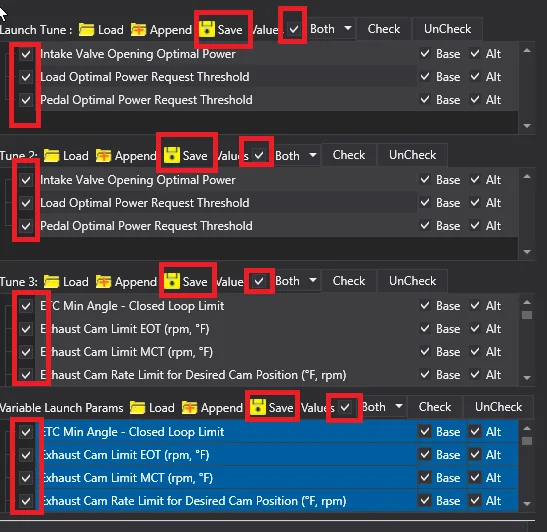

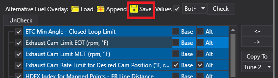

This info is really for your tuner but all they really need is a screenshot of this:

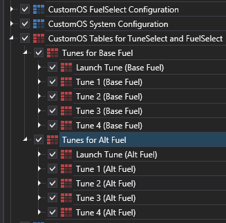

Ensure all the custom os items are selected by the previous tuner creating a file.
Export to a a parameter file.
They can then create a parameter file for each slot and export them.

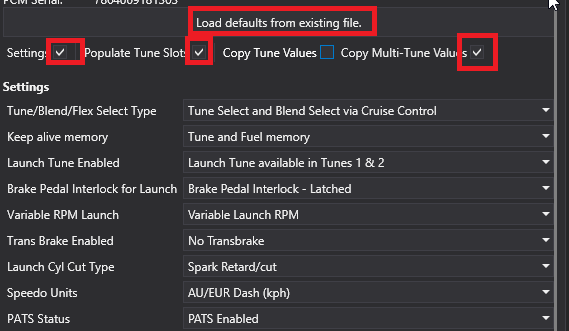

This is obviously a lot easier if the file is licensed/unlocked. In which case you simply use the following button which will pre-populate all the drop downs and load in the multi tune slots/values. but not the base tune.
