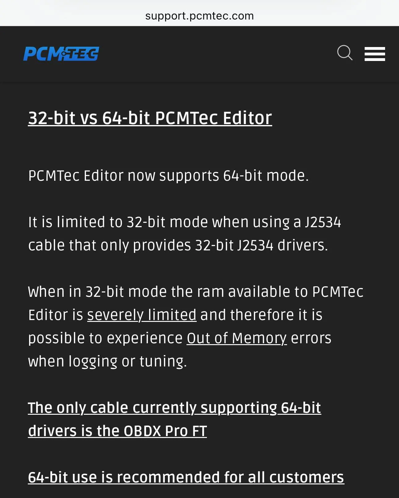

From their site:
This. The 64 bit version is MUCH faster and we highly recommend using it at all times. Even if you have a Tactrix you can do all your work in 64bit and revert to 32bitb for flashing via the options menu, however the OBDX cable is faster and also supports Bluetooth/wifi/elm327 for full diagnostic support with Forscan and other android/iphone based phone packages.
You can even flash GM cars via lsdroid on your phone using this cable.

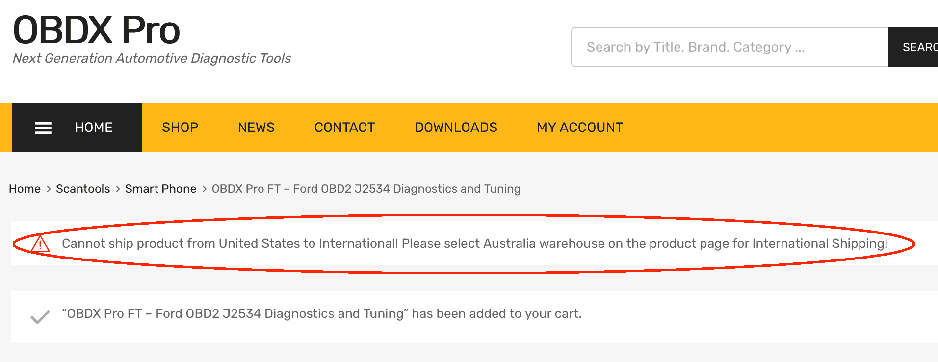

Buy it from the US direct. They have stock there a(afaik), shipping it from Australia would be slow and expensive over Christmas. Aus post is one of the worst postal services I have ever used. There was a rail disaster in WA a few weeks ago that basically cut off all postage from half the country (Australia is gigantic and takes 46 hours+ to drive from WA to QLD) meaning "express" from WA to Sydney took 3+ weeks instead of 2 days. Customs is also notoriously slow. Apparently Amazon stock the OBDX in their warehouses apparently meaning close to next day delivery. It is also manufactured in the US so buying from Aus would mean it was sent from the US to Perth (literally the other side of the globe) and back again.
Whilst we are not affiliated with OBDX and I do not know the full story if you contact us I would be happy to throw in a credit to cover your cost and delay.
It sounds as though you bought from the Australian distributor and not their US one someone. Or perhaps they didn't have stock in the US over Christmas.
I had to choose the Australian warehouse because they specifically state they don't ship internationally from US.
And I couldn't find it for sale anywhere, nor on Amazon, nor anywhere else, apart from their own website.
Do you happen to know of another source?
Ah you live in Europe. Europe is notoriously difficult to ship electronics to especially with the Ukraine situation, requires many extra stickers and tags. Germany is one of the worst and it likely would have had to go via Germany. You'd have to talk to OBDX, every company in the world is going to have similar issues shipping to Romania.
I know other companies who simply do not ship to eastern Europe full stop and recommend using dropshipping companies who specialise in this.
You'd need to talk to OBDX about this, or you could try buying a European cable instead, eg a UCDS (I believe they support J2534 and ship from Russia). There may be other suppliers within Europe who sell J2534 cables.
I know people in the UAE who have successfully purchased an OBDX.

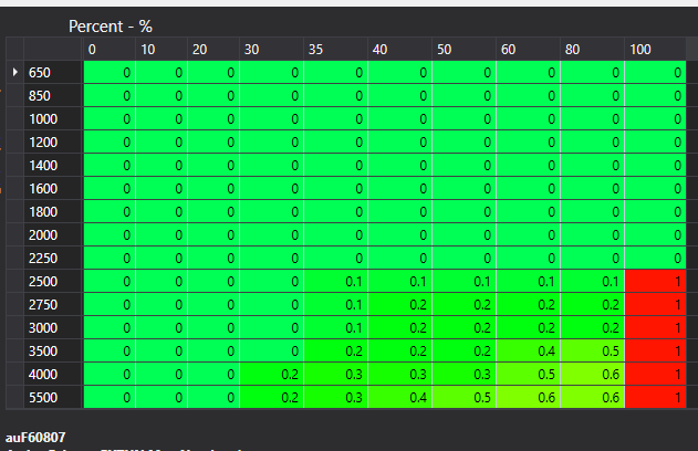

All of the active exhaust tables are defined in PCMTEC, and so are the idle defaults and software switches to completely disable/enabled it along with MIL codes if you have removed the system.
I set mine up so quiet mode is quiet and normal/sport/track are all full volume. Works great.
Would you mind telling me exactly how you did that?
I've installed the software and done a full read of the vehicle, and I'm now looking at the active exhaust section. My God, it's absolutely overwhelming! There are dozens of options, 98% of which I have no idea what they actually mean.
I can see the tables which I've modified in HPtuners (and which in my car seem to be ignored), plus a lot of other options which weren't present there. What I fail to see is where the selected exhaust mode comes in. And I don't know what things like "extun", "fmem", etc. mean.
What I want is quite simple:
1. Quiet mode stays as it is.
2. In all other modes the valves are open 100% all the time, including at idle, no matter what. At any temperature, in any season, any day of the week, any phase of the moon, you name it. Always 100%, no exceptions.
How do I do that?

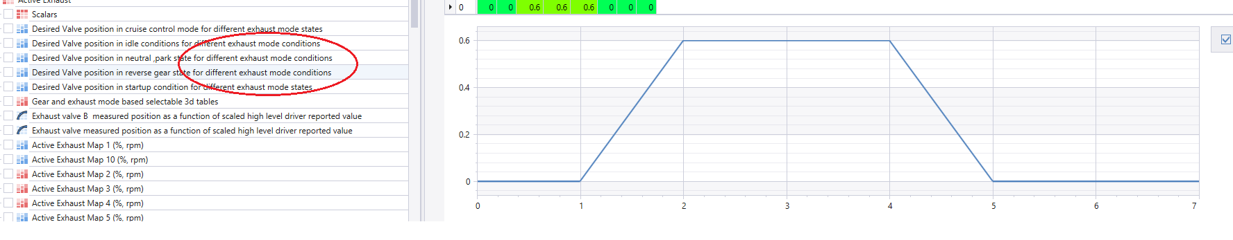

Actually, I think I see it, but I can't seem to figure out how it's supposed to work.
How should I read this? Do the numbers on the x-axis represent exaust modes? Like, say, 1 is Quiet, 2 is Normal, 3 is Sport, etc.?

Here you go, for an 18+ GT this will be in track mode at all times except when "quiet mode" is selected on the dash. This will mean on the street you will only meet noise regulations when in quiet mode.
1 is "quiet" mode. I set it to still open the valve at WOT and high RPM.
Map 2,3,4,5,6,7 set to 1.0 at all times
Map 8, 9 and 10 leave as stock (0) we are not sure if these are ever used, so we simply left them at their default of 0.0 at all times.
Mustang 18+ GT Active Exhaust - All modes fully open except for quiet mode. - Mustang HOWTO Guides - PCMTEC Forums
