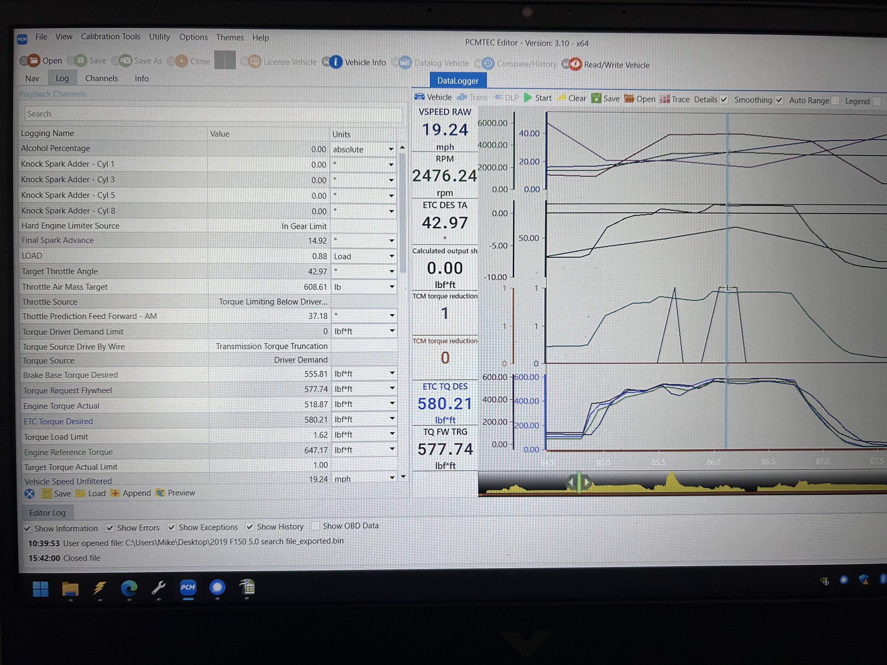

Just a shout out to pcmtec…often times in ford tuning you run into mystery throttle closure. Other software tools allow logging of parameters like ”torque source” and “throttle angle source” that can sometimes point you in the right direction to find the reason, but sometimes you get the dreaded “torque red. < driver demand” with no other clues. Well much like the editor, the pcmtec logger has a mind-blowing number of parameters available for logging. I began logging as many throttle and torque sources as I could find and happened onto “torque source drive by wire”, which immediately revealed “transmission torque truncation”. This parameter does not exist in other competing logging tools. The transmission torque truncation was set over 700 ftlb so I thought it was high enough but it wasn’t. Apparently the ford torque input calc accounts for torque converter multiplication. Anyway, after changing just a couple of numbers in the tune, the throttle opens and stays there.
