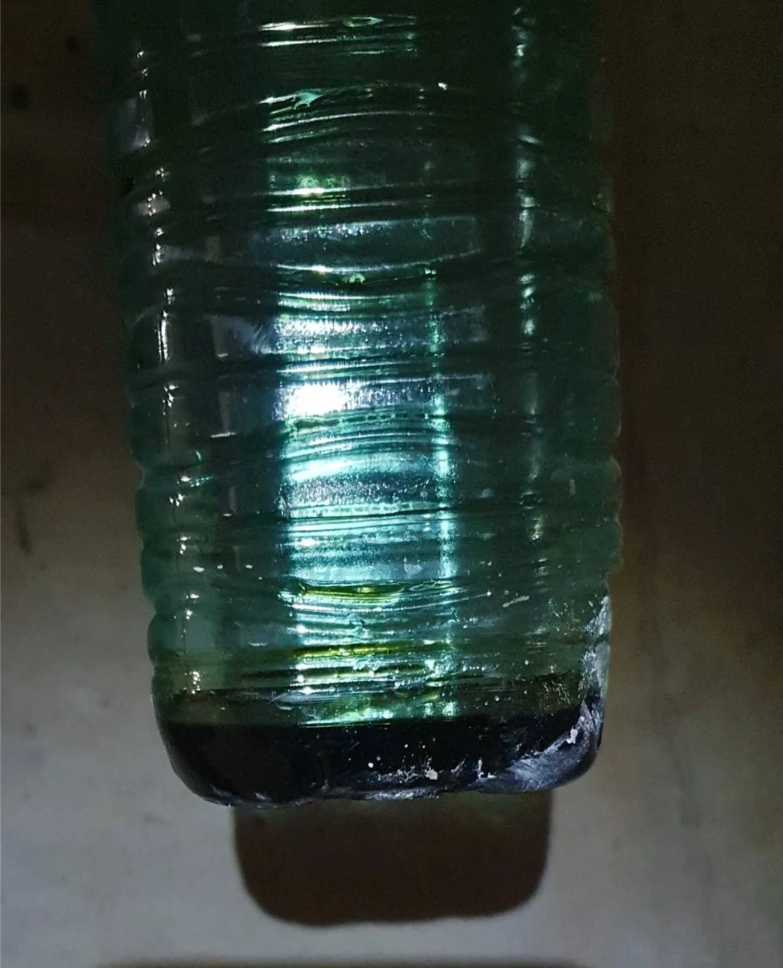

After 10 000KM (6200miles) on the passenger side without tracking with some spirited driving somewhere around 50-80ml was caught in the ford performance catch can. As far as I know, the driver side catch can shall be installed when focus is on tracking, but not on commute / daily driving. So it works, whether it's worth the money - debatable.

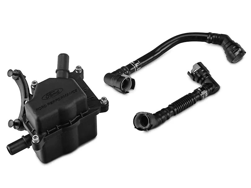

FWIW, I'm personally a fan of the Ford Performance Separators and not of anything aluminum or metal. Heres why. The composite in the FP models will not cause condensation. What does metal do, if you run in cold, heat it and cool it again at a low ambiet temperature? You get condensation, this then helps to fill up the catch can faster with some level of water and then boom it can suck into the intake.
If you don't live in a cold climate or drive your car in winter this probably doesn't matter, but something to be mindful of.
I don't think that's completely accurate though. While the can itself is composite, the filter screen that the air has to pass through is metal. I always thought the main reason the FP can doesn't collect a whole lot of fuel/water is because of its proximity to the engine. If it does collect any (which I would be very surprised if it doesn't), it will evaporate and be ingested in the engine, leaving the oil behind. Even metal cans like the J&L and UPR that mount in that spot will probably do the same thing. Remote mount cans are a different story, since they won't get as hot which allows them to do more separating, and collect more water condensation.
Also contributing to the FP catch can is it is as close to OEM as your going to get. It was designed by a close colleague of a personal friend that worked on the GT350R-C Race program. The design is good and its made by an aftermarket arm of a Major OEM. SOLD!
