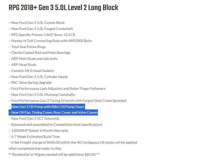

You're going to start way higher with price than $17k for a built block from RPG. Once you add oil pan, and doing all the ancillary stuff worth doing with the engine off, you are north of $17k.
That said, I'd opt for the long block. If it requires saving ng a bit longer, I'd do it. Get all the weak points worked out, and not have to touch other bits on the motor while it's in the car.

Their long blocks come with an oil pan, Valve covers, rear cover, timing cover. You just need the accessories like water pump, alternator, pulleys etc.
Yes. However I would suggest while you are in there, going to the GT500 oil pan. Which also means different OPG. And since going more robust, the GT500 starter, which handles heat better, then, since the motor is out, why not look at the clutch, and since it is out, why not headers, and since it is out, clutch line, and while it is out, CF driveshaft....you get what I am getting at...LOL at least that is what happened to me.
