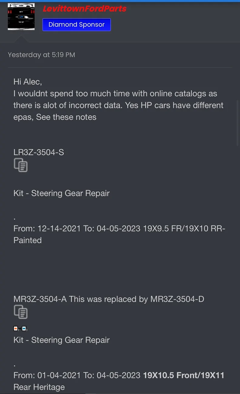

Would you mind sharing the HP EPAS part number?
Non-HP cars are equipped with PN: STE806 (LR3Z3504S)
HP cars are equipped with PN: STE836 (MR3Z3504D)

Check that out…

Check that out…
I saw this as well and wanted to believe they are interchangeable but I suppose that isn’t the case… I also checked with Ford Performance but don’t have a screenshot of that, he said they likely gave them a different ratio.

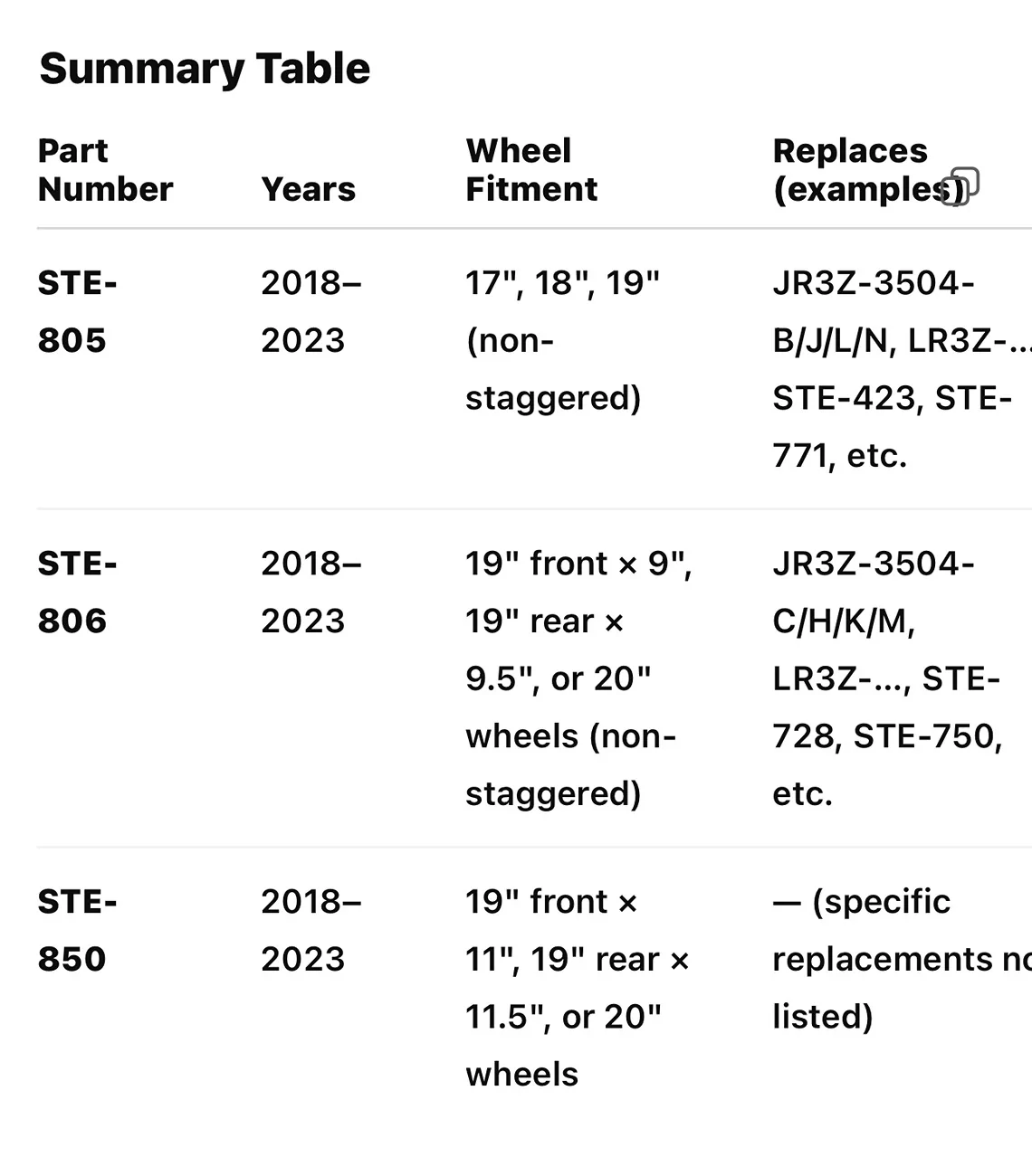

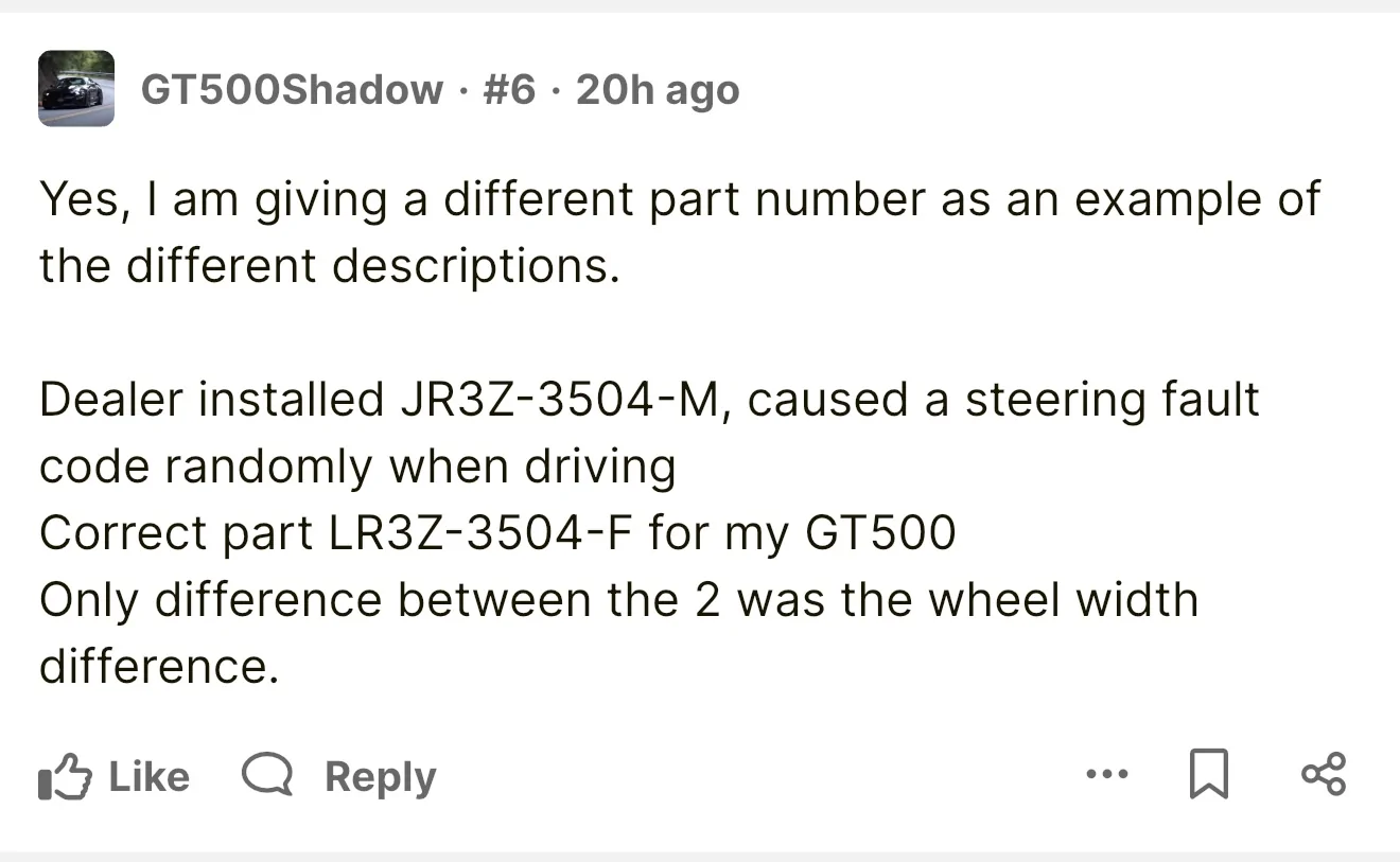

Draw your own conclusions.

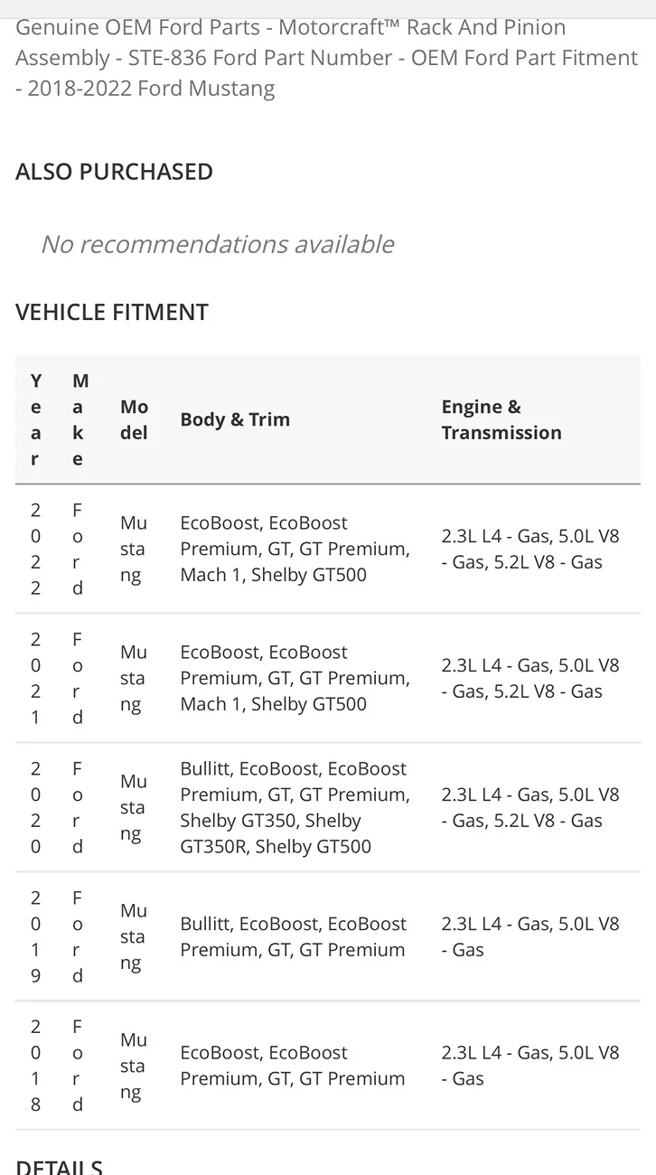

IPOGT
Feb 11, 2016
73
4,765
5,894
Alan
This is interesting.
For a 2023 Mustang, only STE-806 is applicable—STE-836 does not extend into 2023. Probably Covid part shortages.
