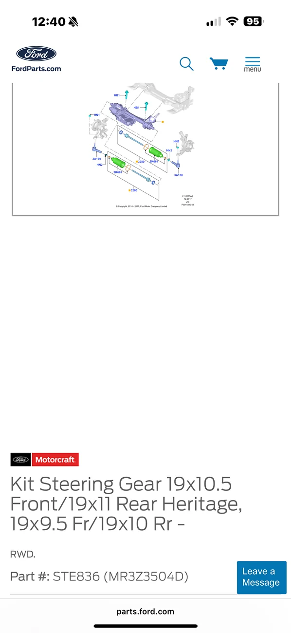

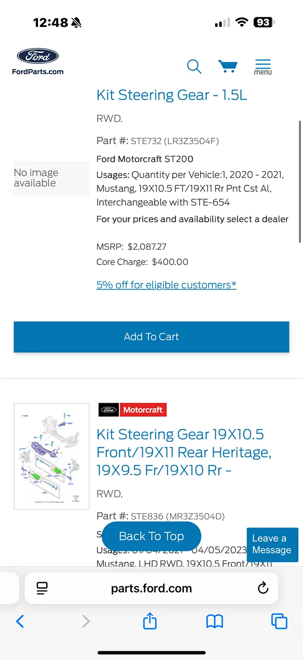

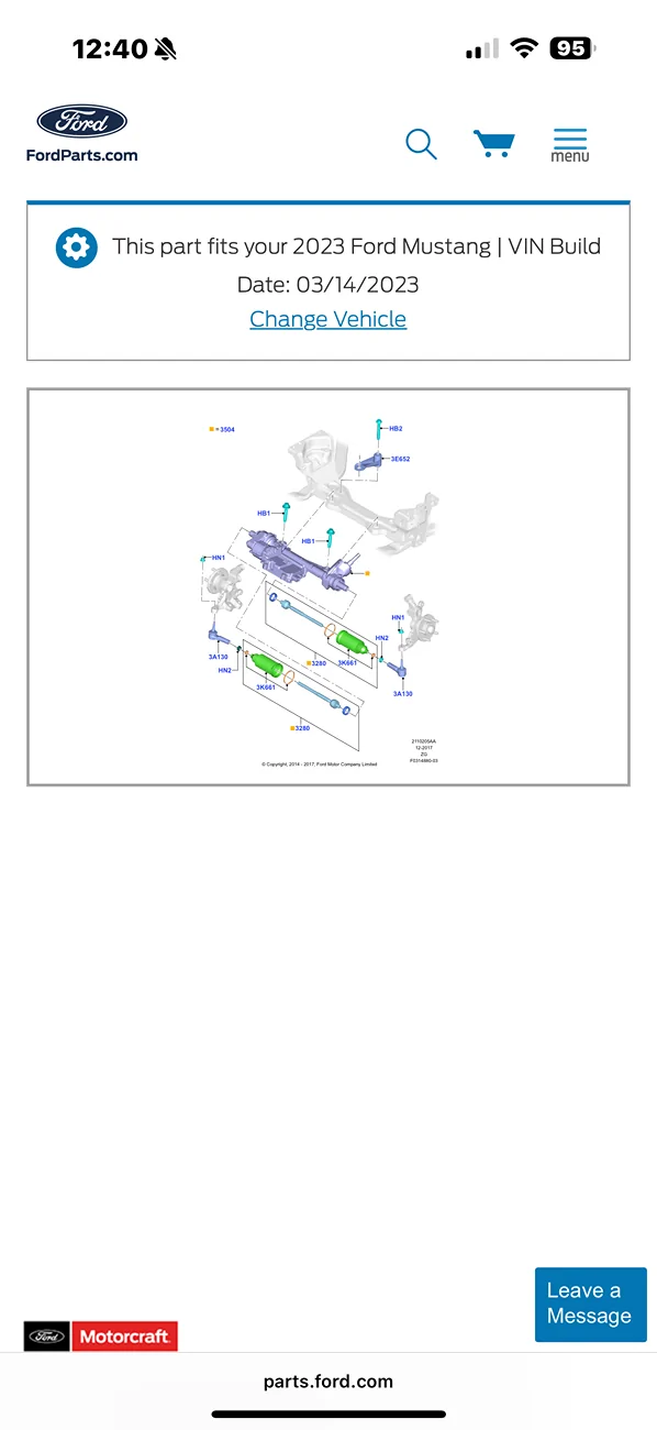

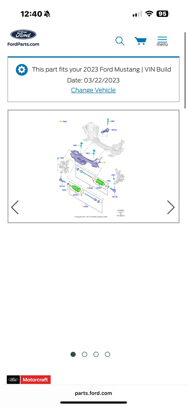

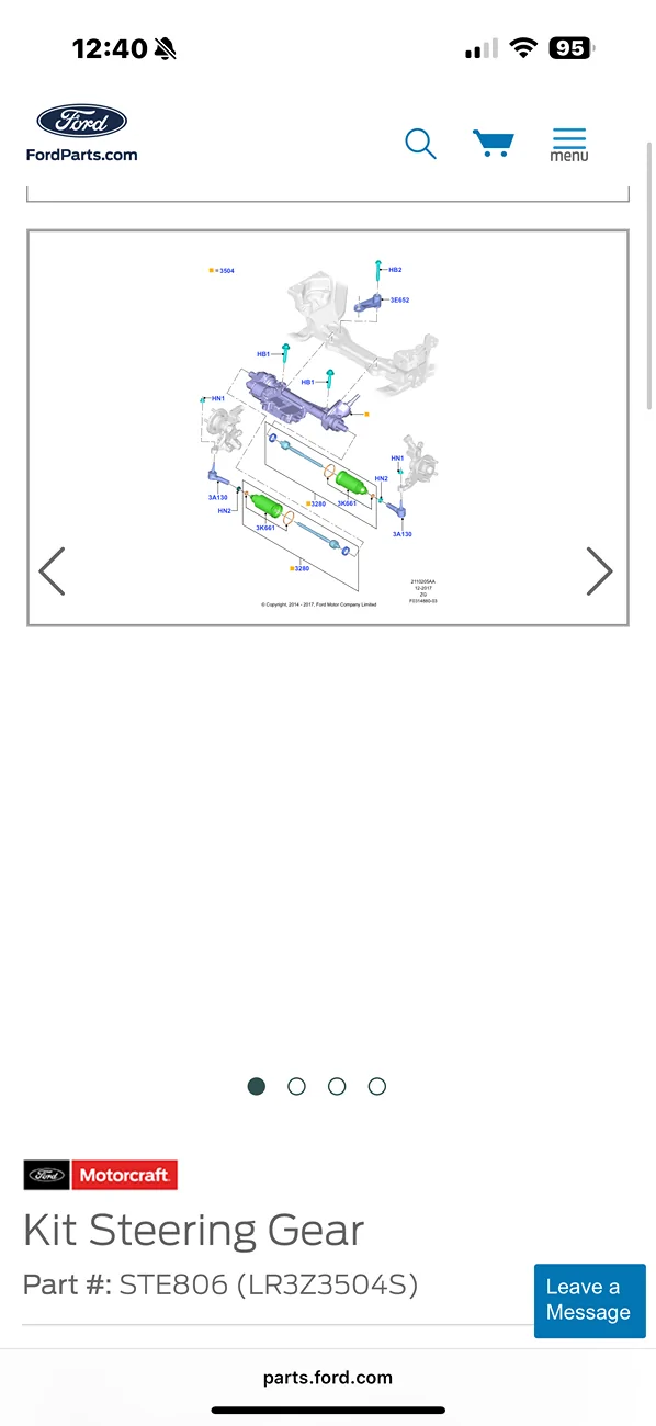

For a 2023 Mustang, only STE-806 is applicable—STE-836 does not extend into 2023. Probably Covid part shortages.
This is where I originally found the discrepancy on the official Ford Parts website. Ran my 2023 Vin and a 2023 HP Vin. Cars are identical otherwise.
My vin:
HP VIN:
If you attempt to look up the opposing part number under its opposing vin, it “does not fit”. I although did find it weird STE836 lists both wheel sizes. Though STE806 does not, and only lists non-HP size. In Levittown’s database it shows only the individual wheel sizes. In our GT500 friends example, apparently that causes issues if you use the wrong one.
