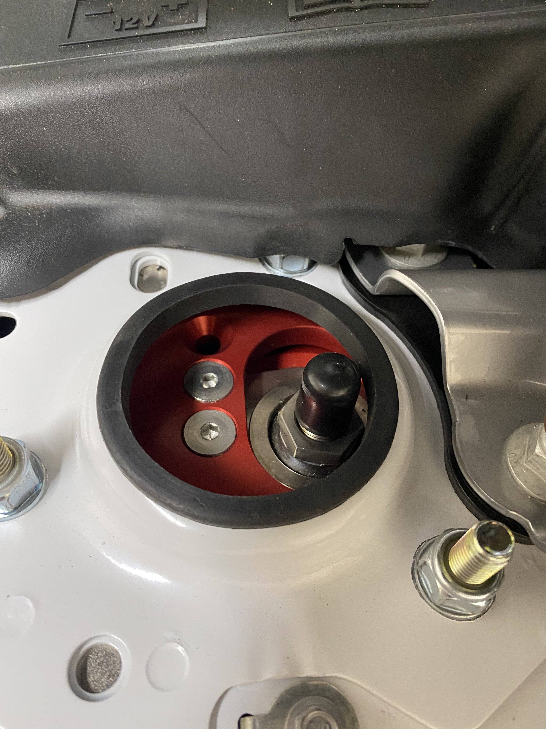

Fwiw (GT not mach juan), you kinda want a bit more than 3 degrees of camber to get the most out of the front tires if you’re tracking it. You can get close with some of the camber plates, and if you open up that strut tower hole (vorshlag sells a jig to do that surgery) you can get quite a lot more.
i’ll also say that some of the good tires also come in 315/30R19 (or 315/30R18) and if you buy slightly wider spacers and studs (OPMustang sells wider and longer parts) you can fit 315s square on the car with those same ET52 wheels.

Can confirm I opened up the strut mounts with that tool. Painted the cuts and finished with some o ring seals. Looks pretty factory imho.
