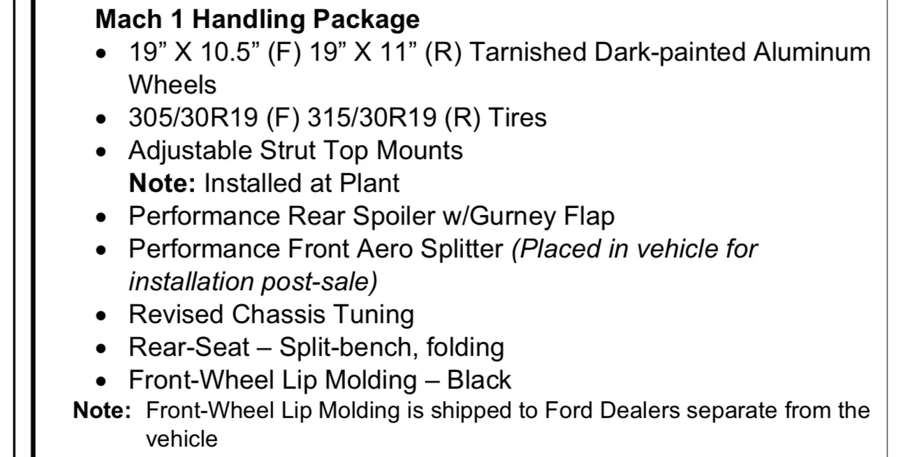

I went back through my notes.
In one brochure, Ford lists the GT PP car as having, "unique chassis tuning". The Mach 1 is listed as having, "unique Mach 1 chassis tuning".
Specific to the Mach 1, attached are some of the physical differences between the HP and base models.
Are the Magneride calibrations different? I think so, to take advantage of those specific spring rates.
I'd expect different calibrations for GT PP, Mach 1 base and Mach 1 HP.

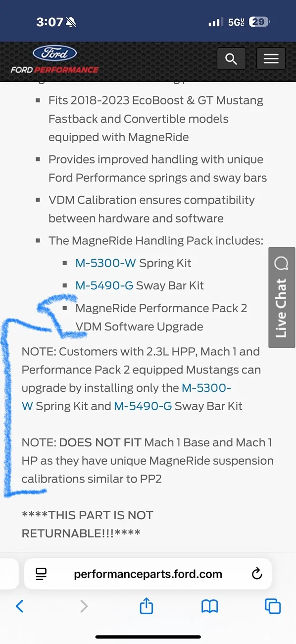

So here is where I begin to question that there’s any difference in the magneride tuning is this Ford Performance kit, where they’re grouped together that includes the PP2 software that’s “not needed”. I believe yes the PP Mustang has different tuning, but I believe the Mach and Mach HP has the same and starting to believe the PP2 and GT350 share the same as well to the Mach. Therefore why all 4 of those cars don’t need that software to run those springs or sway bars, where as the GT PP does.

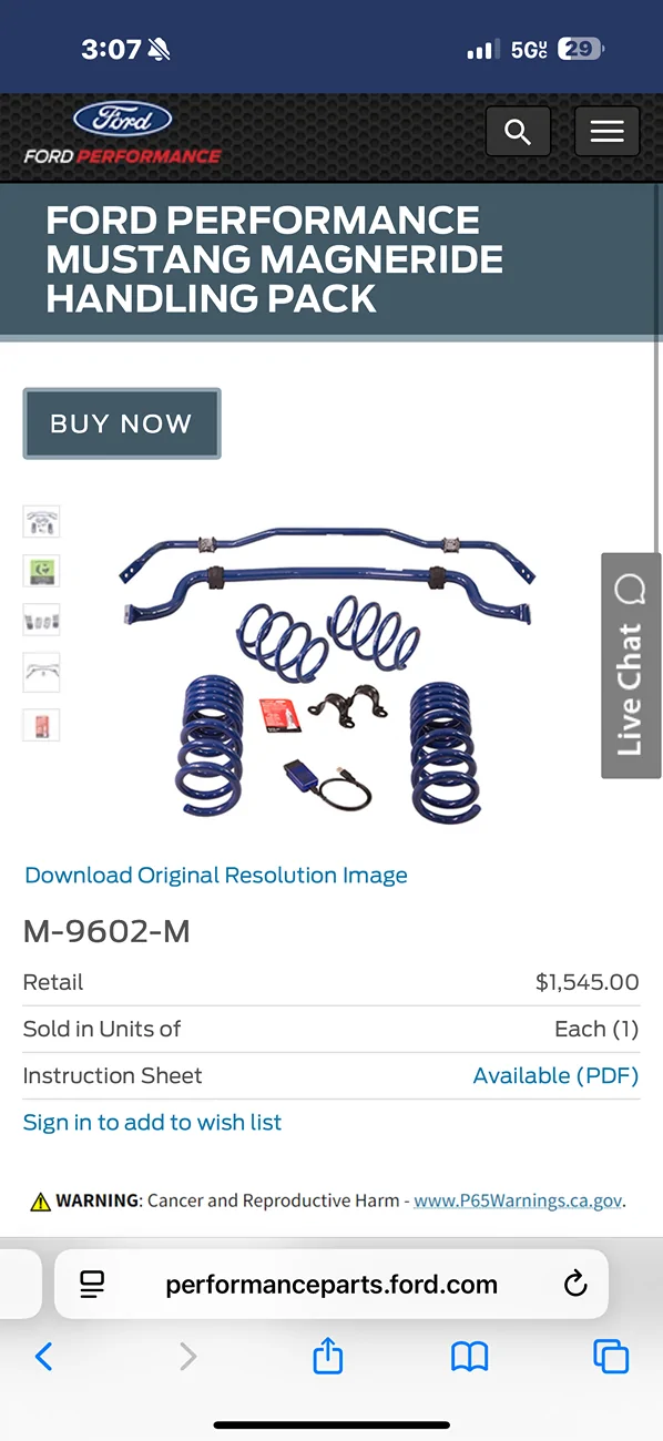

I can understand your reasoning and don't doubt your thoughts.
The "unique" phrasing used at the time could have come down to Marketing more than performance.
https://www.mustang6g.com/forums/th...-springs-part-m5300w-2021-2023-mach-1.200215/
https://performanceparts.ford.com/part/M-5300-W
  • Used in Ford Performance Mustang MagneRide Handling Pack M-9602-M for 2018-2023 Mustang Fastback and Convertible models

My thought is that the “unique” chassis tuning phrasing comes from the stiffer springs and solid rear sway bar. Especially because in the order guide they break down each part the handling package contains specifically, except the springs and rear sway bar, which is where they got cute and put that wording.

Why in some older threads do people say the non-HP and HP cars have different magneride calibrations, etc? The consensus I thought was is this is not the case and it’s merely bolt ons.
Ford Performance confirmed the Magneride tuning is the same. It adapts to different springs.
