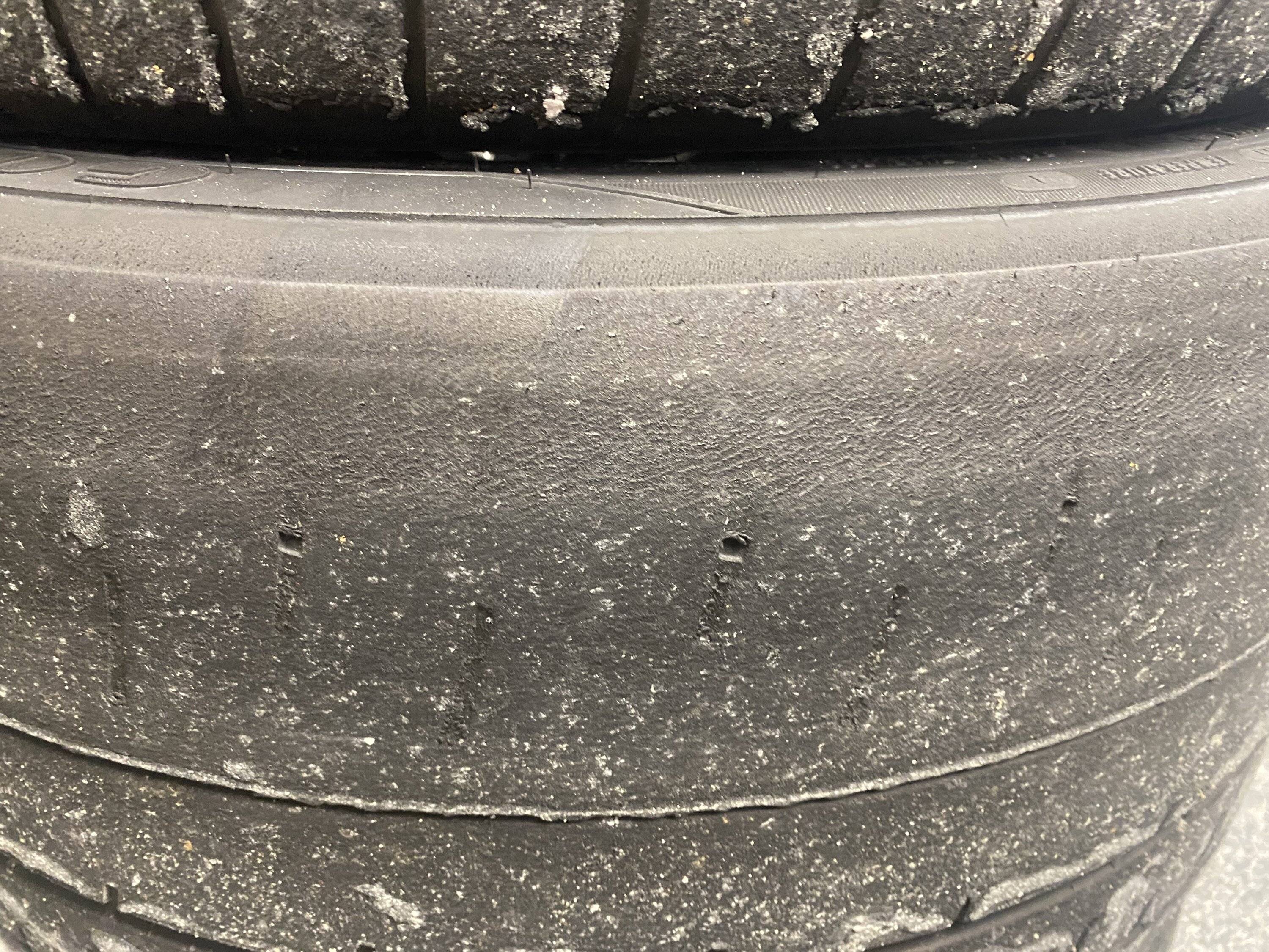

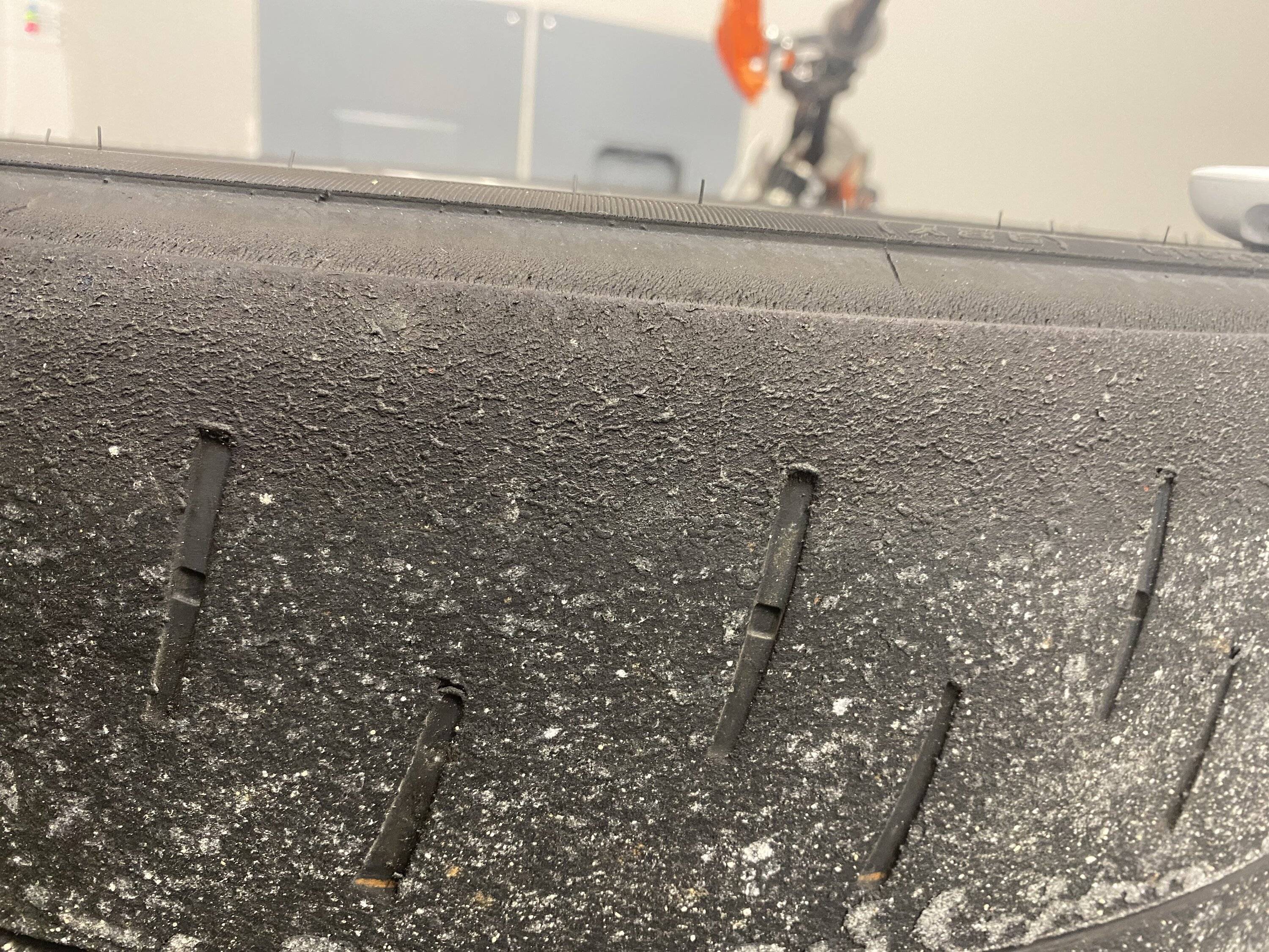

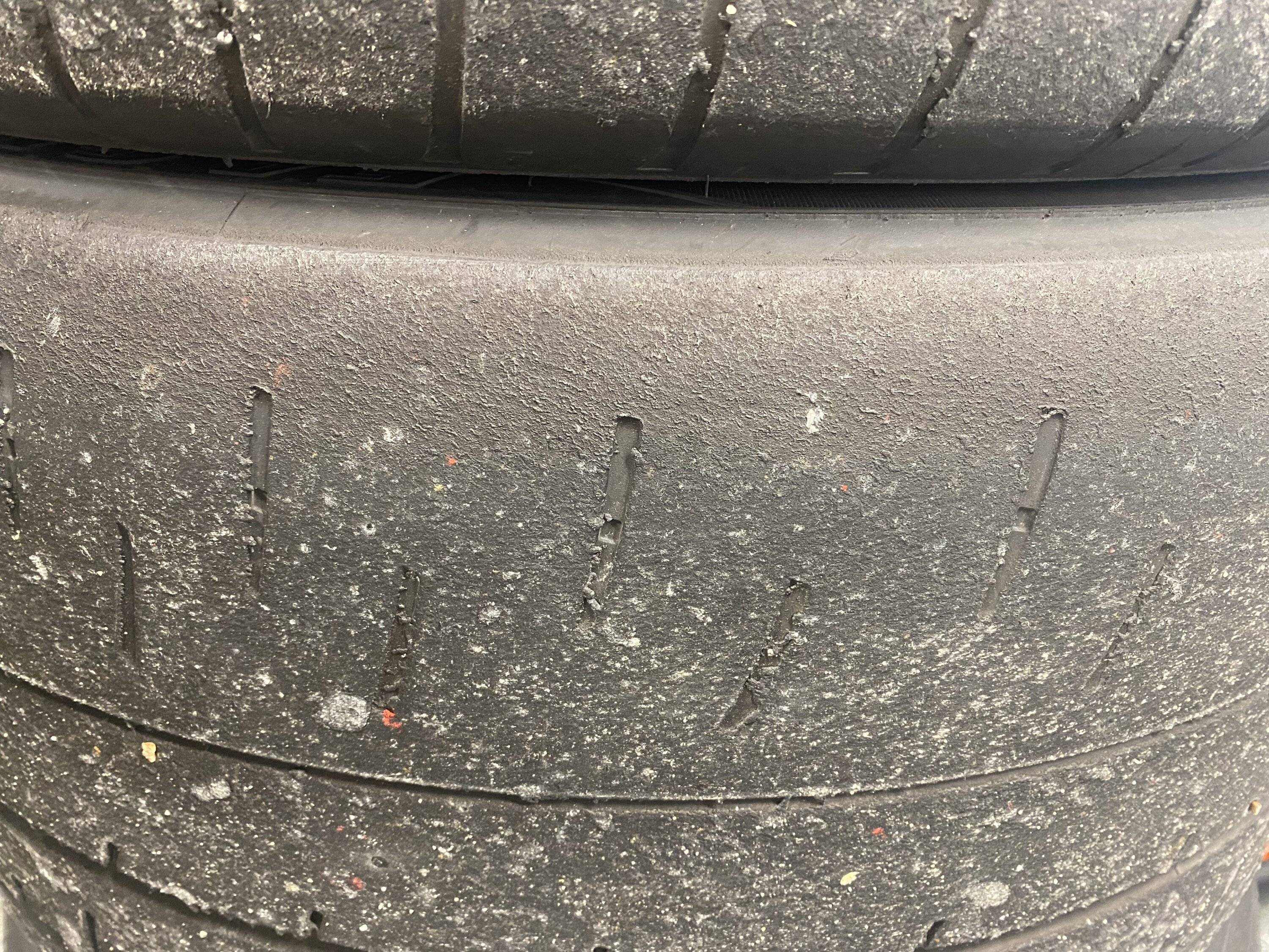

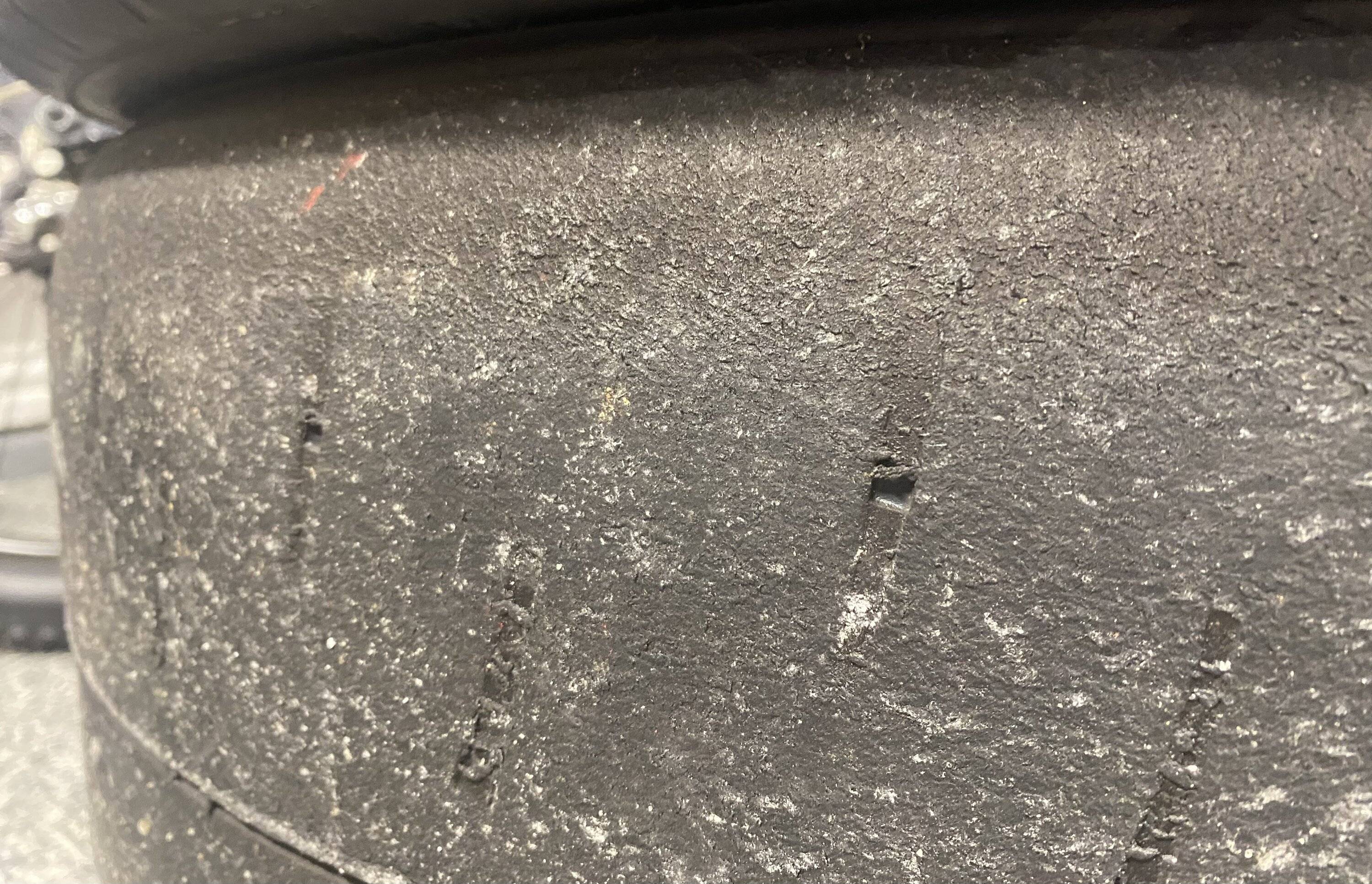

FWIW my tires (305/30/19 Goodyear Supercar3R) 100TW. After 1 day at MSRC, 1 day at ECR and 1 day at COTA. I rotated left and right through those days. The most worn one did 2 rotations on the front right of the car.
