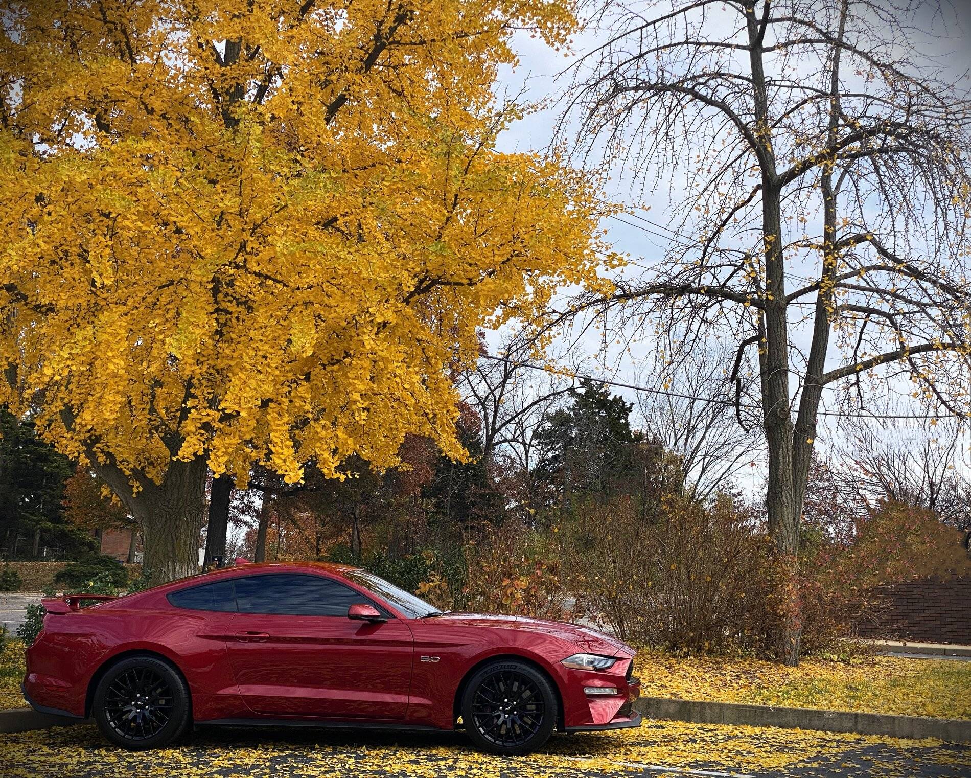

Ok guys sorry for not messaging back to all of you, i didnt get any notifications...to answer everyones questions:
im going to inflate the tires to 32 psi.
i had a 2018 non pp/mr car but since then i bought a 2020 pp/mr car
i checked the suspension, no shipping blocks and i believe the picture that you guys are seeing makes the car look taller it sits lower in my garage.
I never have had the car in sport+ until yesterday and i will say the whole attitude of the car changed alot the steering stiffens up quite a bit, bumpier ride, and my feel if floating is damn near non existant.
i have dug deep in other threads and peope say that in normal mode it feels like a non pp/mr car so maybe thats what im feeling
i will say that in normal mode i barely feel any bumps at all so i believe its doing its job
hopefully i answered all of the questions and please shoot me anymore advice or feedback if theres anything else that jumps out at you i want to make sure this car is performing perfectly lol thanks for all the help!
