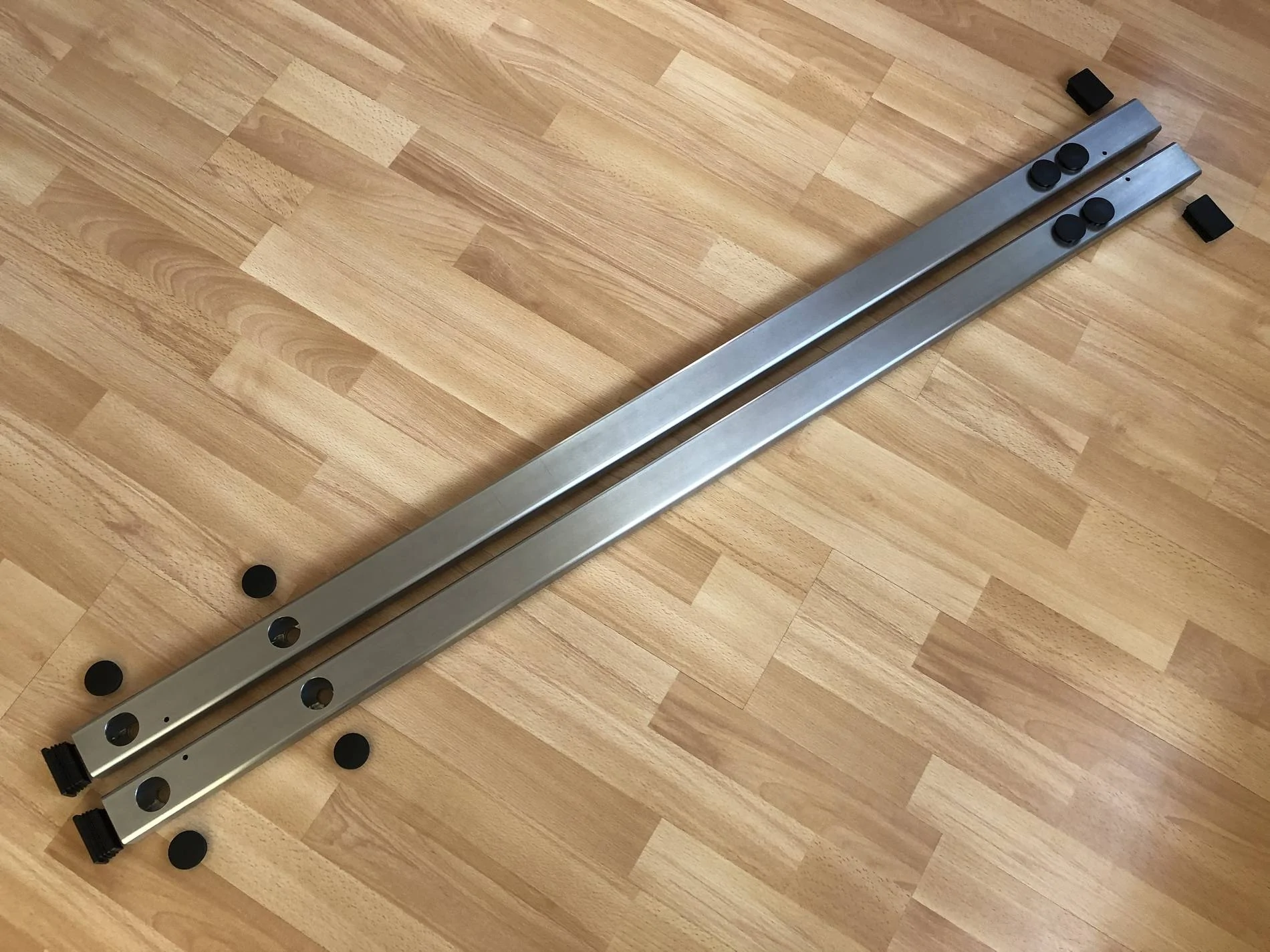

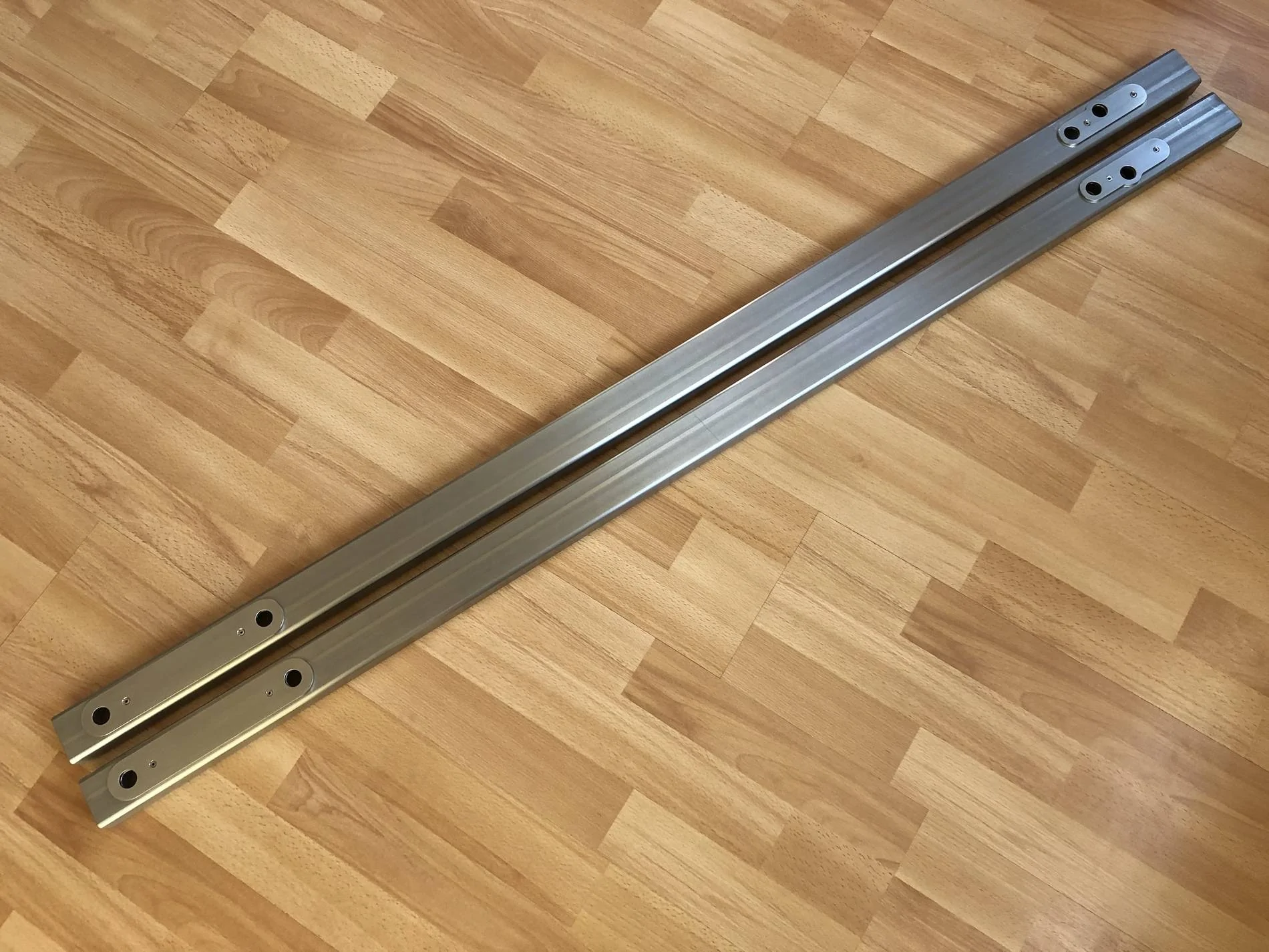

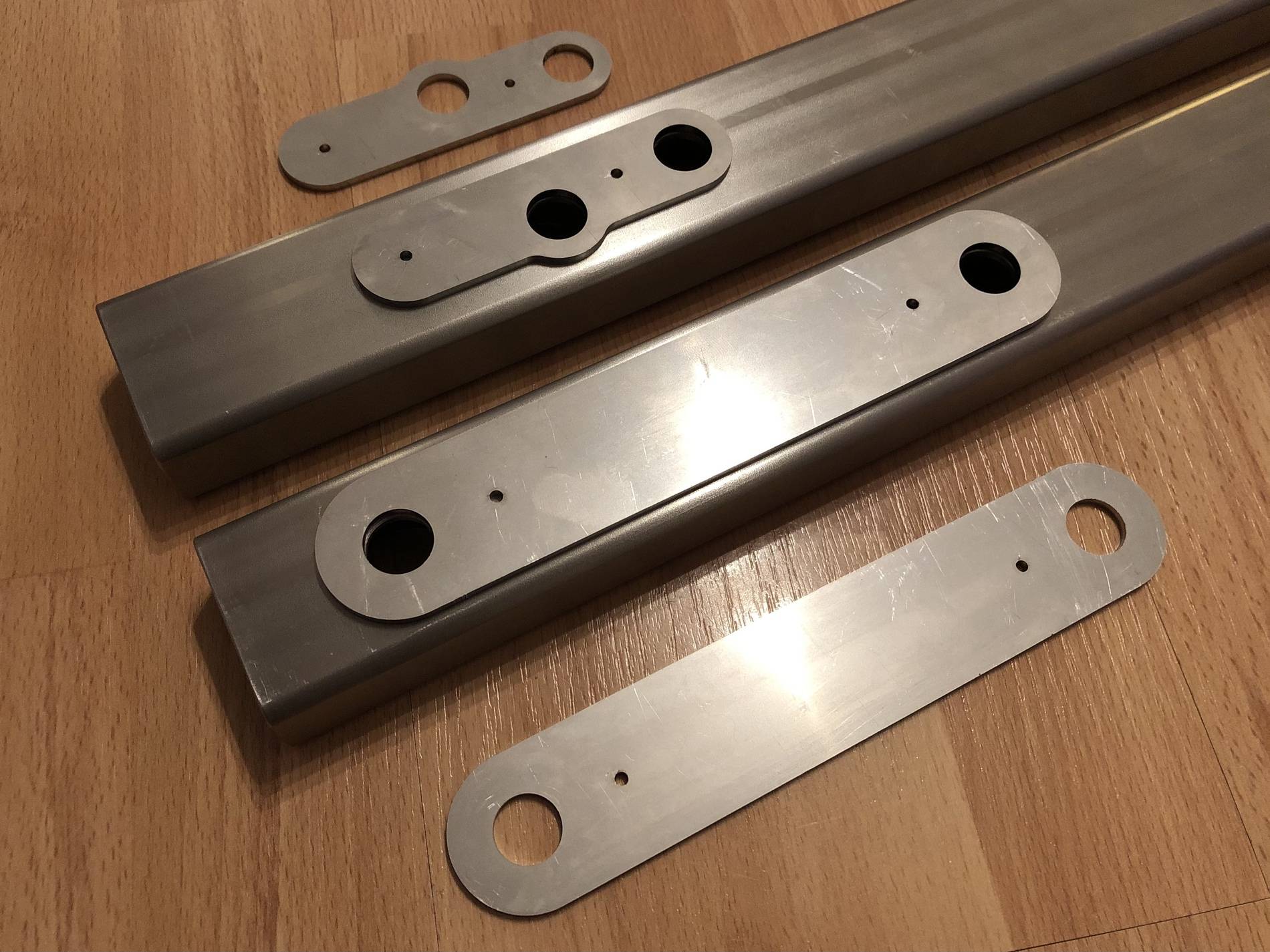

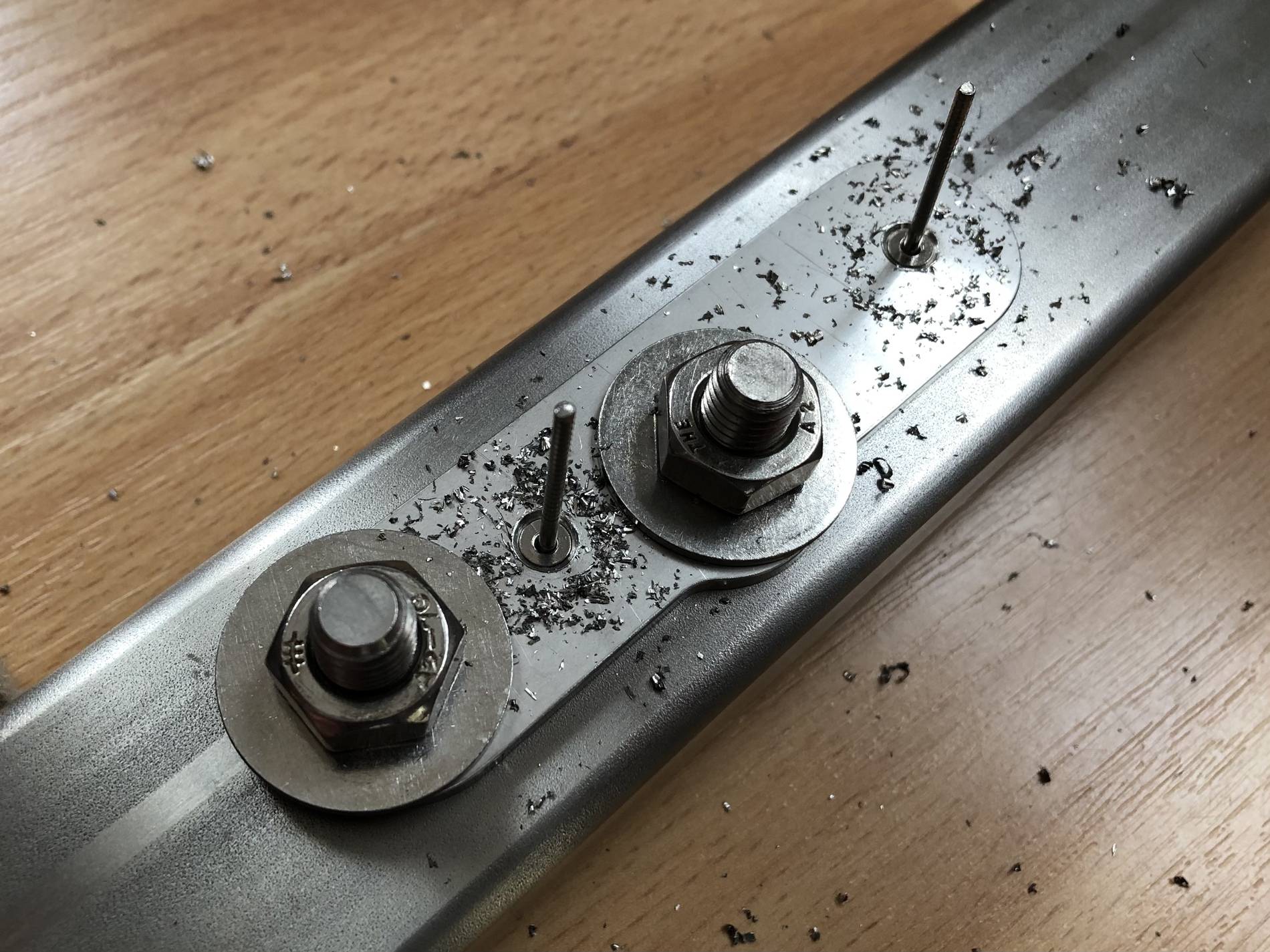

What Gauge Tubing did you use?
All info on this post from my build thread :
Finished the stainless jacking rails :like:
I went for (with my reasons) :
  • 304 stainless (good enough for under the car – no issues with scratching / rusting etc).
  • 50 x 30mm section (I wanted them a little lower than the pinch welds).
  • 3mm wall section (I didn’t want to crimp or dent them).
  • 5mm offset for the front holes (to allow for the offset in the frame mounts).
  • 16mm small holes (good wiggle room around the M10’s – still easily covered by the 28mm captive washers.
  • 30mm big holes (to accept the 28mm captive washers / easy size to get blanking plugs).
  • 3mm mounting plates riveted to the underside (no need to trim seam sealer / some air space between the frame / 8mm overall protection for the pinch weld).
  • Stainless rivet’s (just to hold the mounting plates in position relative to the rail during fitment / no chance of electrolytic corrosion with ally rivet’s).
  • Plastic end plugs and hole plugs just to keep the stones out of them.
  • 5mm drain holes at each end of the rail positioned on the outer / lower edges.
  • Both rails are the same length and extended a little at the front.
  • Rails are sized to work with the Steeda IRS braces (which are now coming up on the jobs list).
Overall I am very happy with them and they offer some benefits (to me) compared to the off the shelf offerings – They are sized exactly as I wanted, they should outlast the car and cost me £116 all in (including some spare plugs etc) compared to circa £140 / £175 rrp (+ postage / UK prices) for mild steel offerings from the big names :like:
Final pictures :
Stainless laser cut pads :
Pads drilled through and countersunk for stainless rivets :

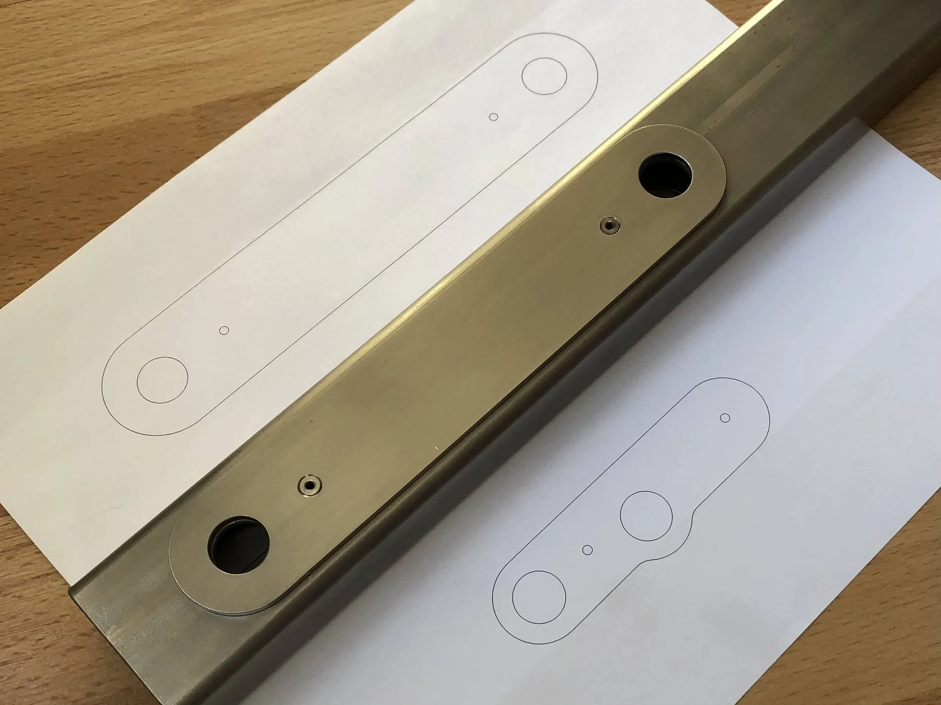

Pads mounted, original paper templates behind :

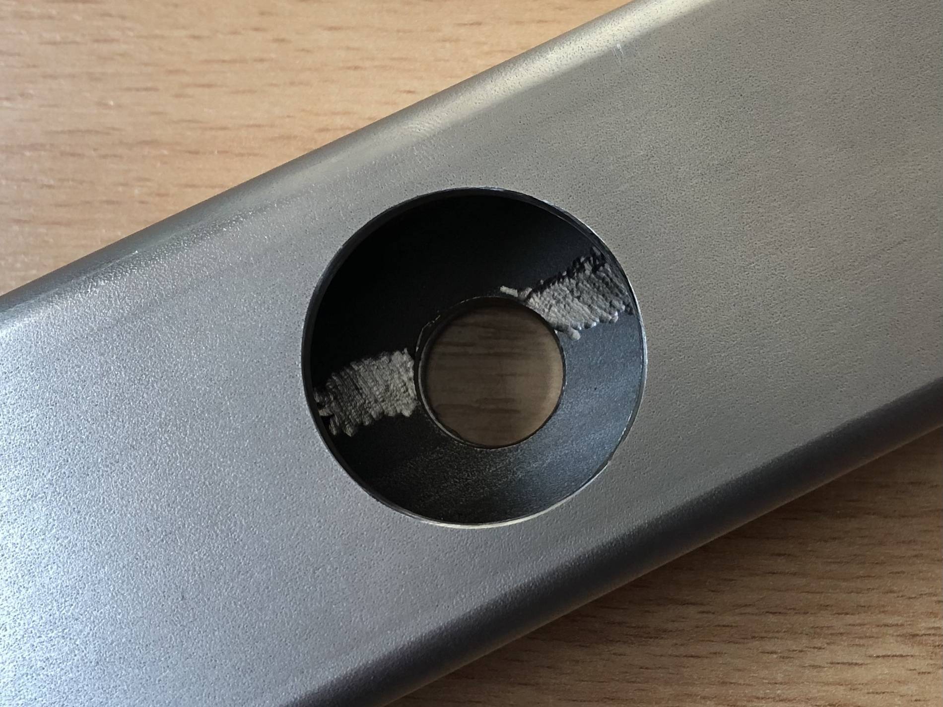

Ground the internal tubing weld flat where the bolts / washer will clamp :
All done :
I have since flushed them through to rid them of debris and give them a scrub up with a 3M pad. They just need the end caps banging in and then bolting under the car, hopefully this weekend if the bolts arrive in time from Ford … :like:
WD :like:
Hope that helps :like:
WD :like:

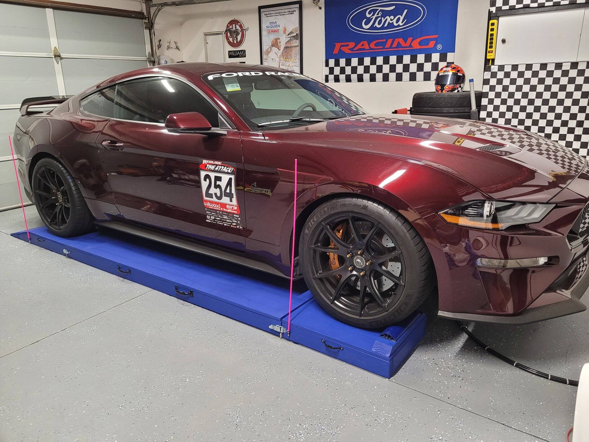

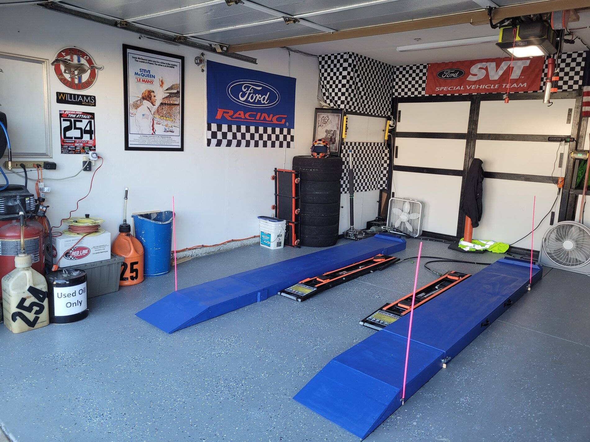

Here are a couple of pics of my full length modular drive up ramps I built. I just remove the center sections and I have all kinds of room to change the oil as well as other things without needing to lif my car at all. And back when I built them two years ago I did it for about 150 bucks.
Do you have details on materials used and dimensions? How tight a fit is to do oil changes? Thank for any response!
