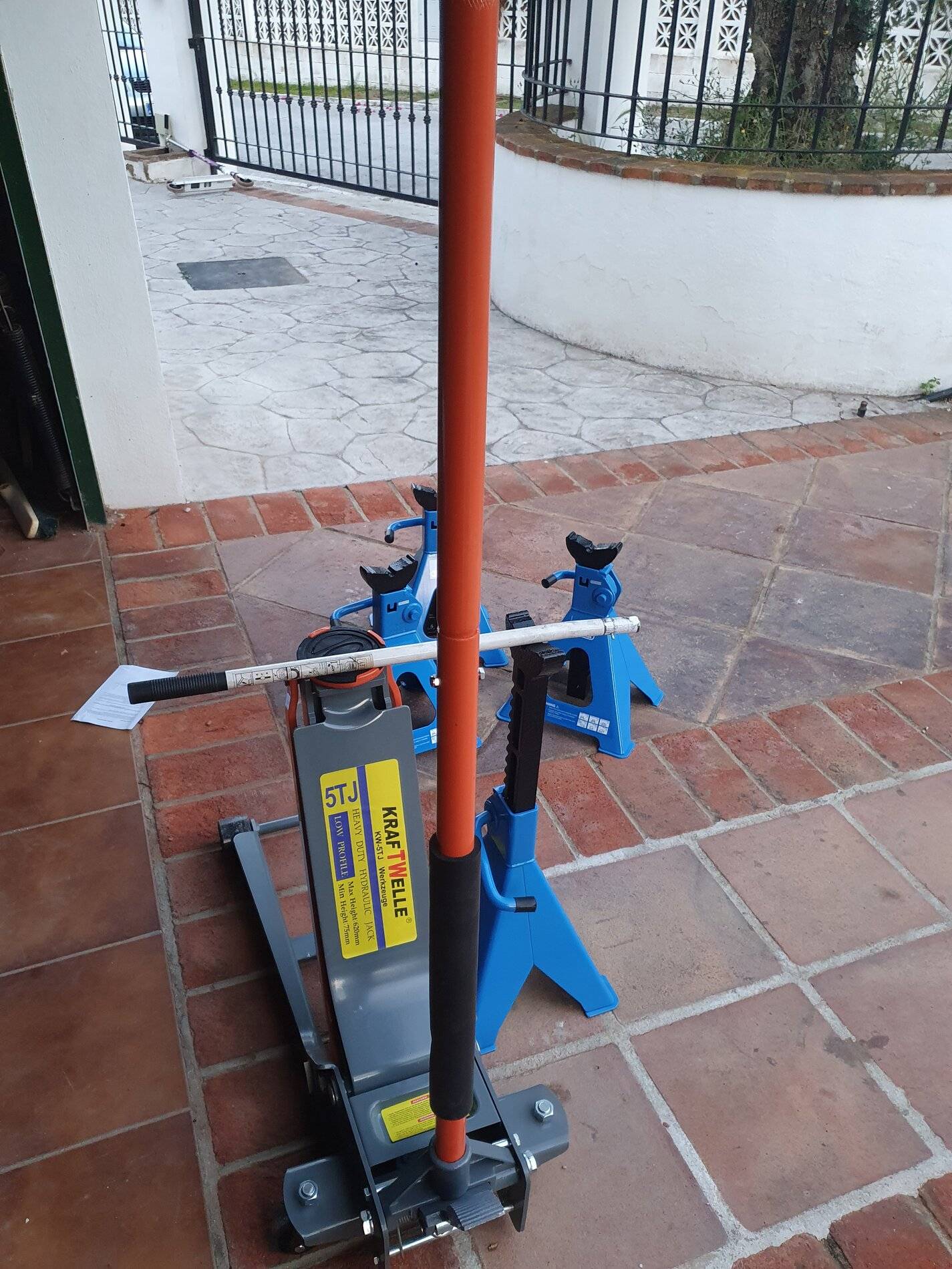

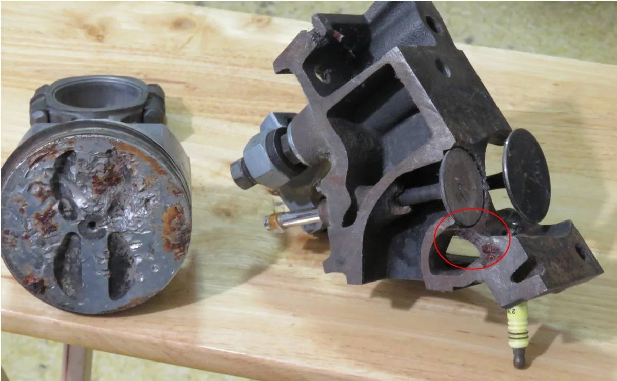

As I've grown to start doing more than just oil changes/brake pads on my car, I've now invested in some better axle stands, and also a better jack. When I ordered my first jack, I did not know "low profile" was a thing, so my first jack, though good quality, was always a bit of a hassle to get under the Mustang. Unpacked it all yesterday:
Jack jacks up to 62 cm (higher than quickjack, which tops out at around 50cm), and stands go up to a matching 63 cm, so should make things a bit more comfortable and safe under there than before.
Min height for the new axle stands is rather high at 40 cm however, so perhaps I'll keep still have use for my older smaller and lower quality stands for the more frequent trackday race pad/OEM pad swaps where I just need to get the tires of the ground. If so, at least they will be less of a waste of money, while I guess I'll try to sell the jack.
Nowhere as convenient as using the quick jack I imagine though, so for those with enough money ...

Really nice driveway!! Hope you put down some plywood under those stands and jacks.
From my thinking, I would suspect that you really cannot use the top stand position unless you put something under your jack. The jack needs to go higher than the stand to be able to lift it off the stand and to remove the stands so you might lose a cm, give or take, going down a notch on the stand. They are rather impressive in height. At the same time, nothing prevents you from driving up a board or two and putting something under the full length of the Quick Jack to get more height.
Thanks. I glued some cardboard under the older jacks, which seems to have been enough to protect the floor so far, but will perhaps try to find something better this time around.
Yeah, that is true. But finding really high axle stands was not so easy, unless I want the minimum height to be really high too (and expensive), which creates another problem. These were the best match I could find. In any case, at the very top position, an axle stand insert feels a bit wobbly before you put weight on, so going down a notch from max is perhaps preferable anyway.
