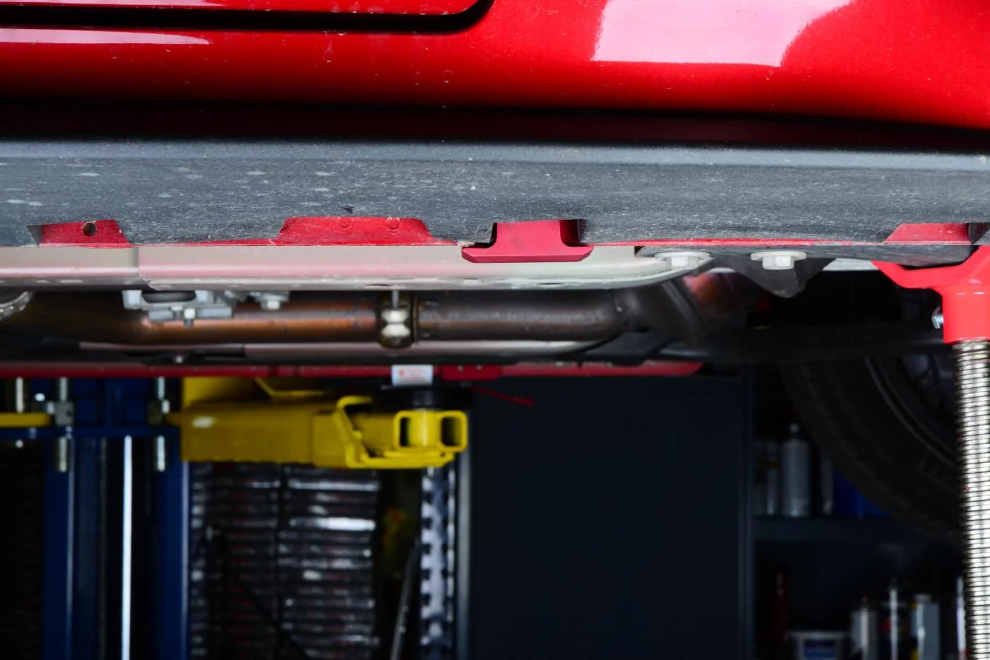

We now have them in stock and in red and soon the black. here are some pics. They also can be put in many spots on the pinch weld to lift both front and rear of the car with one floor jack. The car can be lifted anywhere on the pinch weld.

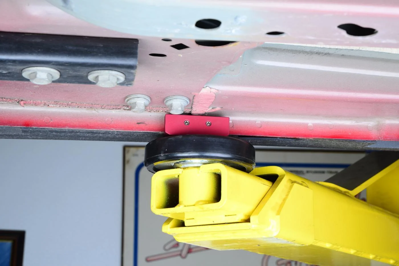

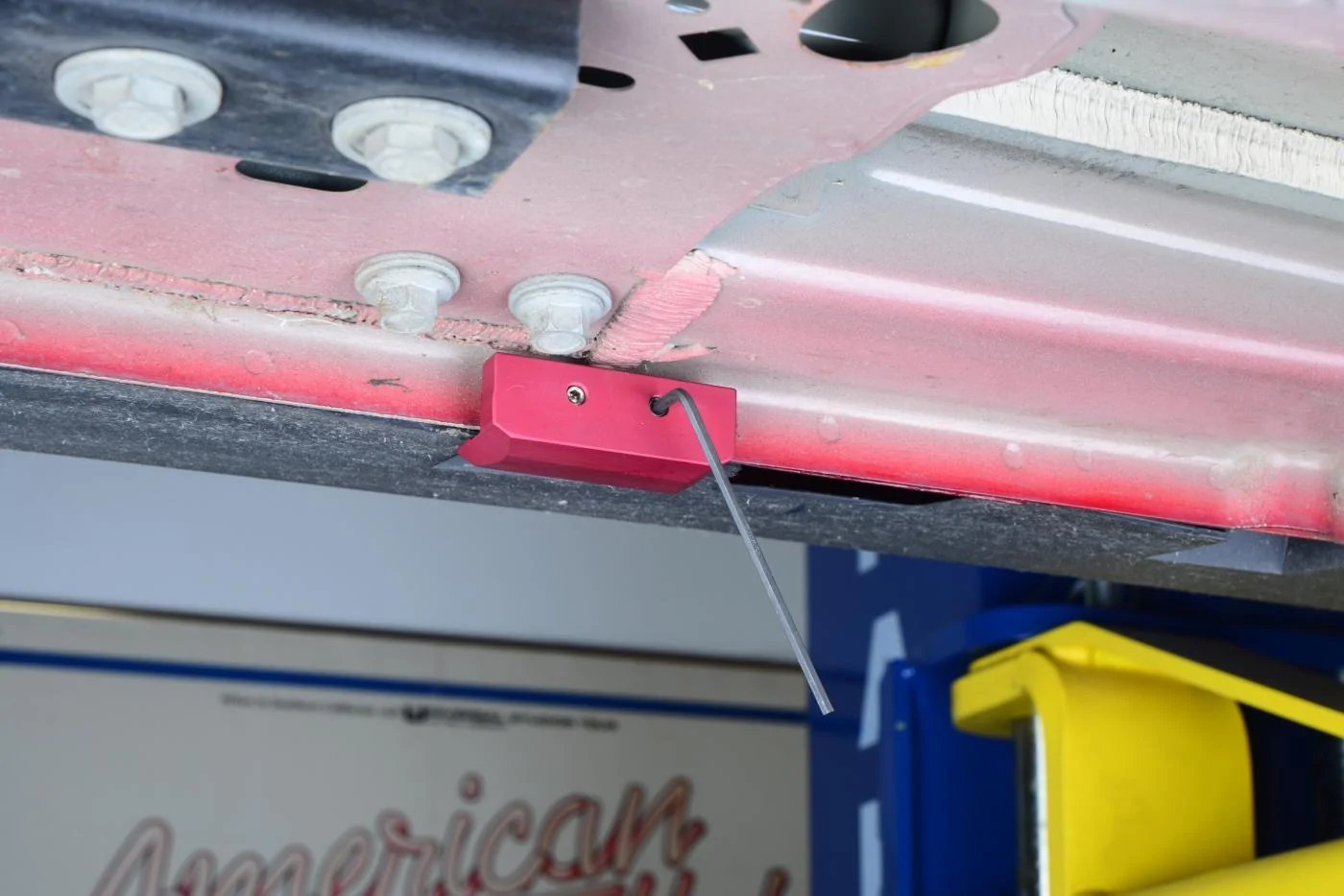

Check your eyes. The picture plays tricks on you. That is at least 1/2 thick.
They are made to lift the car up by the bottom of the pinch weld just like a stock jack that came with your car. The are unlike our magnetic jack pad that is used and then removed from the car, these you leave on and great for the track if you change tires all the time. We also angled the bottom so as the car goes up at a angle the jack stays flat the bottom of our lift pad will rotate on the jack top and not bend the pinch weld.
