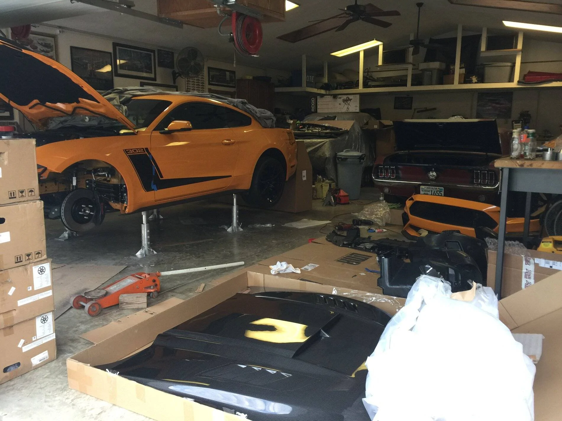

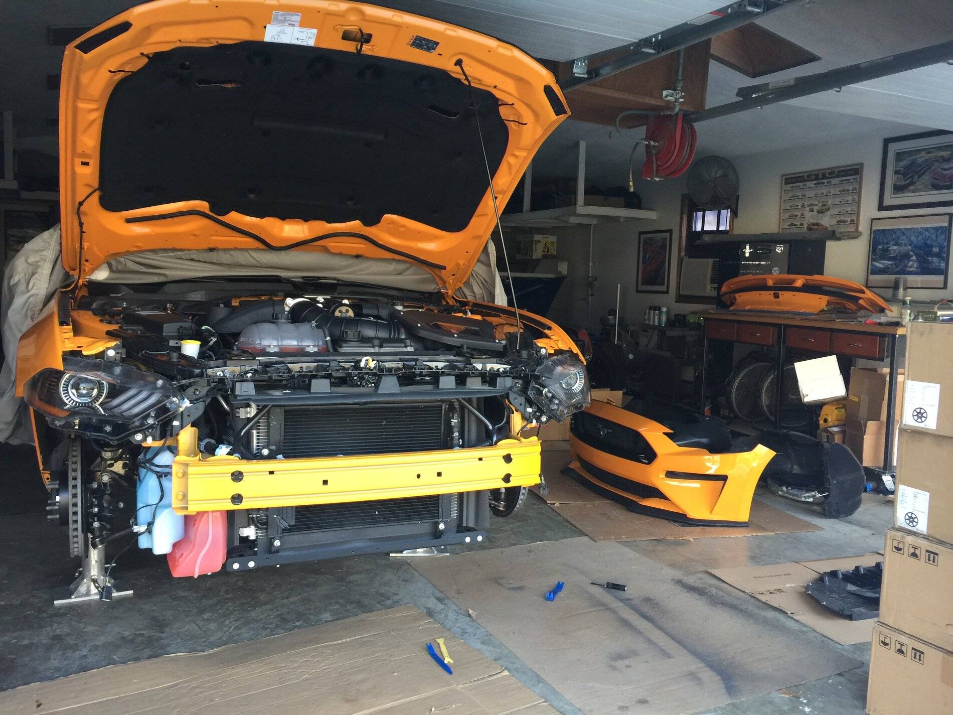

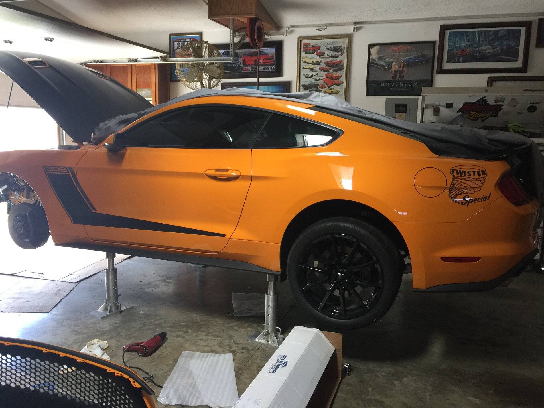

made my own jack stands with three different heads
Holy foook! Thems some big-uns!
You could support the Eiffel tower with those...

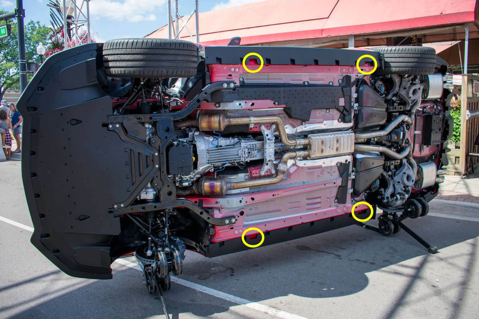

There are arrows molded into the underside of your plastic side skirts. They make it pretty specific and clear.
