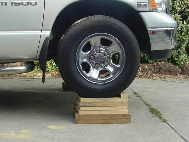

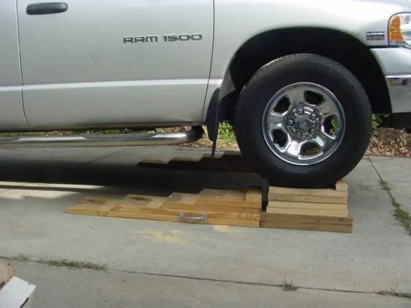

I prefer ramps. Always nervous getting under one sitting on stands. Here's my Ram sitting on some homemade ramps:
