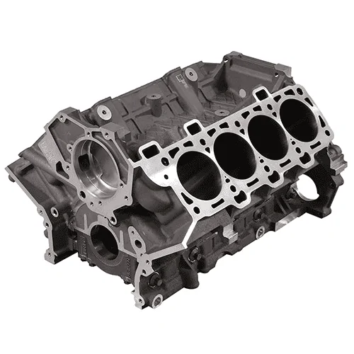

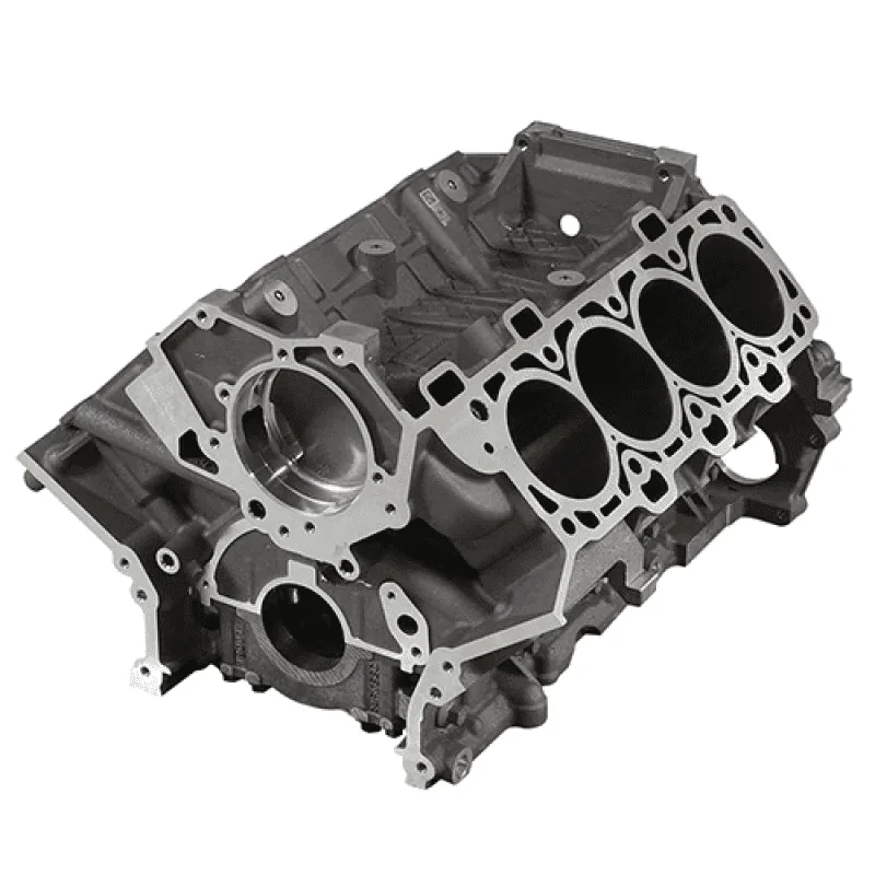

engineermike
Jul 15, 2018
6,300
6,618
La
2018 GTPP A10
It is odd that people have made prodigious power on the stock gen3 long block and the aluminator sc uses a stock gen3 block, but ford also felt like the gt500 needed revised block geometry at relatively modest power levels.
