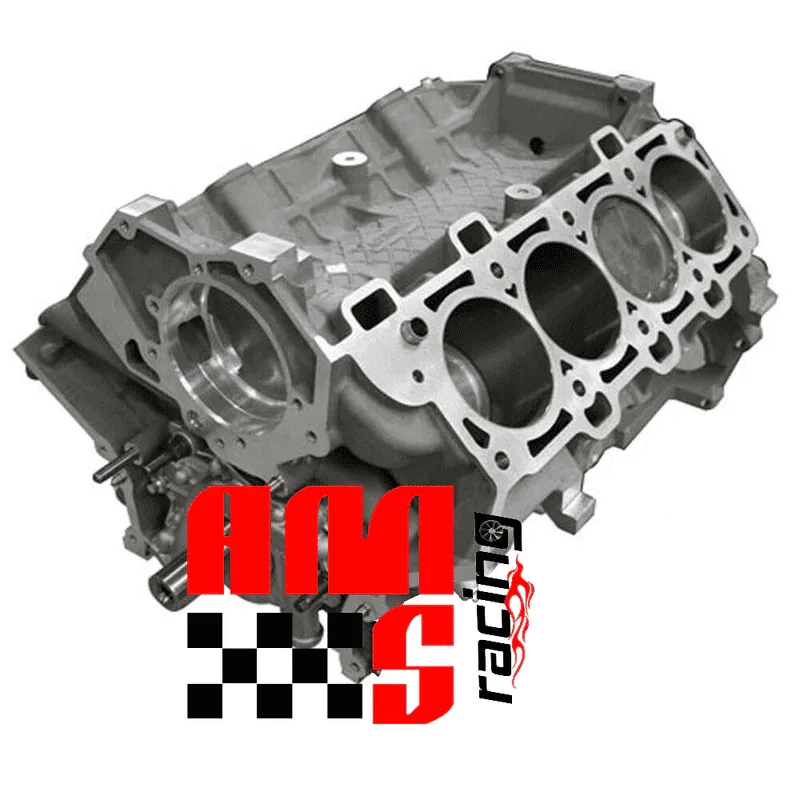

Wow, the gen 2 doesn't look like that.
Still has the elongated channel on the valley side of the cylinders which is where quite a few cracks were noticed. Which is why you see the center casting in the Gen3 coyote and the 5.2gen3. Also, the biggest liability with the gen II was the head bolts, which were not only less diameter, but don't penetrate as far into the block. GenII can handle a good bit of power, but is prone to lifting heads after a certain amount of boost is applied. Can be mitigated with some of the better gaskets now or even better, rimming the top and machining the heads to receive a mated joint.
