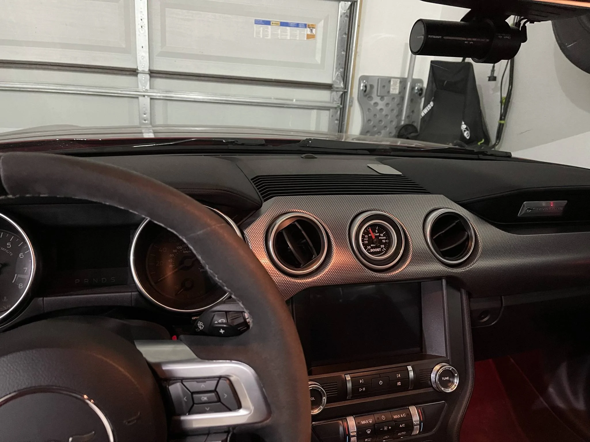

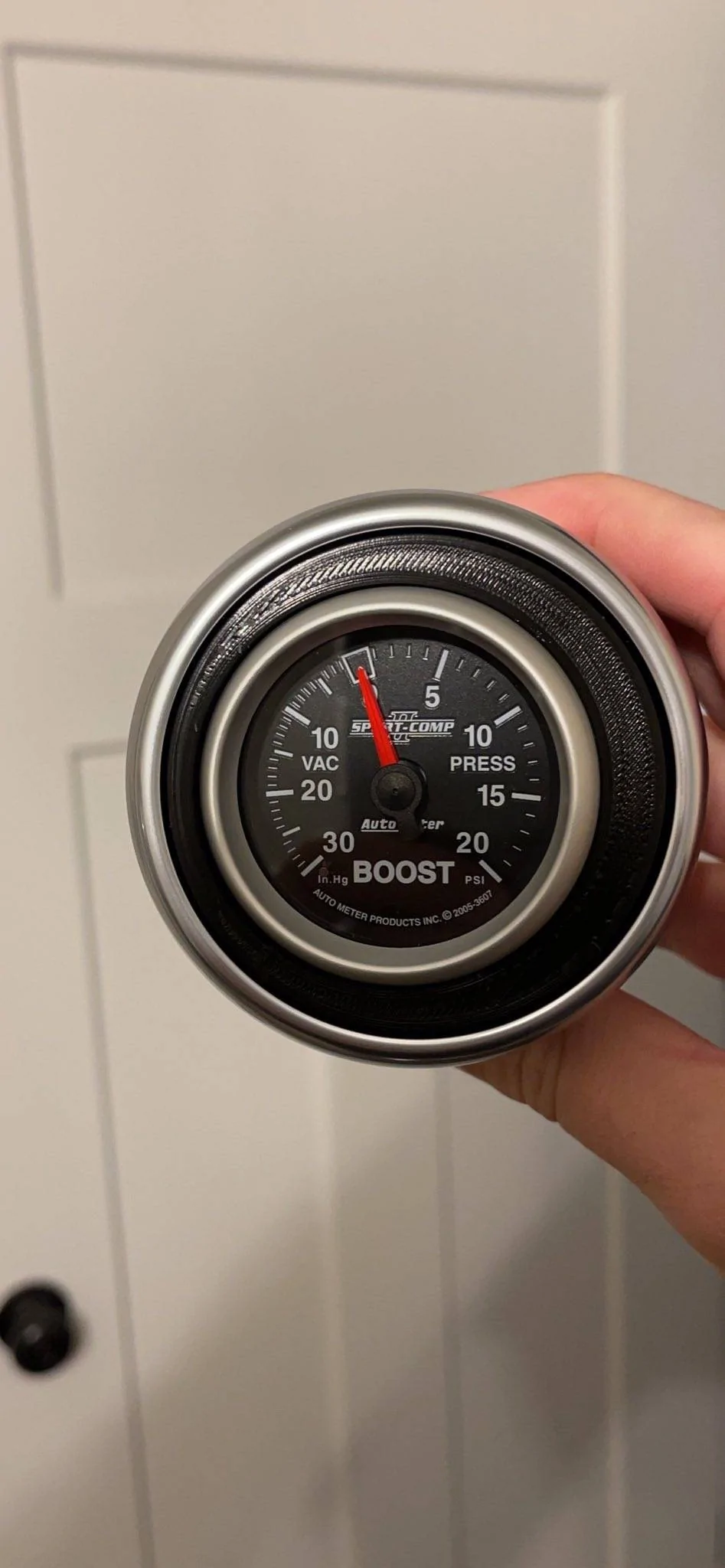

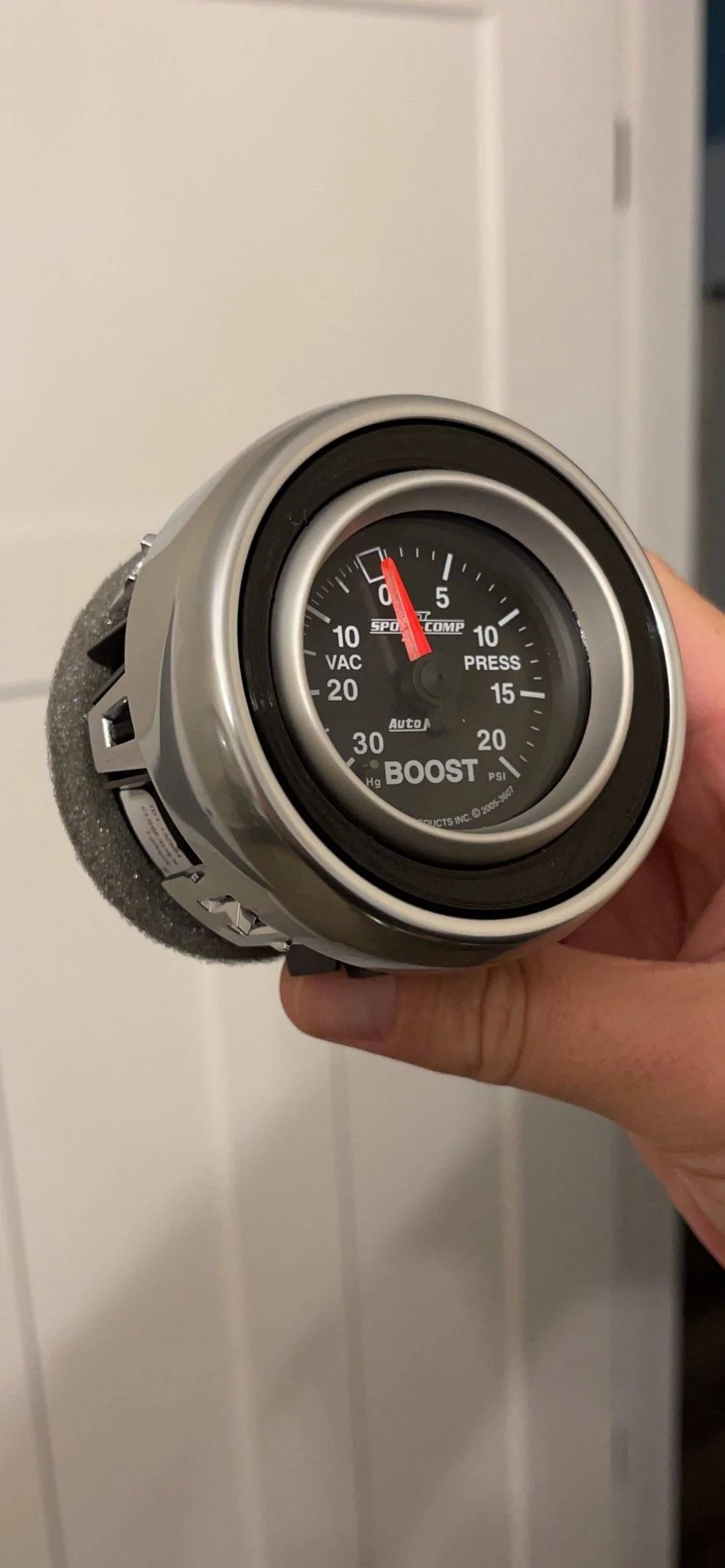

I did a mechanical boost gauge to the port on the back of the blower housing. I designed and 3D printed a mount for my center (non-PP) vent pod. Plenty of commercial options to do something similar to one of your vent pods though and have an accurate gauge. Something like this would accomplish pretty much the same thing: https://lmr.com/item/ATI-VPOD76/mustang-vent-gauge-pod-15-17
