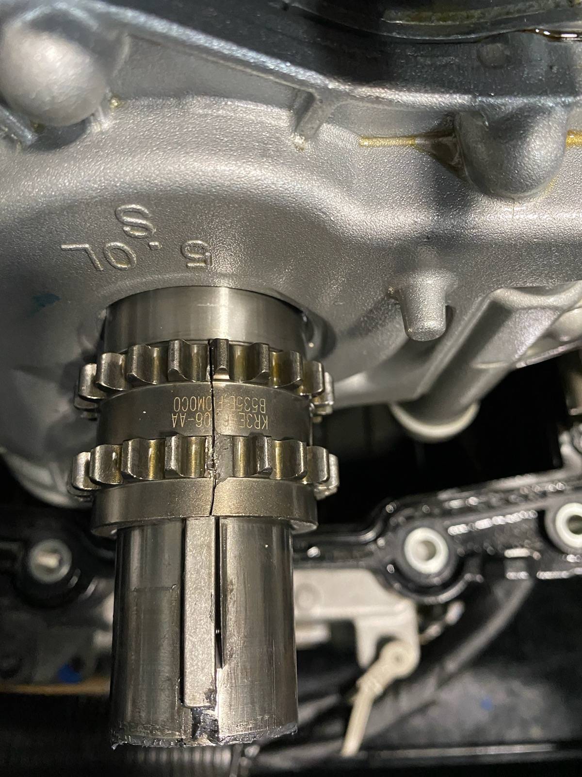

My car is at the dealership right now because a sprocket tooth dropped out of my oil pan when I changed the oil. Bone stock car, never hit the limiter, 2020 with 10k miles on it.

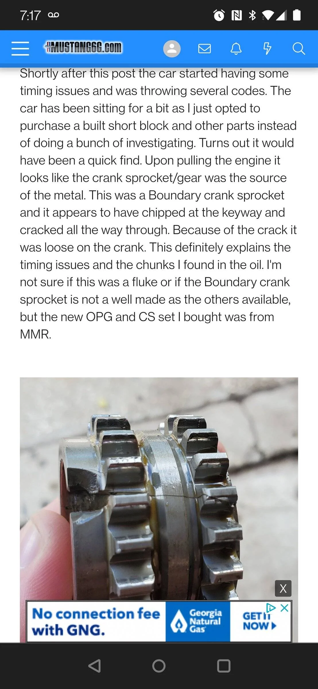

Add this to the list....this one is what inspired this thread.
https://www.mustang6g.com/forums/threads/16-gt-sleeved-predator-and-f1a94.143471/post-2937713

Here is a picture if my stock crank sprocket. Stock 2020 car.

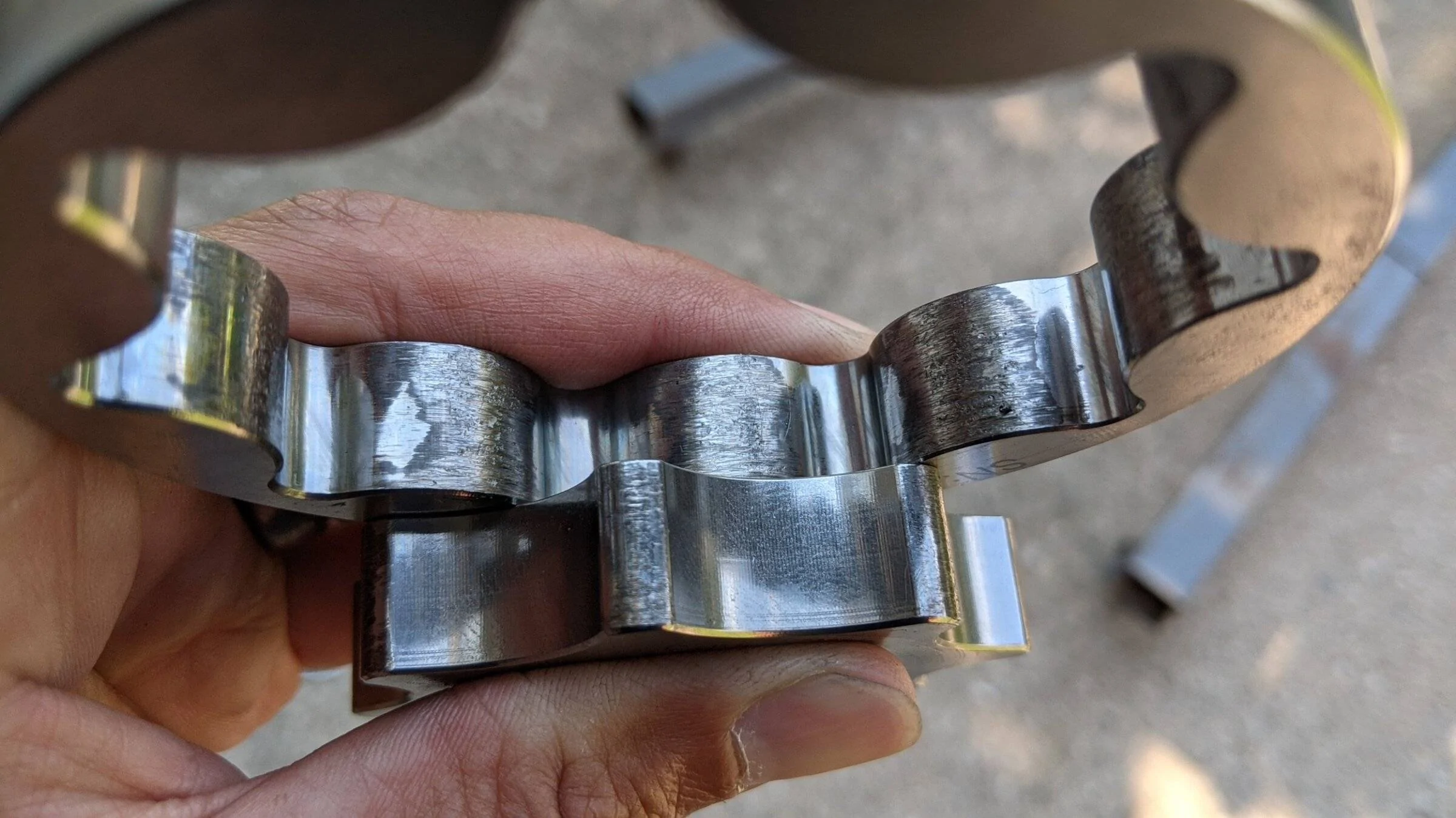

Yep, i would not run a free set from Boundary.
We pulled a set of boundary gears from a 3k mile build that valvetrain issue. They were worse than the set i had. Here is a pic:
Out of curiosity, which OPGs do you run or recommend, if not stock?

I think the TG and key were the victims in this one, not the perpetrator.
