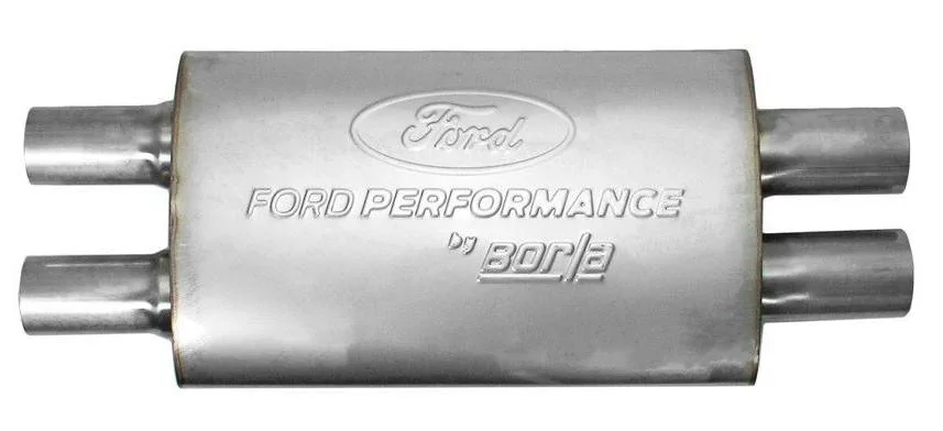

I was running the Kooks catless headers into a Ford Performance by Borla Extreme catback (includes X-Pipe). Absolutely redonkulous!!! I have since swapped in the Ford Performance by Borla resonator in place of the X-Pipe and the 2K-3K rpm ungodly rasp has been taken care of as well as the E85 cold-starts have been toned way down too. The car is still Loud AF but the sound volume is totally controlled by me now. Before I had to literally putt away from a red light in order to not shatter the windows of whoever was behind me. The sound cancellation of this particular resonator is amazing below 3K rpm.
