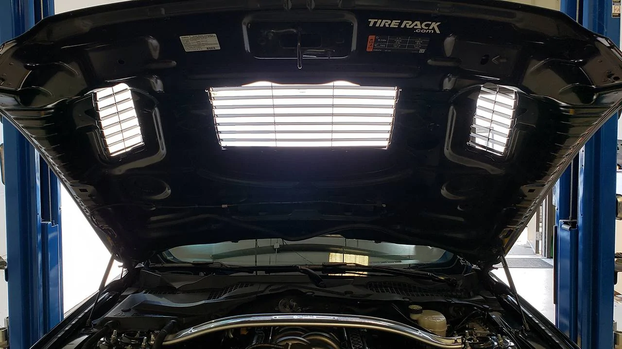

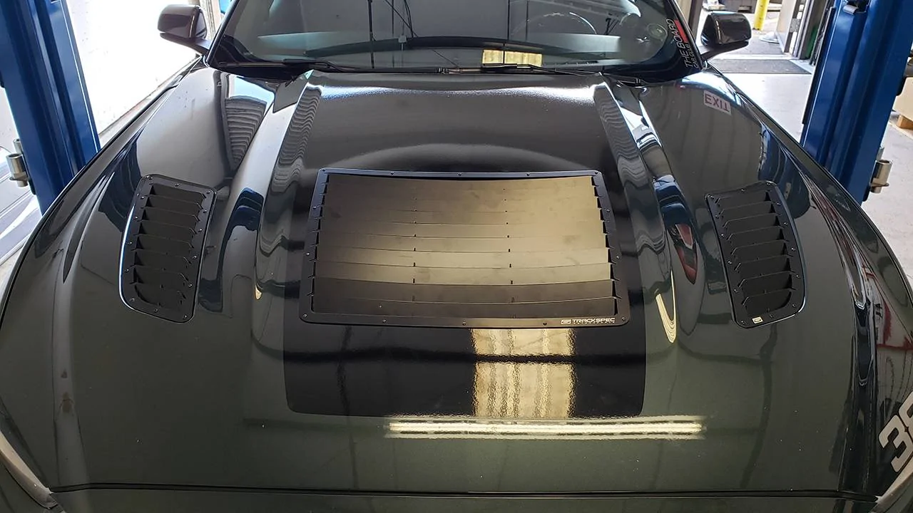

Shortly after I bought my s550 I removed a lot of the excess material under the vents and got some cool looking CF hood vents. They worked but it was definitely not enough as 1 of the CF vents blew 20' into the air when going down the main straight at Thunderhill.
From there I upgraded to a TrackSpec hood vent kit and super happy with the results. You can see the heat haze coming out of them when idling and the front end seems waaaaay more planted in certain driving situations. When installed I also had more of the hood bracing removed so that they would work more efficiently.
