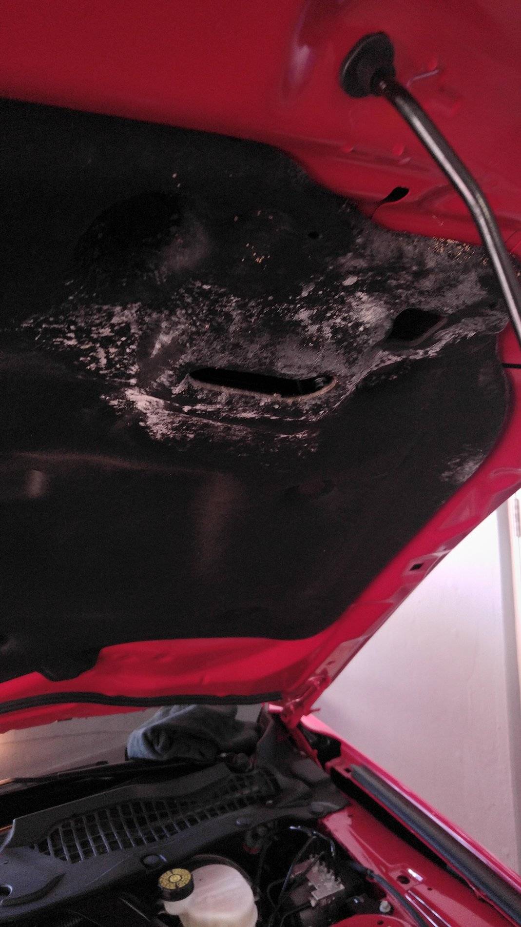

Hi to all and hope everybody is safe..
I will like to know if this is an common issue and how you resolved it.
I am getting moisture on the motor just underneath the Hood Vents. I have attached a pic for reference.
Is this a common issue or should i look further and check if something is loose on the vents? By the way both vents have the same problem.
Thanks in advance...

Mines done they before..... hasn’t seemed to affect manufacturing specs or engine.

So this is normal? I don't think so. Did you resolve it?

Mine is dry. Thats not normal
Where do you live and do you use your AC a lot ?
Is your garage'd and or in the rain a lot ?
Not sure if excessive AC use would do that ?
Good luck

Thanks for the feedback. I live in PR and the car sometimes sleep outside. The car only have 4,000 miles.
I cleaned it today and will monitor it. Actually when i did the first oil change at 3,000 miles i didn't have it.

Living near the ocean the air has salt content, some days worse than others. This may or not be what is causing your issues.

Yes it’s normal to get moisture in that area with rain. Normally it doesn’t leave any staining if it’s just water. Whatever got on that had some time of contaminant (mineral, chemical, etc). That’s not normal but whatever it was would’ve had to be on the hood.
Do you remember your car getting super dirty recently?
Hope you’re safe in PR between COVID and the earthquakes. My last visit I went to El Yunque and could only imagine how fun that drive would be in my GT.

That doesn't look like something that came down through the vent opening. It looks like splatter from the underside. Is that white residue anywhere else in the engine bay, or only on the hood liner? Anything like that on or near the radiator fan shroud or elsewhere?

Thanks @Shifting_Gears. Thanks God everything is controlled at the moment. We have to stay on the hose until May 2. Yes the Yunque is another thing. Great place.
I wash the car weekly. Didn't notice it when i did the oil change around 3 months ago.
Thanks @Idaho2018GTPremium. Your point is what got me thinking. I checked the engine bay and didn't find nothing. I also thought it was splash from underneath but there is no openings in those parts that i saw.The funny part is that it was only underneath and around the 2 vents and on the cover only. Anyway i am going to take the underneath cover out and readjust the vents bolts just in case and monitor what happens.
Thanks to all for the suggestions and advise.

Is it only on one side as your image shows or both?
My 2018 has over 37k on it now, daily driver in all weather conditions, sits outside during the day and is stored in garage at night. The hood liner on it has never showed any signs of moisture, mold or mildew.
Does you car sit on a slope so that the water is always draining forward (from windshield down hood) into the vents?

@Cobrajet70. Yes it is in both sides but the driver side was the worst. That's a good point, yes it sleeps on a slope but it is inclined inverse (from bumper to windshield) . Thinking back, sometimes in the morning i see water on that side of the hood and on top of the long part of the vent.

I am in Florida a lot and have seen that on a couple Corvettes I have looked at that are parked near the ocean, it's salt condensation.

Before today I would have said that mine is dry. But I washed it today and when I opened the hood to wipe it down I noticed water dripping out of there.
I don't know what your discoloration is, dried salt from the atmosphere is as good a guess as any. But they are active vents so I'd think some water there from rain/washing would be normal.

im gonna go with salt also.. or possibly calcium/lime deposits (presumably from hard water?) do you rinse the car off frequently? maybe it sits at just an angle (outside) that the salty ocean breeze swirls around at those hood vents and eventually some of those deposits are going to settle and concentrate?
mold had cross my mind also, but it looks a bit different than mold/mildew, and i am assuming you drive the car, just 10 minutes of the engine running would probably generate enough heat to kill mold

Well that gives me a little peace of mind.
I am thinking this could be the cause. I wash the car weekly in the same place and it is in an angle. I wash it with Meguire's Ultimate Wash and Wax. Maybe that's the deposit color that has been accumulated there.. I will monitor it before i wash the car again to confirm if it's that or not.
