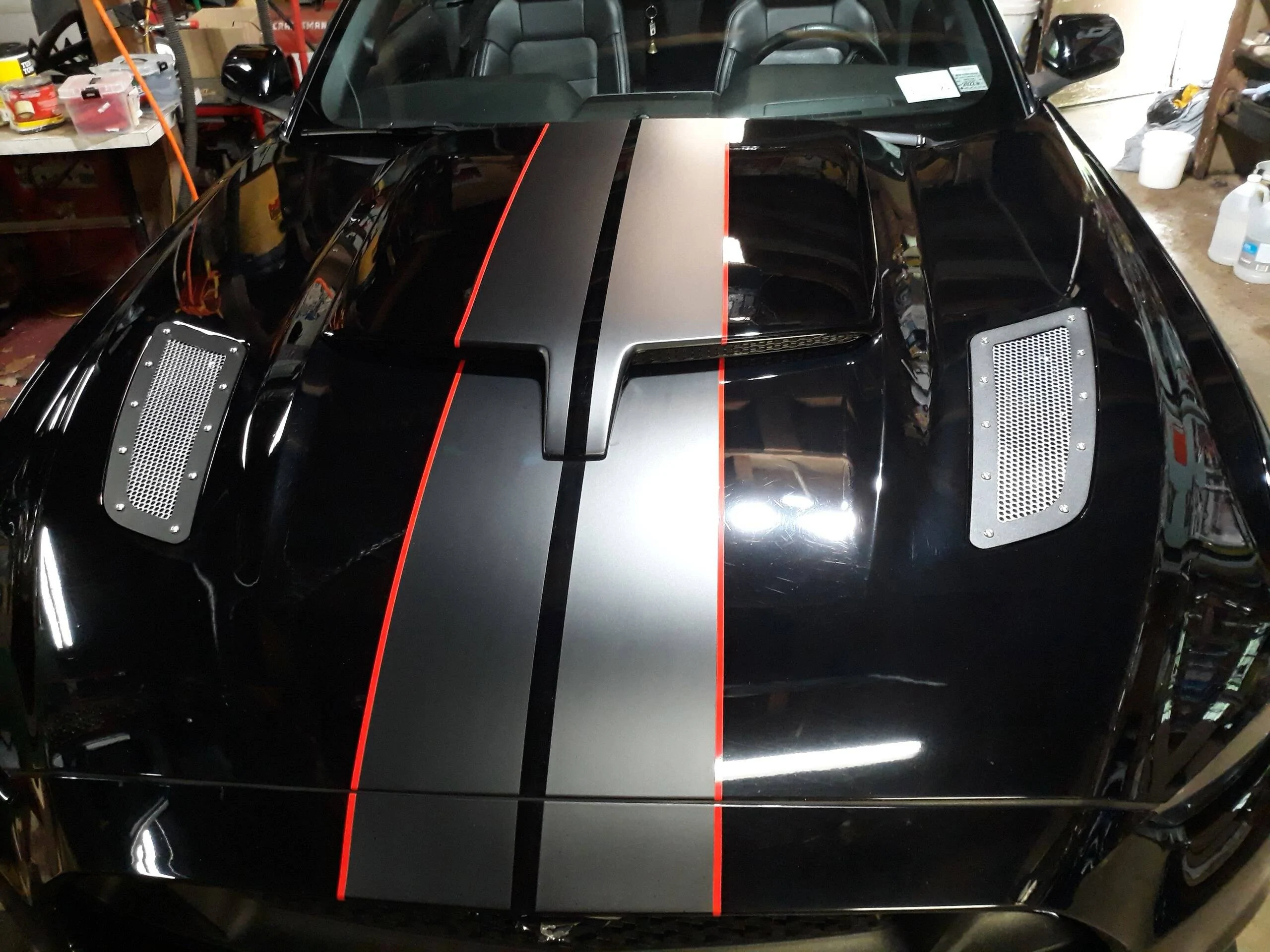

Do the stock vents do anything at speed?
They look like they are mostly for heatsoak restarts, and not much else
They do absolutely nothing other than look cool. Sorry. The holes as shown in earlier shots are smaller than your mouth, and with the black plate on the underside and the partial honeycomb up top, all it does it further cover any chances of it flowing.

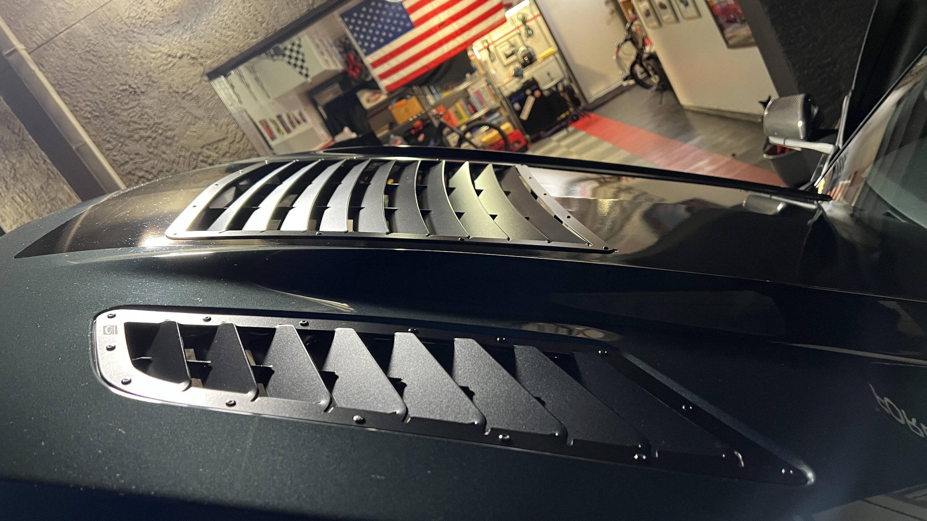

That said, unless you're racing, there's few legal reasons why you'd be spending large amounts of time at high speeds, but if/(WHEN) you start racing, one of your cheaper and more beneficial mods should be related to cutting the center and side channels, replacing them with some vents from Race Louvers. They'll drop a bunch of heat out of the engine bay by creating a negative pressure pocket which will extract the air with ease, and they'll actually suck you down a little bit better to the track creating some little downforce, and defeating lift.

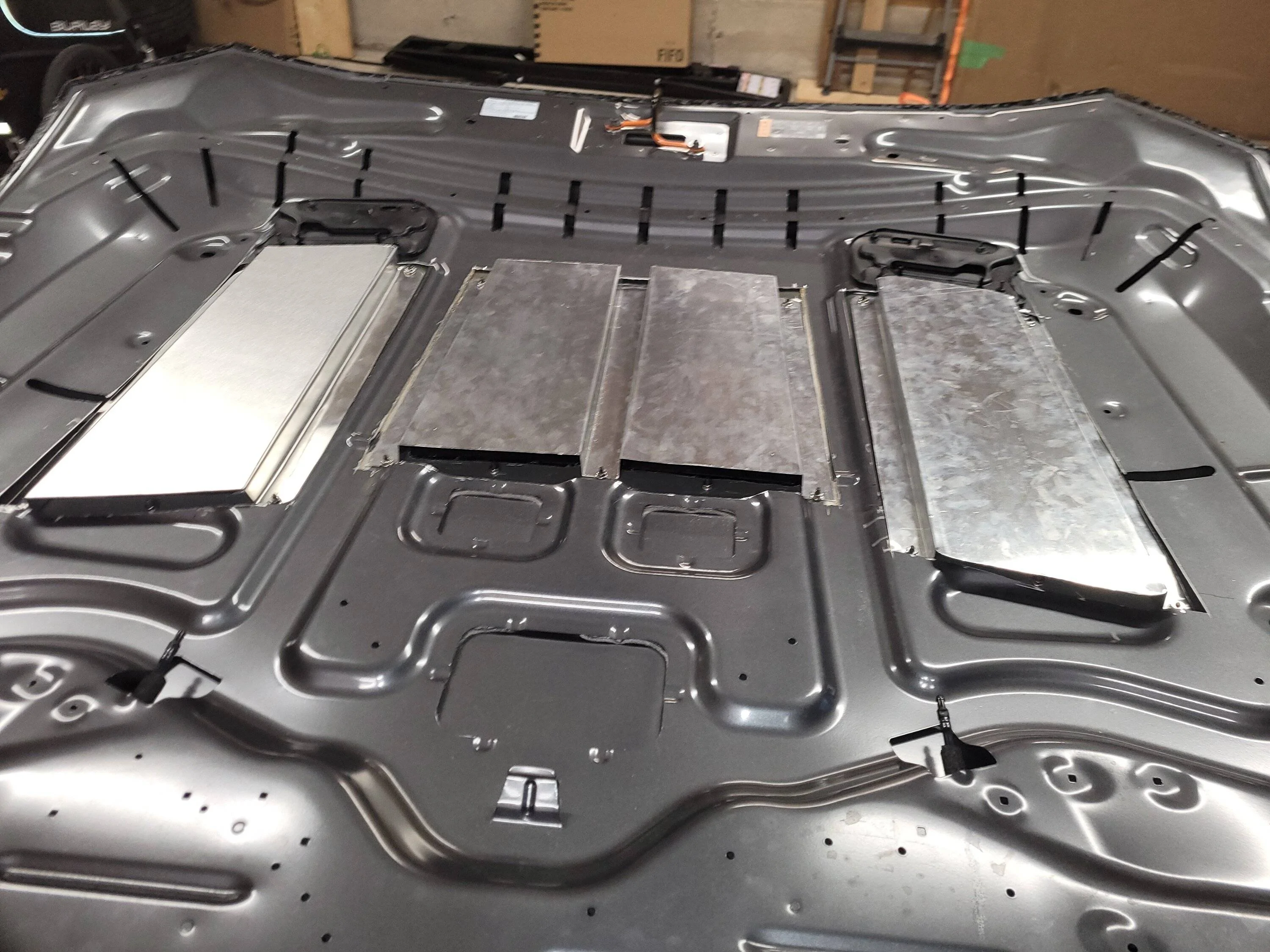

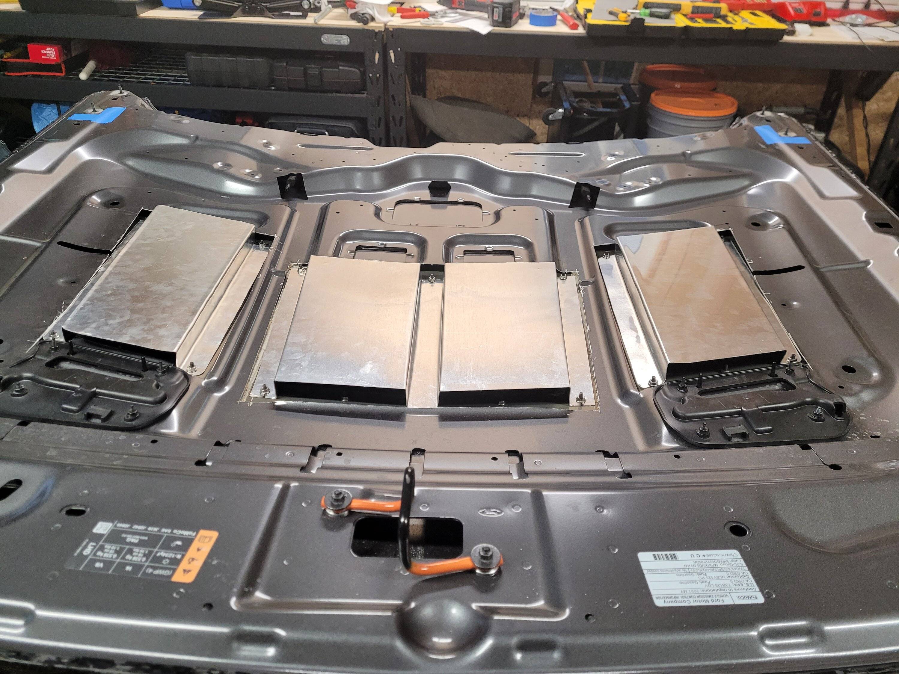

FYI https://www.mustang6g.com/forums/threads/track-time-limited-due-to-high-cht.166499/post-3611047
I am seeing massive temp drop on tracks after doing this and paired with racelouvers hood vents. I also manufactured rain trays that I can take on and off in 15 minutes from the same aluminum sheets from home depot

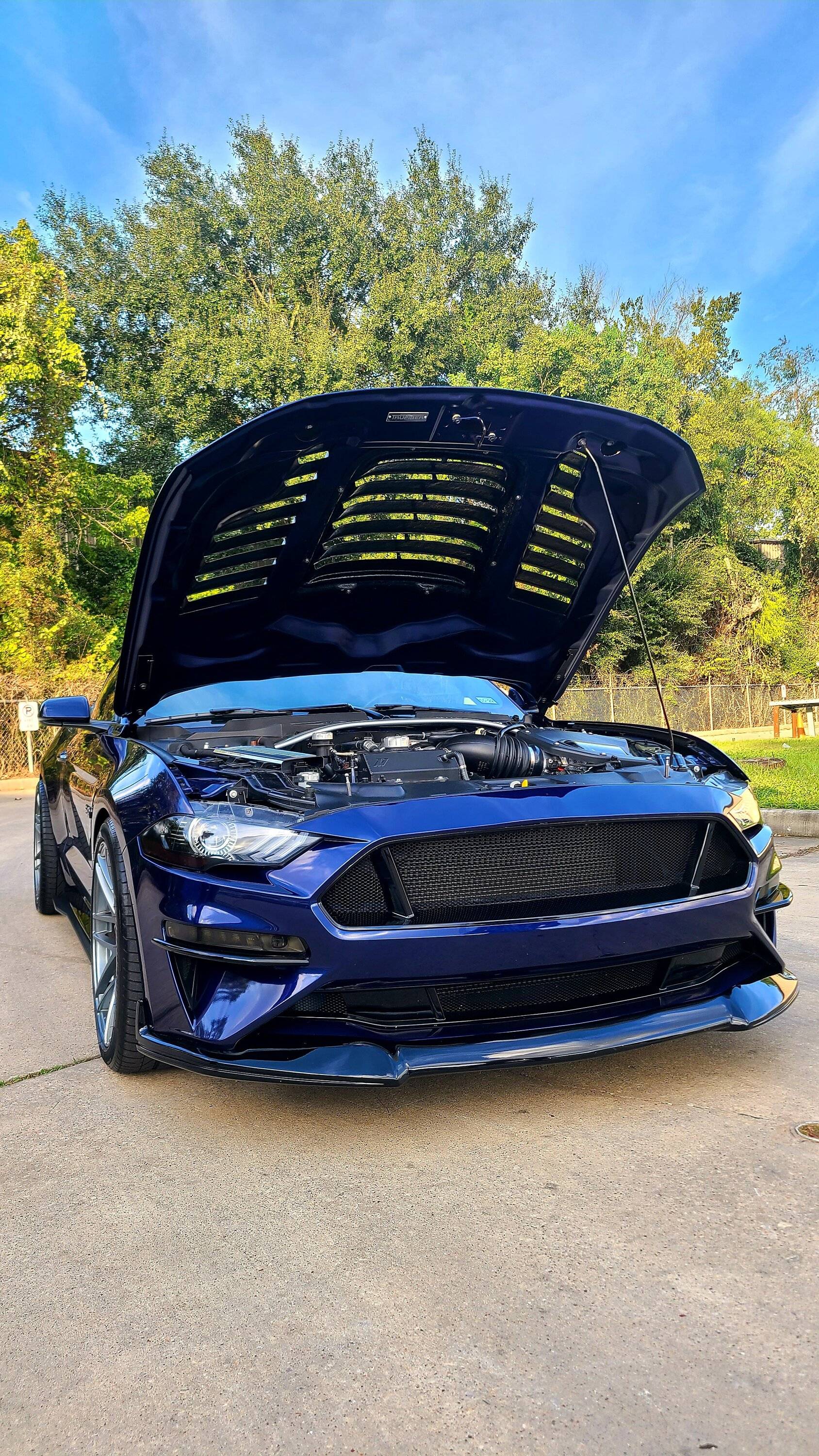

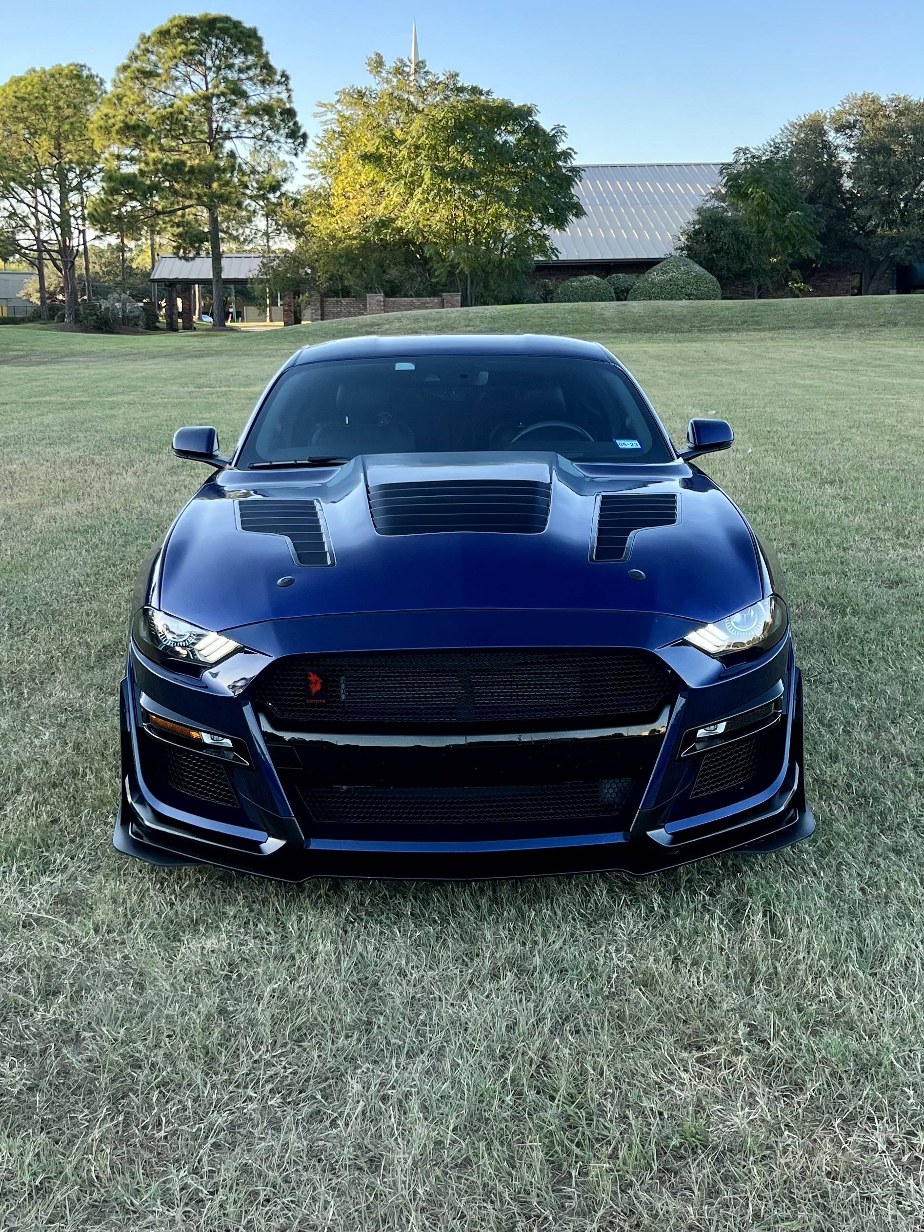

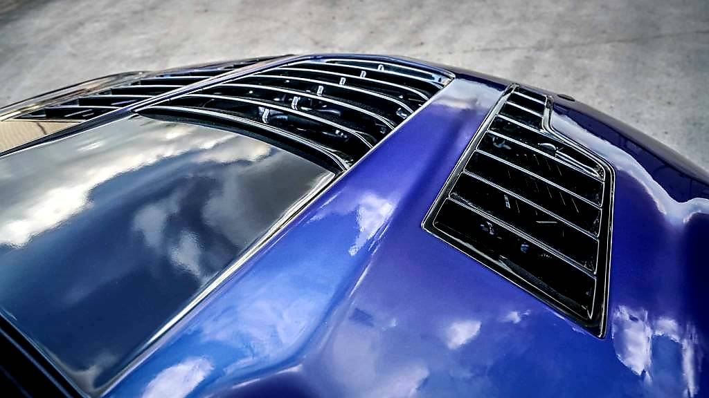

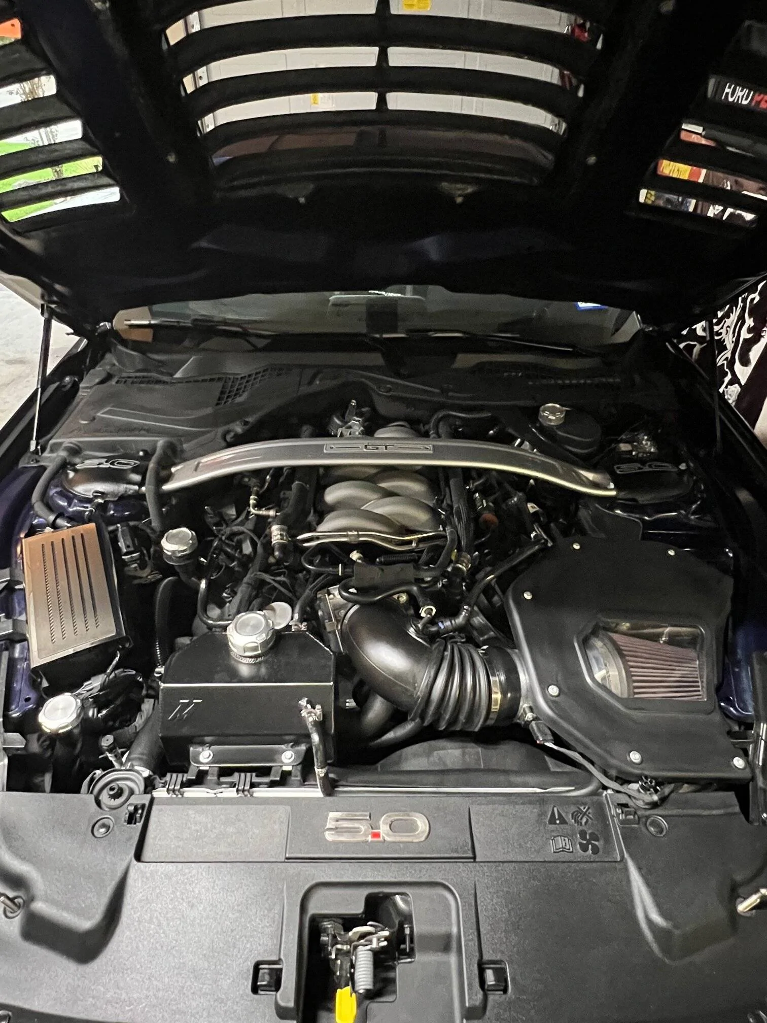

Trufiber makes a great heat-extractor hood. Its not practical for everyone but if your car isnt a daily driver and you want it for appearance and/or track purposes then I highly recommend it. They offer an optional rain guard for the main center vent but there is nothing to cover the side vents so a closed air box is essential in case you get caught in the rain. It's pretty neat to feel how much heat comes out of the vents after driving the car, they make instant hand warmers on cold days ;)

How's the strength/flex of the hood? Glad you have an extra type of hood securing device.
Wondering the same. In the first pics he’s using the prop rod but in the later pics the struts are in place indicating a pretty rigid construction I would think. I like the look of that hood.
Blu_stallion
Aug 20, 2021
203
341
Cypress, TX
Don
2020 Mustang GT PP1, 2018 F150 FX4
The strength is good and it doesn't seem to flex. It's fiberglass so it's never going to be as strong as steel or aluminum but it's been fine one year in so far. The only issue Ive had is around the area where I mounted hood pins. On one side I over-tightened the round push button disc and it caused some small, fine cracking in the paint & fiberglass in that immediate area. Other than that, only other issue is I had MMD hood struts with my factory hood and for some reason I couldn't get the new hood to sit flush with the fenders with those hood struts mounted, so first I removed them and everything was fine. But I wanted hood struts back on so I tried the Ford Performance hood struts which are orientated differently than the MMD ones, and the hood aligns perfectly with them so I'm happy.
Yes, per my other response strength has been good and no real issues. Good observation on the prop rod versus struts. So I had MMD hood struts in place with my factory hood and for some reason I couldn't get the new hood to sit flush with the fenders with those hood struts mounted. So first I removed the struts and everything was fine, that's where you see the photo showing the prop rod. But I wanted hood struts back on since I do a lot of car meets so I tried the Ford Performance hood struts which are orientated differently than the MMD ones, and the hood aligns perfectly with them. That's where you see the hood struts (bye-bye hood prop, I hate those things, lol).
