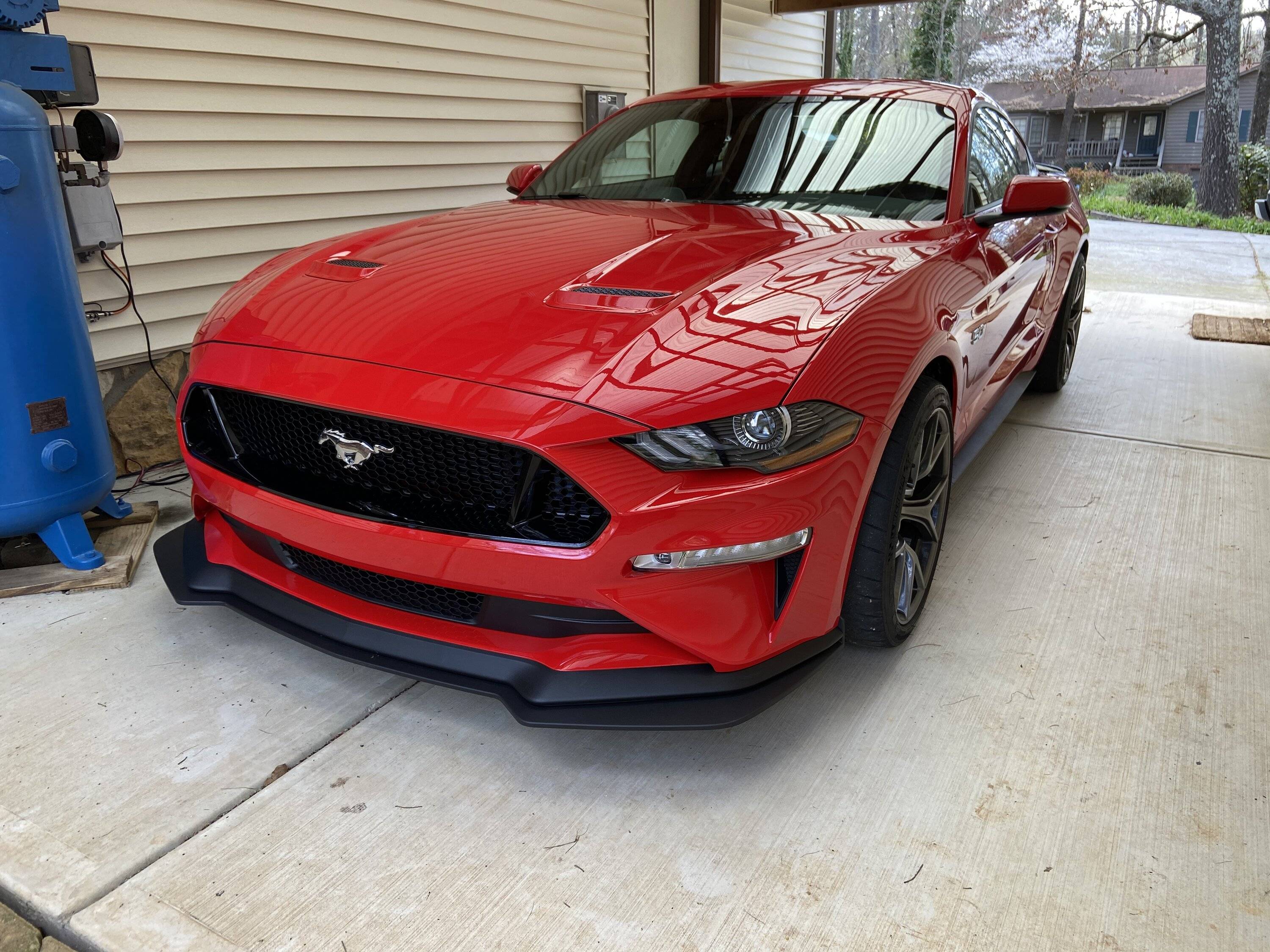

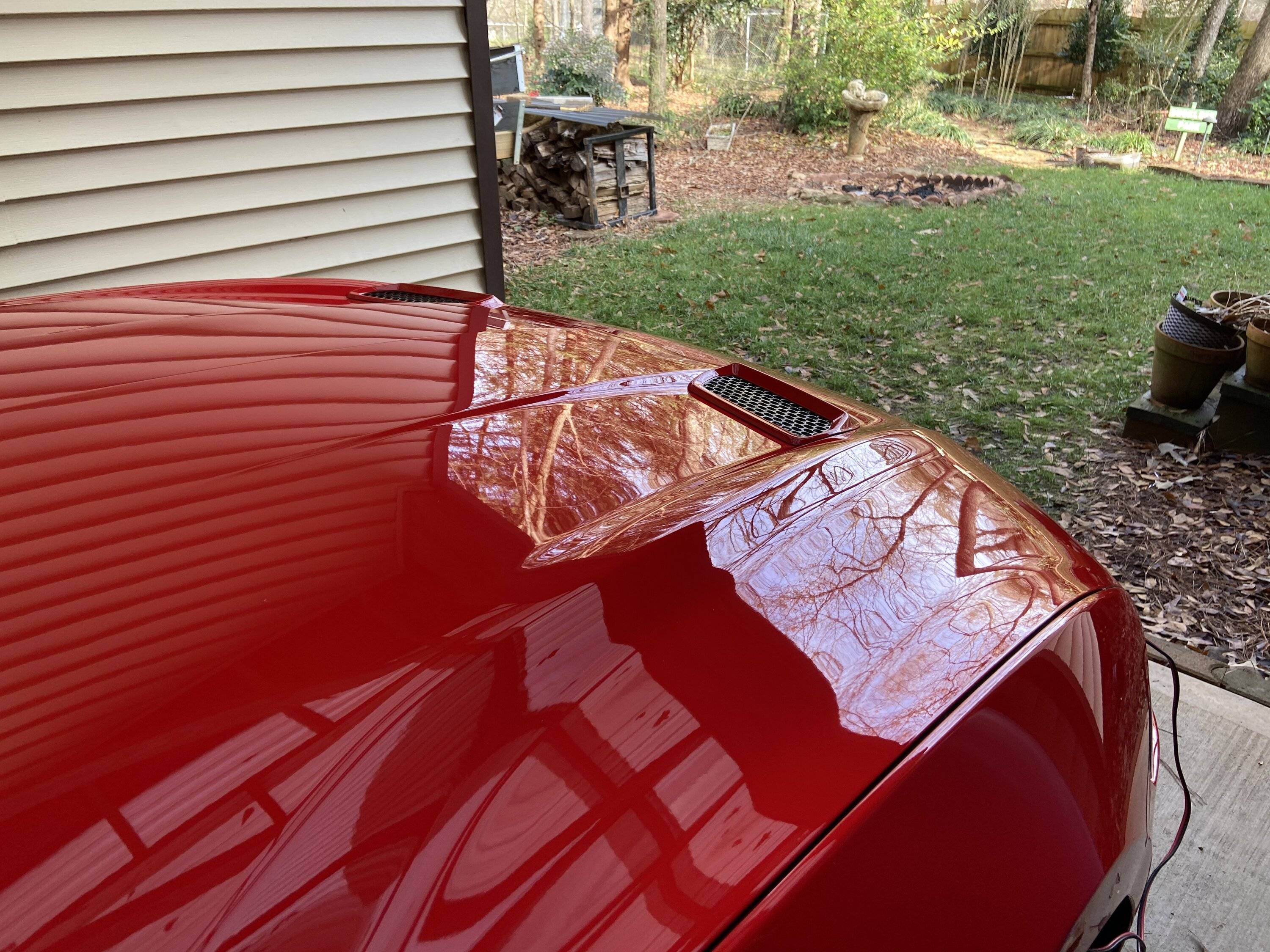

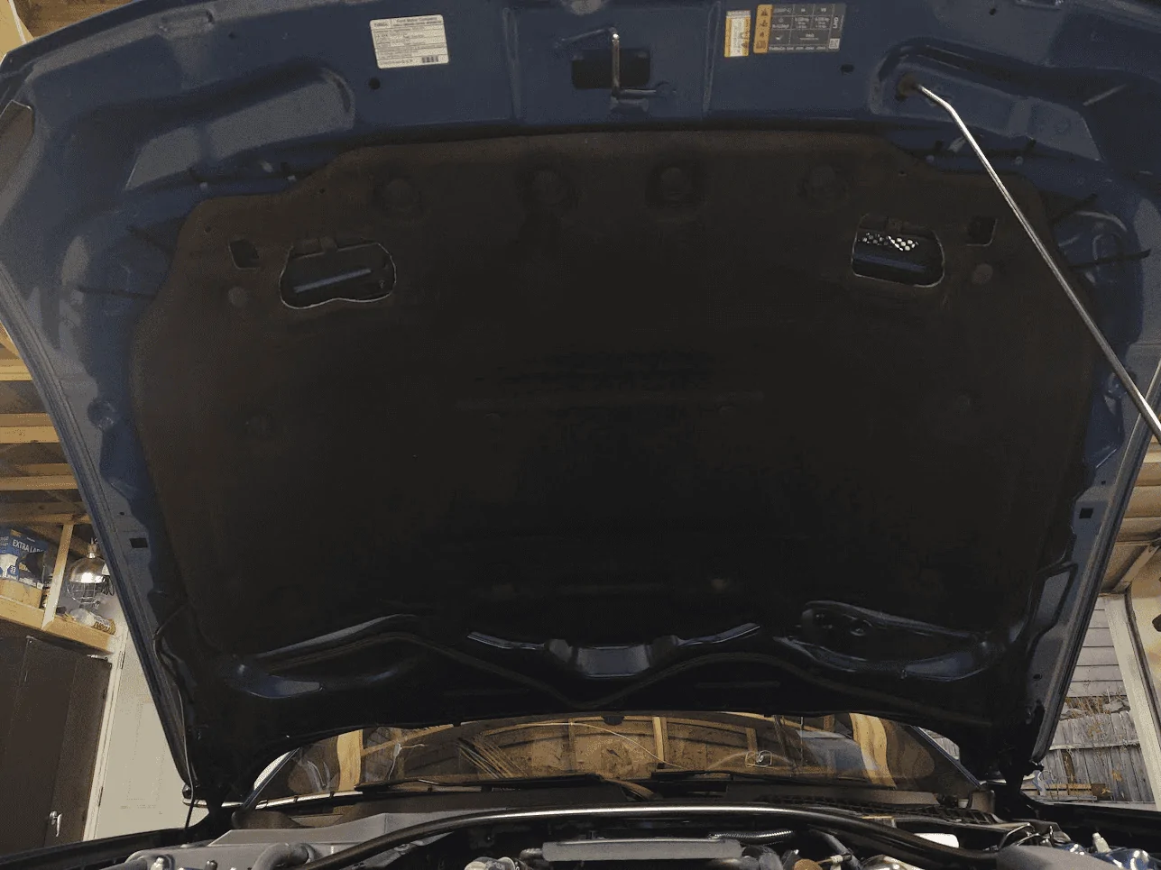

I'm trying to avoid mods but I saw no reason to not do this. at some point opening up that hole in the hood on each side would probably let a lot of heat out but i'm not ready to cut up a new car yet :D

If you like the way it looks fine but don't bother otherwise. That design will disrupt air flow over the hood and not let the heat out as easily a a flat set of louvers.
I don't see a bit of functionality it that whatsoever. The louvers need to be raked back and flat with the hood.

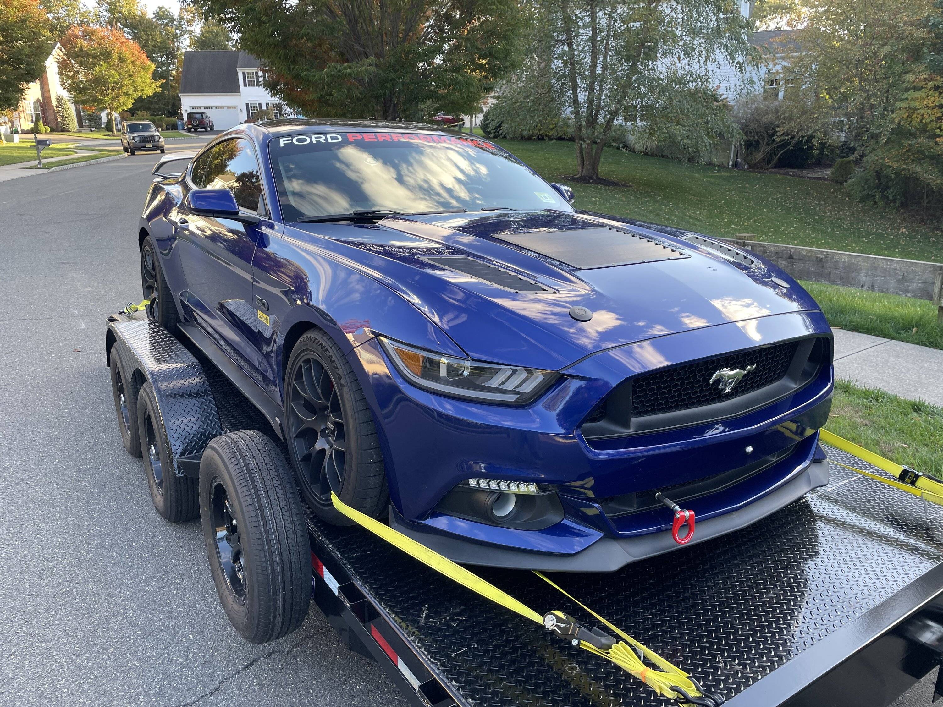

I changed out my hood vents too. I have the older roush vents, not the raised ones like on the 2020 and up models I did it to add a subtle change to the hood. Also have always liked the way those vents looked.
im a pretty big fan of the stock look, just seemed like opening it up a bit would let more heat out at idle and pull more air through at speed.

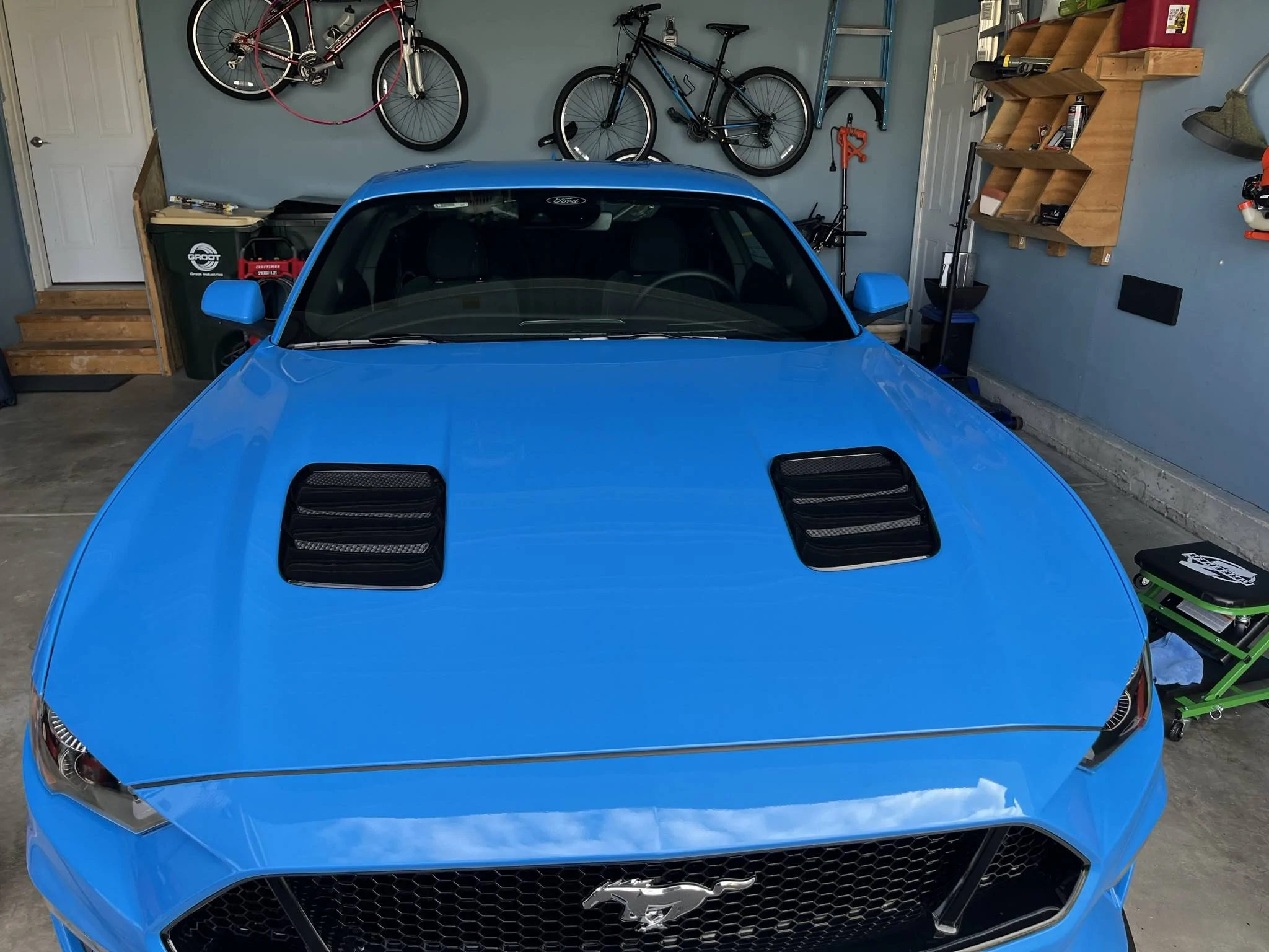

That picture is better - they don't look that unfunctional. They should pull some air across the radiator and lower engine bay temperature and pressure. You'd notice on a track day.
the vents are actually pretty big and the grills are angled such that the air moving over should pull air through pretty well.
its just the hole in the hood that is kinda small. i suspect ford did this so that we could open it up if we so desired.

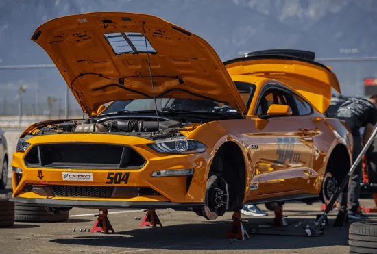

As a reference you need this much venting to get a 15 degree drop in engine bay temperature at 130mph. So yeah I agree those mini holes won’t do much but to say they won’t help move air past the radiator would be wrong too. It would just be minimal.

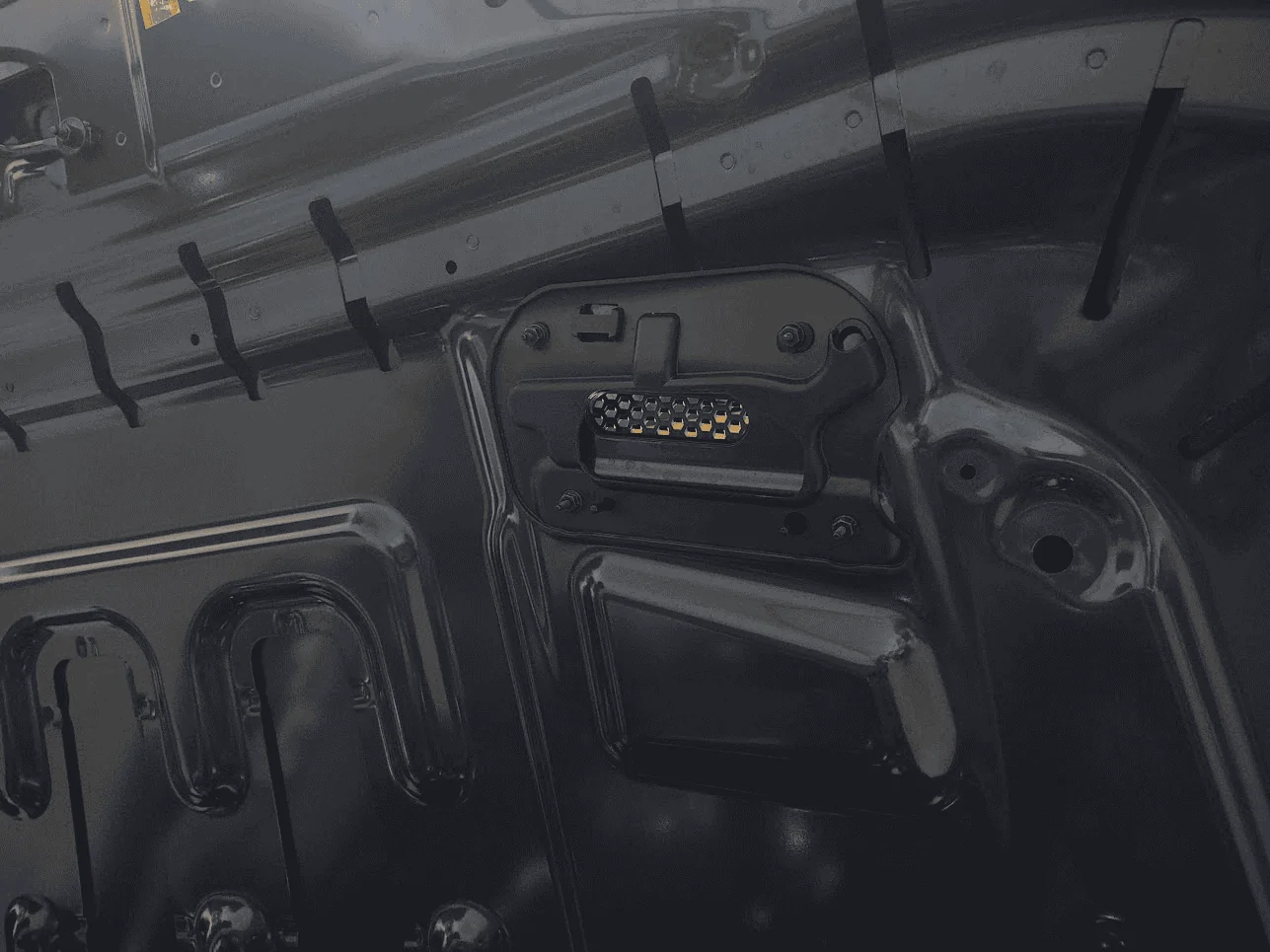

Note that on our Bullitts and probably the Shelbys too, the driver side vent is actually blocked off and closed because of the open element air filter box. Nothing to see here, carry on.

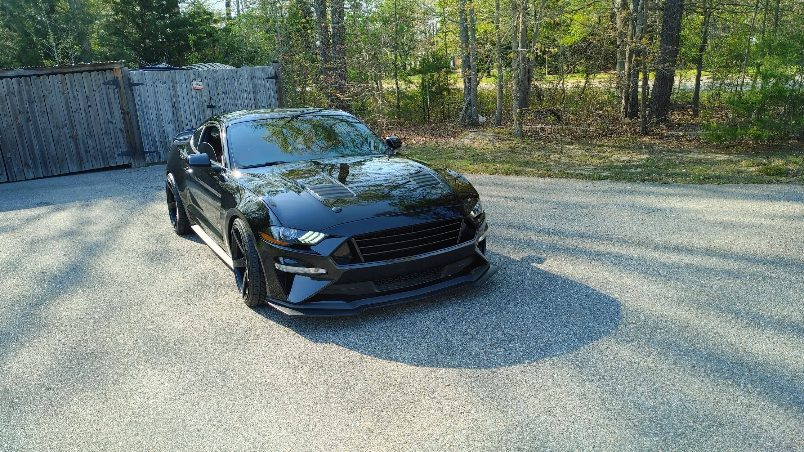

This looks like stock but has some aero improvement over the OEM. Advertised as having the front height increased, with the angle being more pronounced. Resulting in a lower pressure behind it, pulling more air out of the bay.
That's what they say, the theory sounds correct, but have no hard evidence.
They are subtle and more aggressive than the factory.
adding link & no I don't have any skin in the game
https://www.rtrvehicles.com/products/rtr-hood-vents-18-20

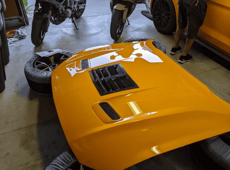

Cut that b*tch! You know you want to 😉
Write up I did for cutting the hood.
I checked out your threads and we are very similar but I'm just behind you on progression. The thread on cooling issues at 90 degrees was puzzling. That should never happen with a heat extraction hood in theory. This summer I ran a few HPDE days at 90+ and ran 4 sessions at 22 minutes each and never had a cooling issue.
