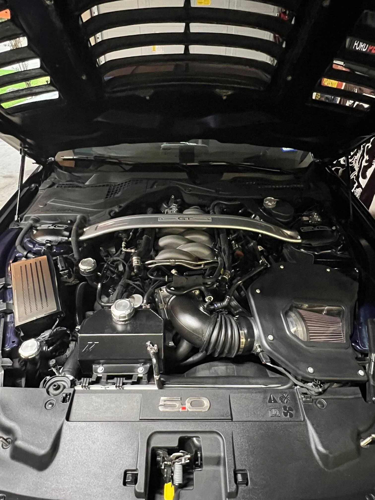

One of the main differences in hood struts is the directional orientation they mount. Some face the same direction as the open hood and others are opposite. I originally had MMD struts with my stock hood (open hood direction) and they worked fine, but when I went with an aftermarket hood I could never get the hood to sit flush with the fenders and I knew the hood wasnt the culprit. I finally installed Ford Performance hood struts (which face opposite direction of open hood) and for whatever reason that solved my hood fitment issue. The FP struts work great and look good. Here's a pic, thought I had a better close up shot of the struts but couldnt find it.
