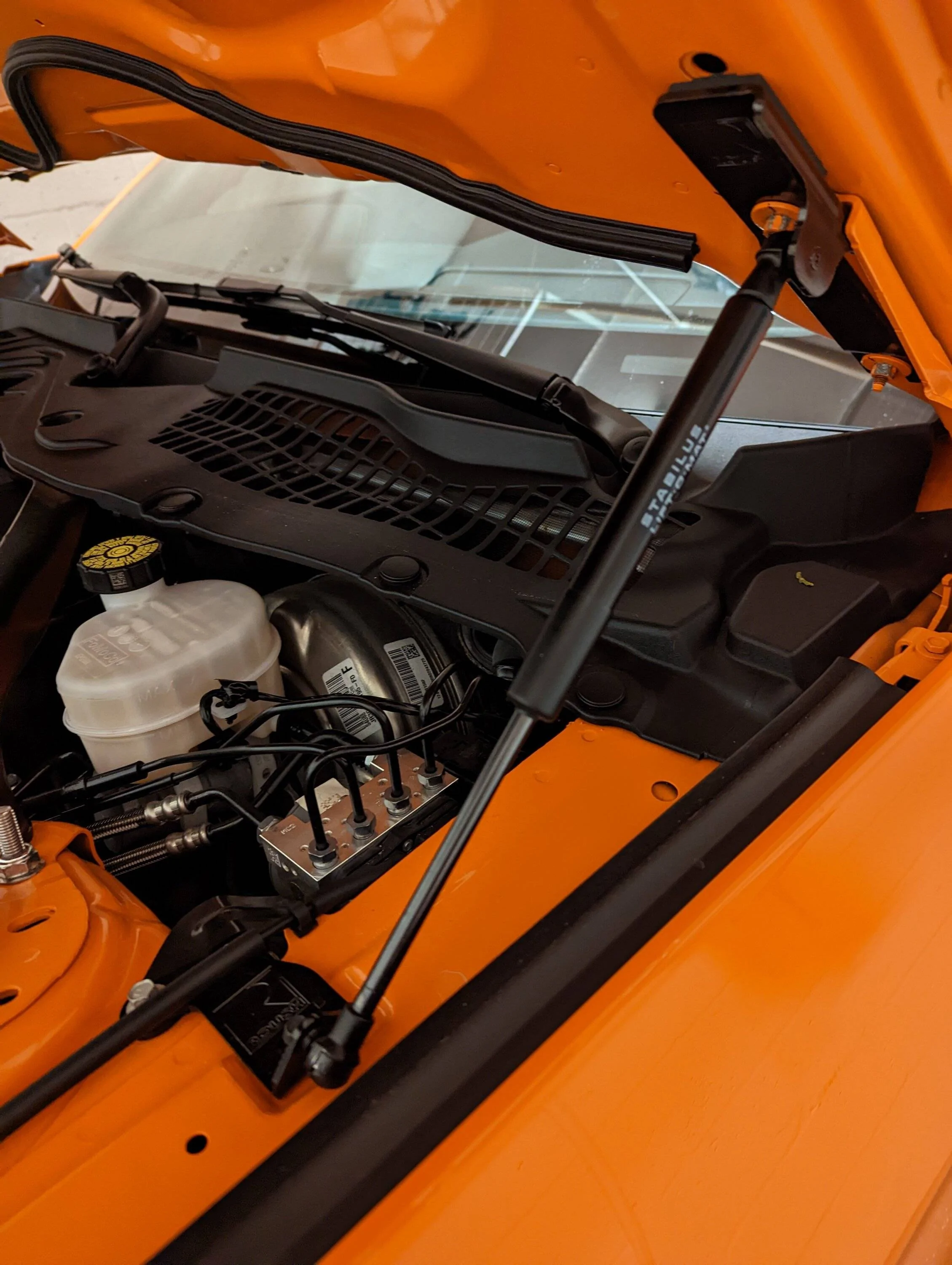

Looks like the ball studs on the bottom face out and the hood ball studs face in. Make sure the pistons are on top (closer to the hood) or they won’t function properly

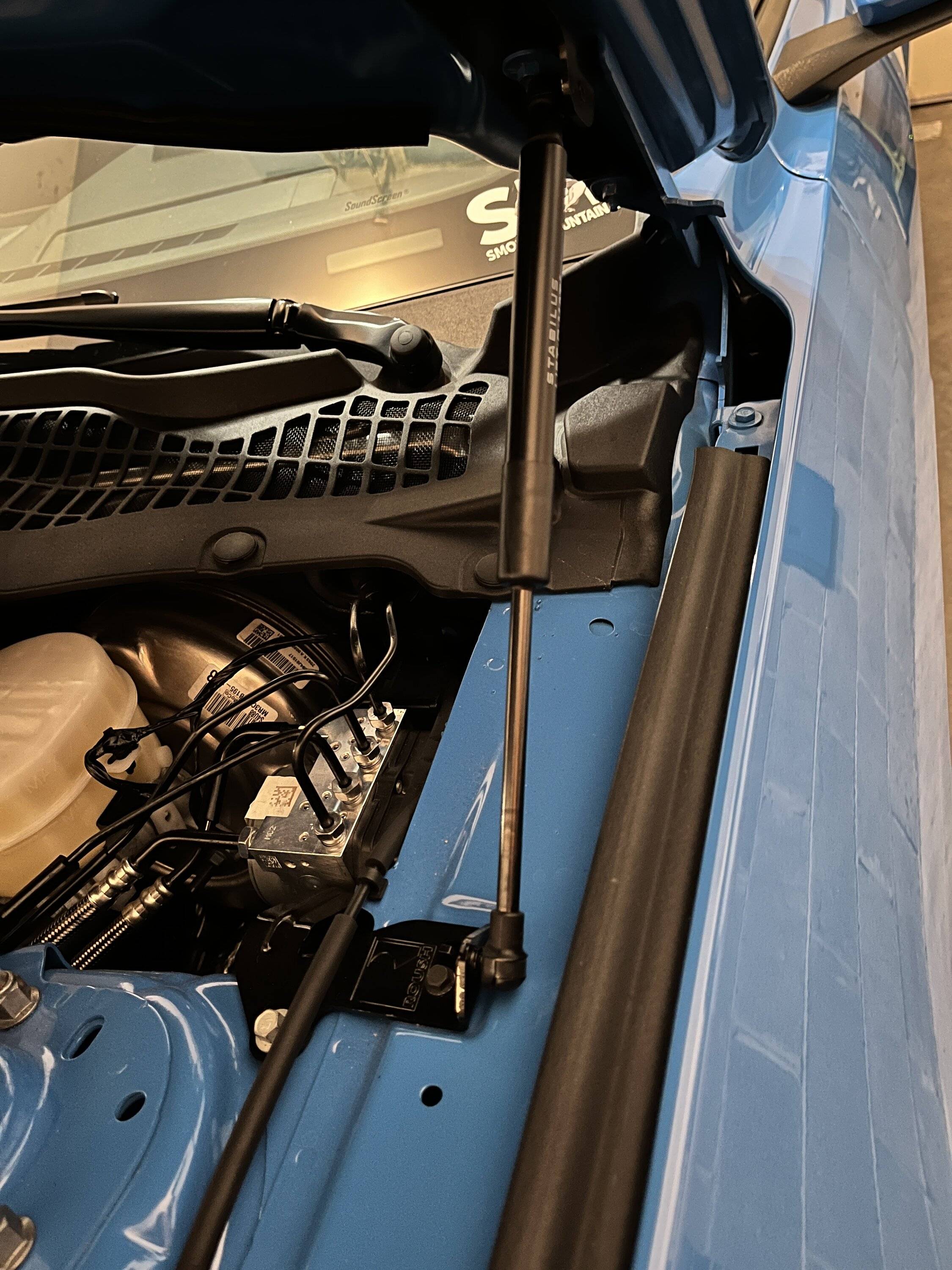

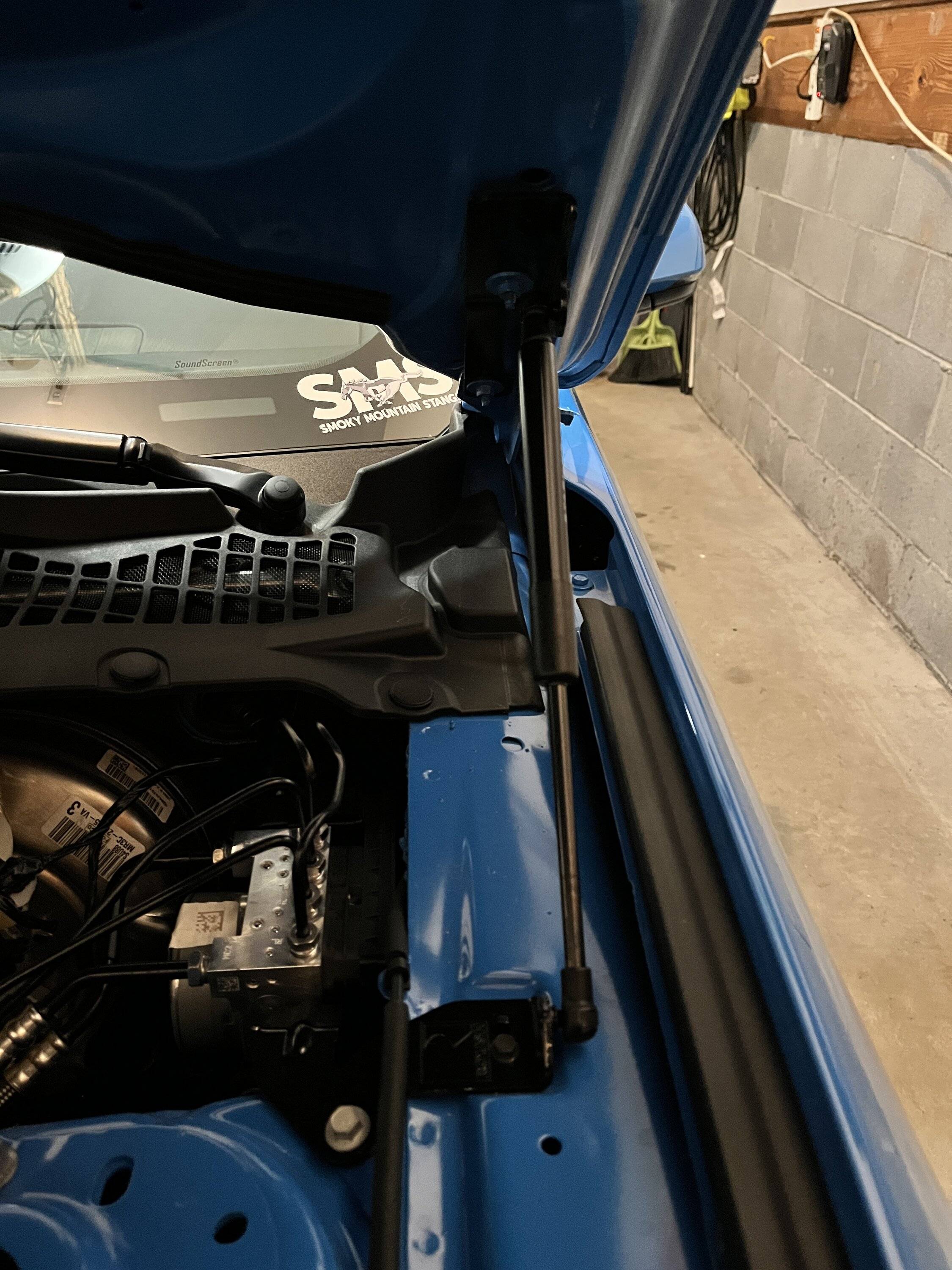

You made me curious so I went out in the garage and took a look. Kinda dark under the hood but I got a couple snap shots. Definite the bottom ball faces out and the top one faces in. Mine have been flawless and work beautiful. Mine were a little stiff at first but loosened up a little once I opened a few times.

Really appreciate you checking for me. Mine are setup like yours. Im just glad i didnt bend my hood. It stays up no problem...haha

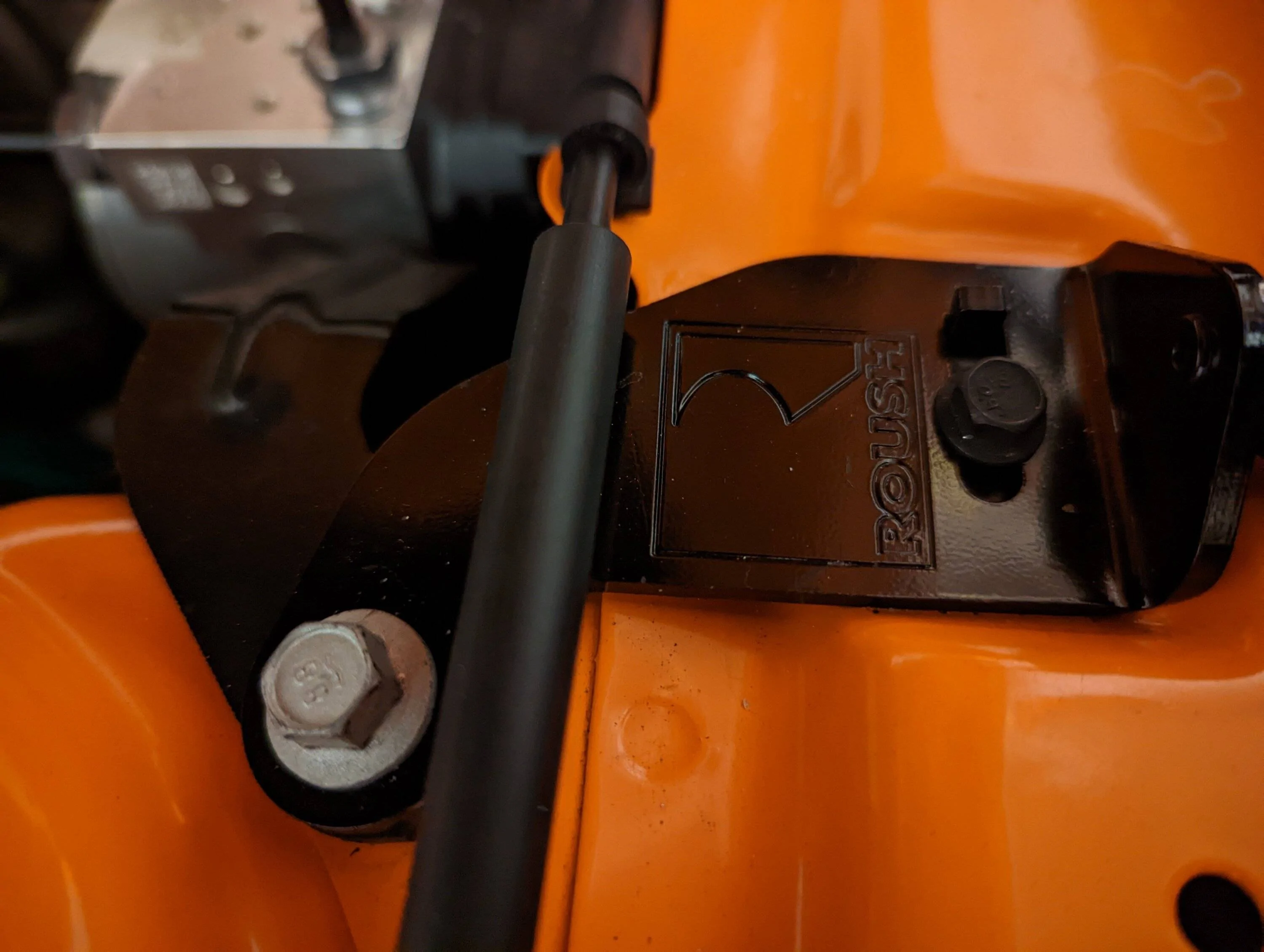

I really like everything from Steeda... BUT I went with Roush for the hood struts liked the design better. NO MORE HOOD BUFFETING

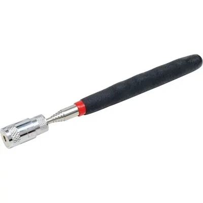

Damn it! I hate when that happens. maybe this would come in handy.
I have two of those. However not sure it will follow the fender line. How will i know if it attaches.
