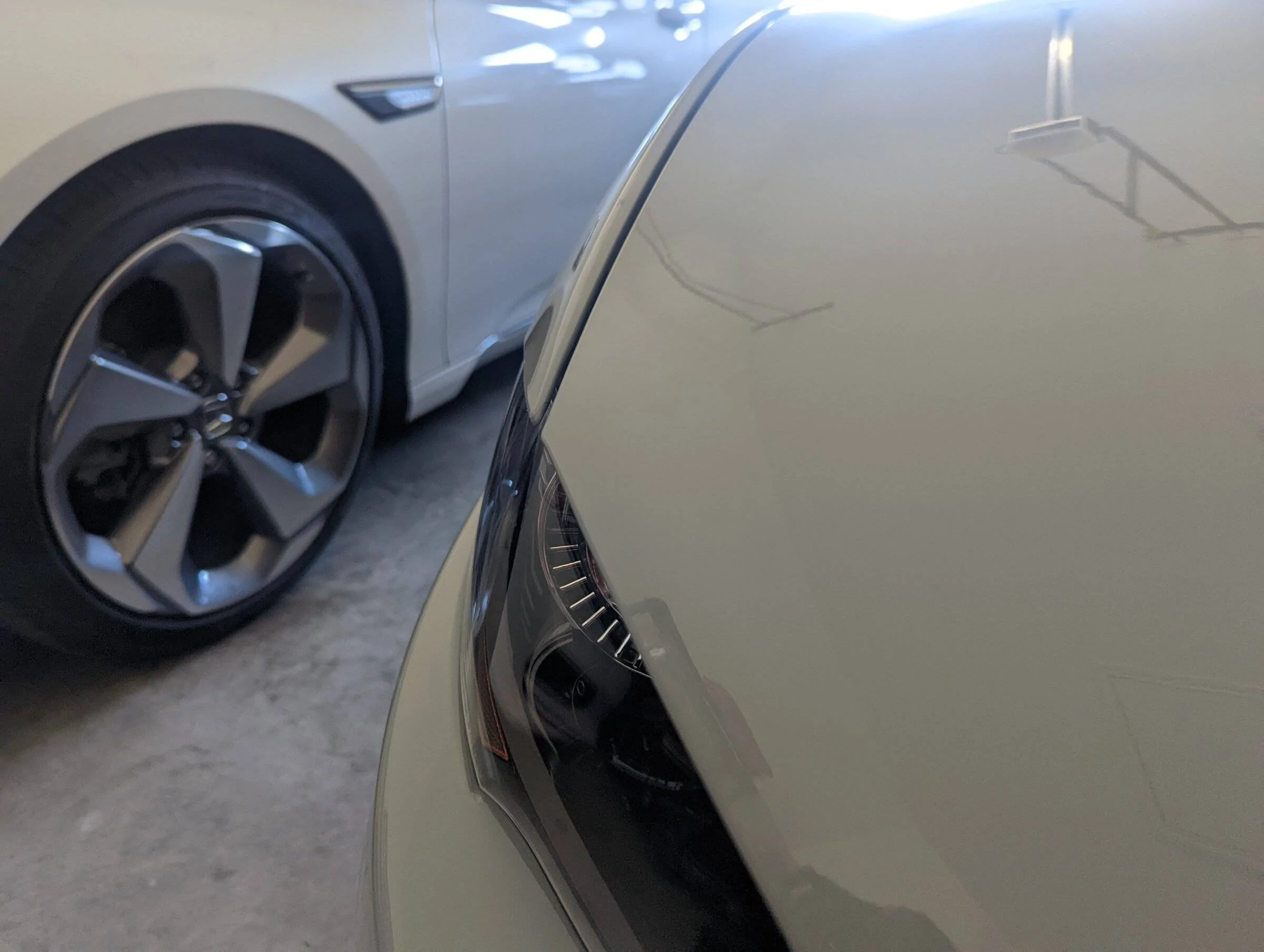

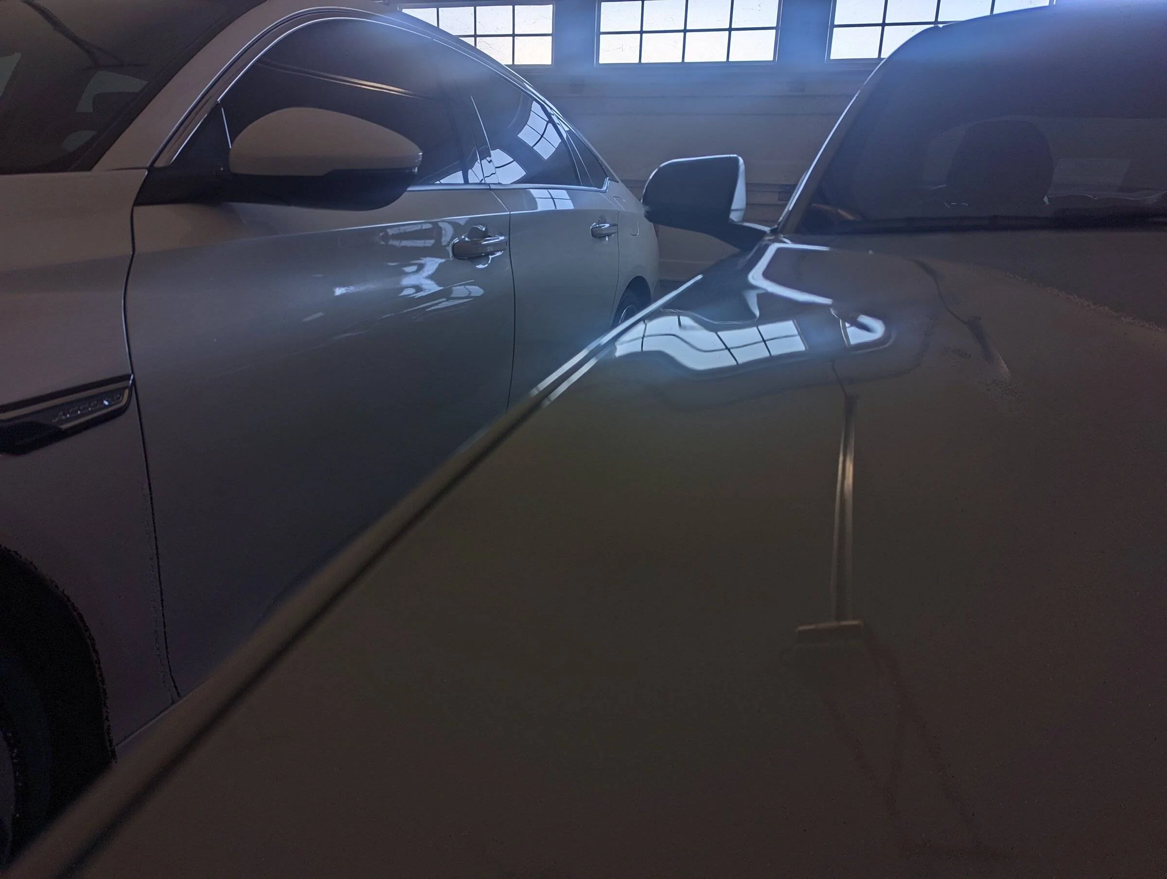

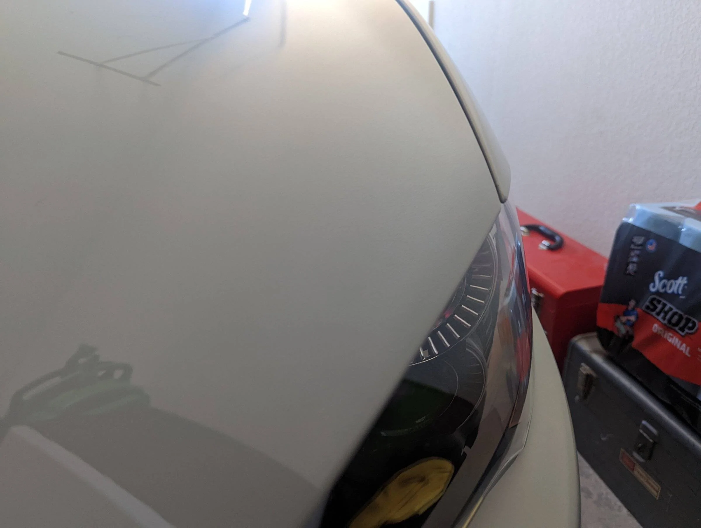

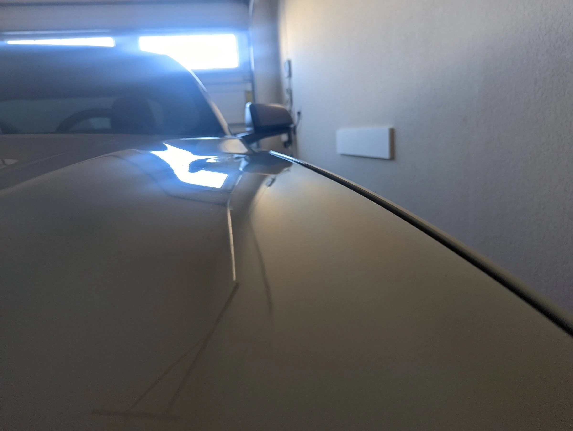

I'm on my second set of hood struts since the Ford Performance ones are junk with the brackets. I've got Redlines on and I can't get my hood even on both sides. I've loosened the hood bolts at the hinges and adjusted the hood front to back. Both sides and the front all measure the same gap. The driver side sits lower than the passenger side. If I adjust the rubber bumpers in the front, it raises the hood some but then becomes uneven by the headlights when I do that. I removed the hood strut on the driver's side and it lines up better. Should I adjust the hood latch to fix this? Not really seeing another way to adjust the hood up or down on each side aside from the rubber bumpers on the front. I checked the redline brackets and everything looks good and it's all straightened and tight. Not sure if there's something weird about the driver's side bracket. Here are some pictures:
Driver's side:
Passenger side:

I have the same issue with mine. Drivers side hood sits a tad lower than the fender. Thought about using a washer to shim it up.

Where are you using the washers? Strut bracket?

It's something with the driver's side strut itself because when I remove it, the hood is fine.

are you sure on the passenger side the Washer spray hose just isn't getting caught on the rod and pushing up on the hood when you close it?
