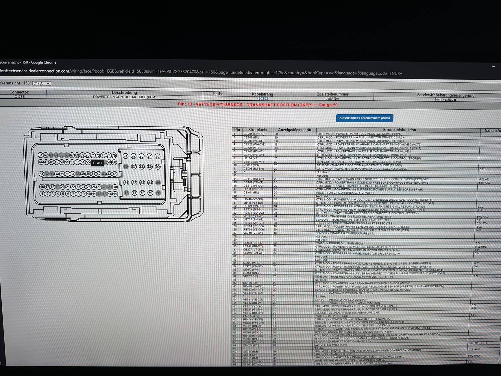

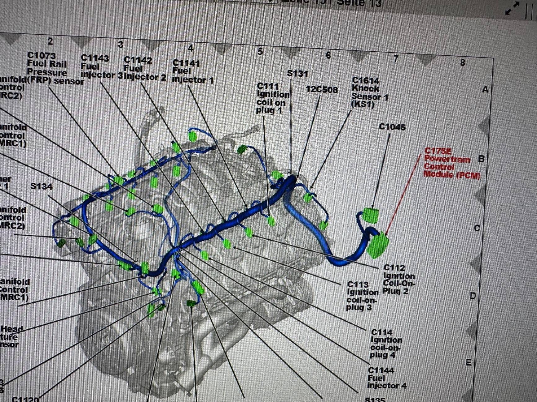

Fixed another problem today(:

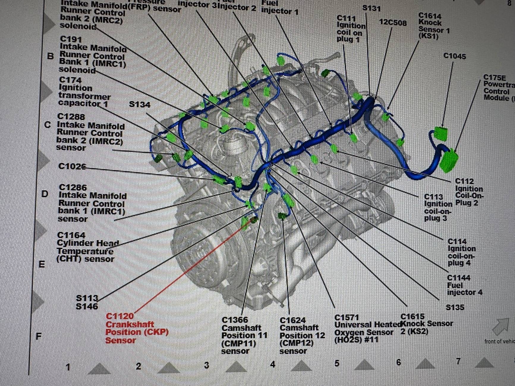

I had issues with RPM being super unstable.
Before doing the swap i was searching through this forum how to get a RPM Signal/Clean Tach out.
Everybody seemed to use coil1 neg with and without the autometer adapter.
Since mine was not really stable i thought about switching to the crankshaft sensor and it fixed the issue!
So if anyone needs a RPM signal it's pin 70 on the top pcm plug.
Next step where i'm still lost is how to reconnect the OSS Sensor and the reverse switch.
What does the OSS even do except cruise control?

I can't give explicit advice since I learned just enough to say "fuck it" and do something else, but my understanding was that the ECU uses OSS for a bunch of things - including controlling the motor at low speeds. When investigated swapping in a dog box that wouldn't have a compatible speed sensor, I was told that I would have to use a control pack ECU for an auto since it doesn't require the OSS. Not sure if that's compatible with the rest of the Ford system, tho.
You'll probably have the most success figuring out a way to replicate it.

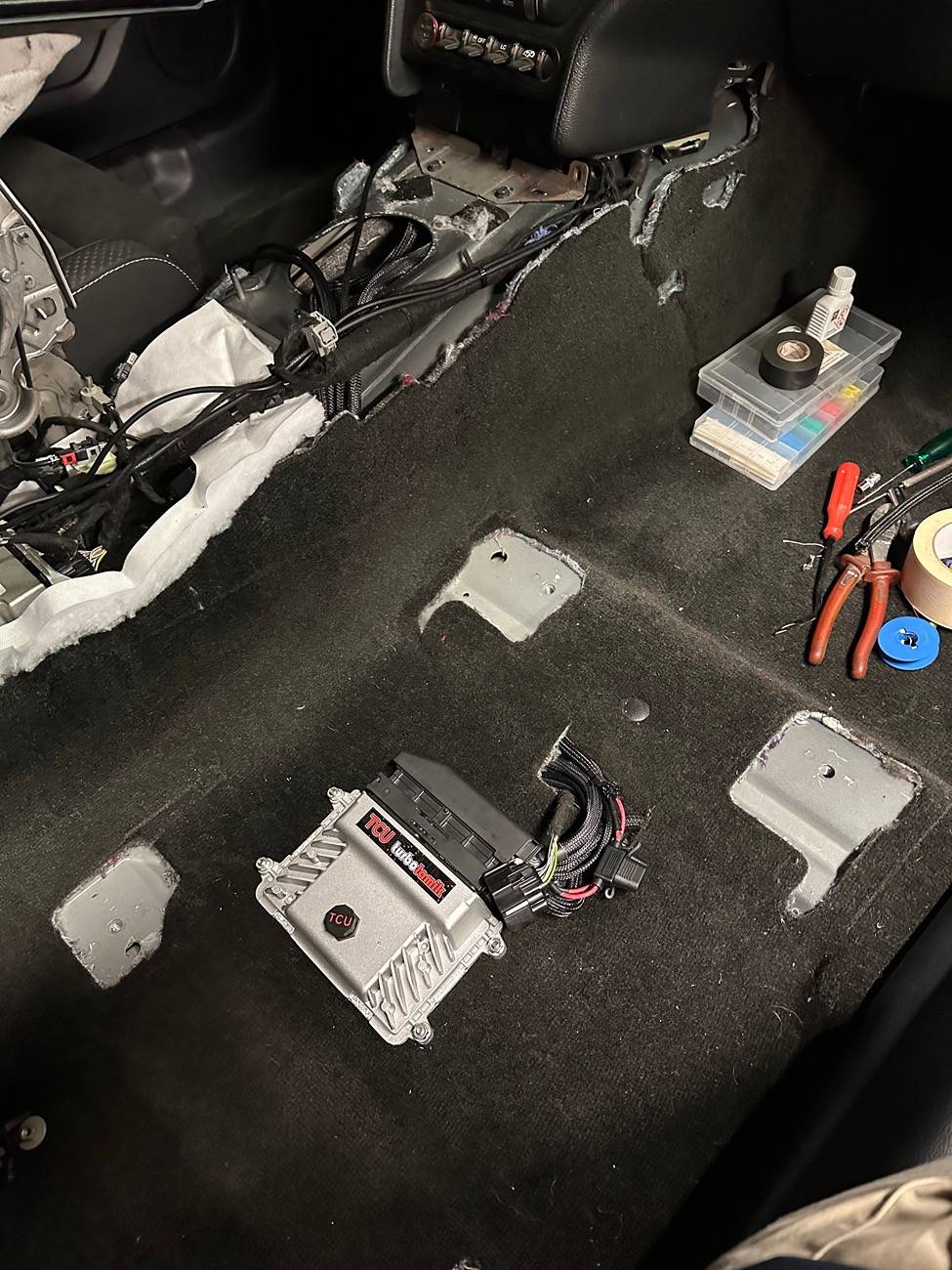

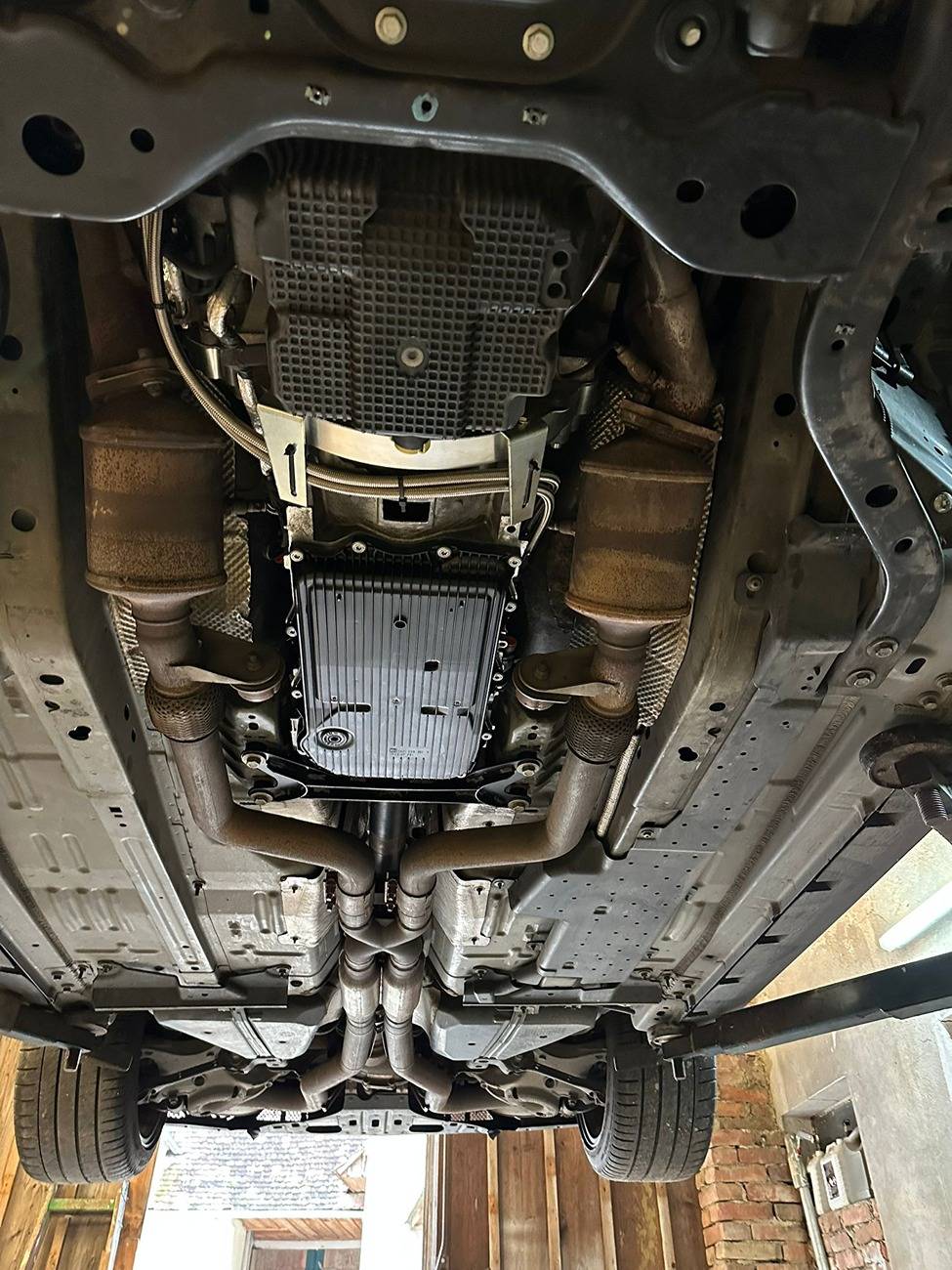

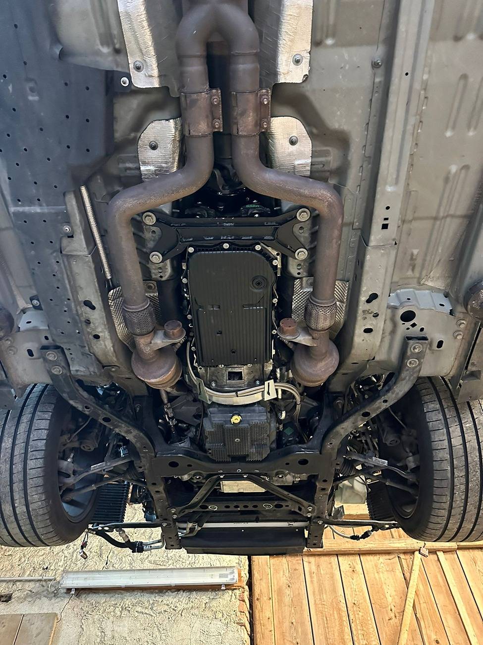

Underneath the Car its mostly done. Interior is still a wire mess but thats a issue for another day.
Shifting from 2 to 3 gear is still harsh but considering there was still no adaptation and the gearbox isn't really configured to my car all the other gears shift nicely so far.
I had 2 awful noises last test drive but we fixed them.
First noise was low oil in the gearbox itself because the fill procedure is quite something on the zf8.
Second noise was the starter was catching in gear by 0.5 mm on the top surface. Fixed it with a spacer.

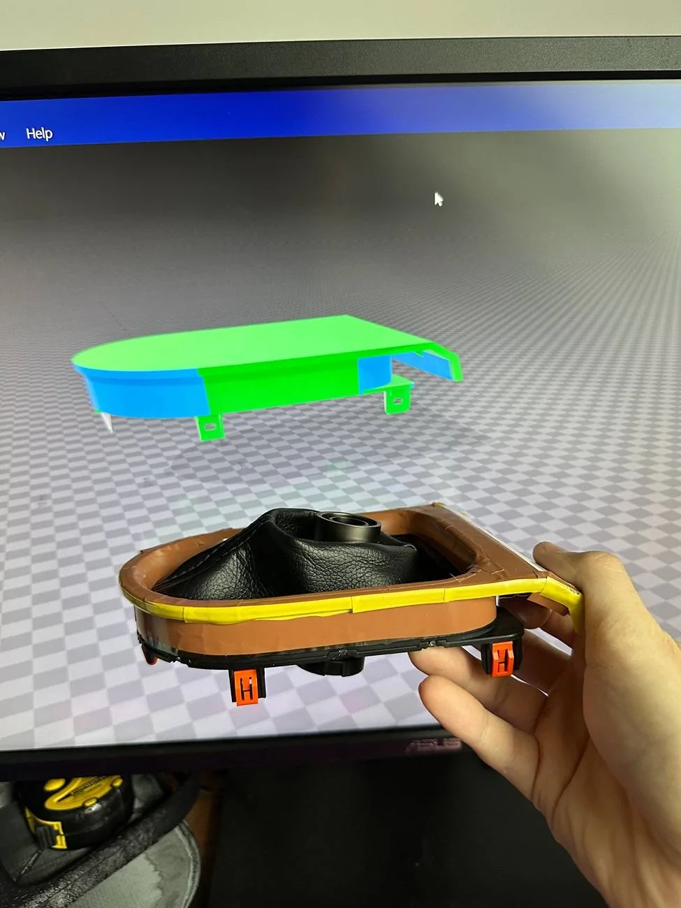

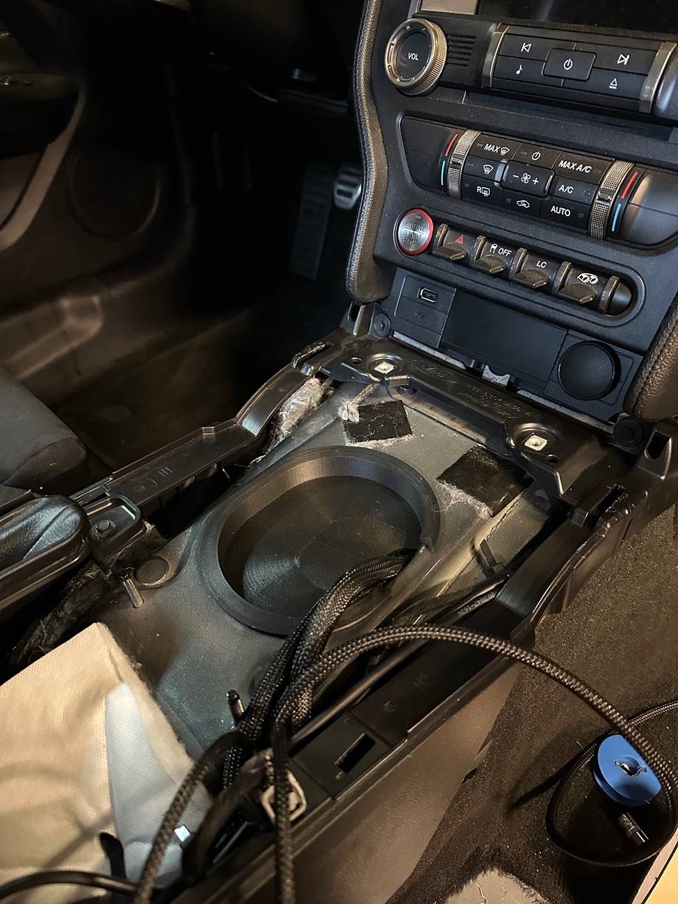

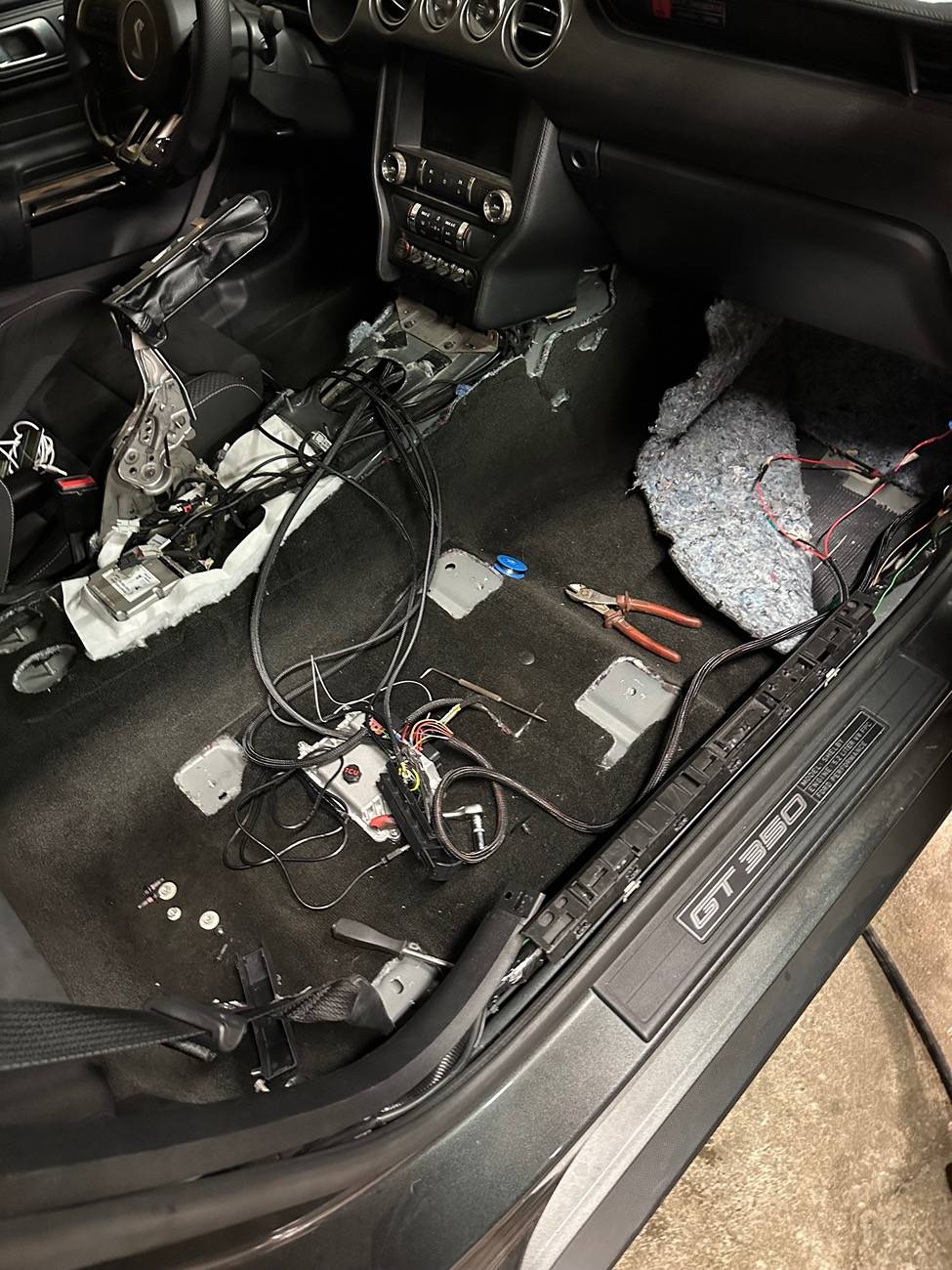

Wires are now mostly done :)
Shifter integration is harder than i thought and i will probably ditch the BMW shifter for the can keyboard.
To integrate the Bmw shifter i would need to cut away either the center console plastic or the sheet metal but i wanna keep everything reversible.
