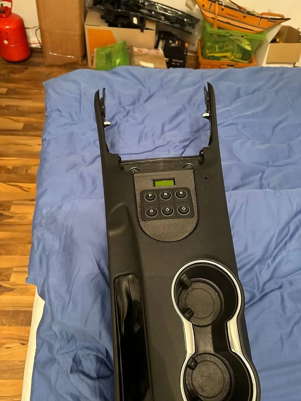

Wires are now mostly done :)

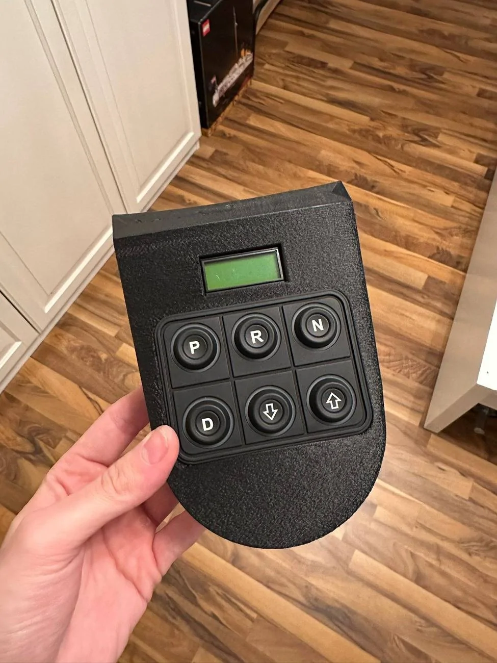

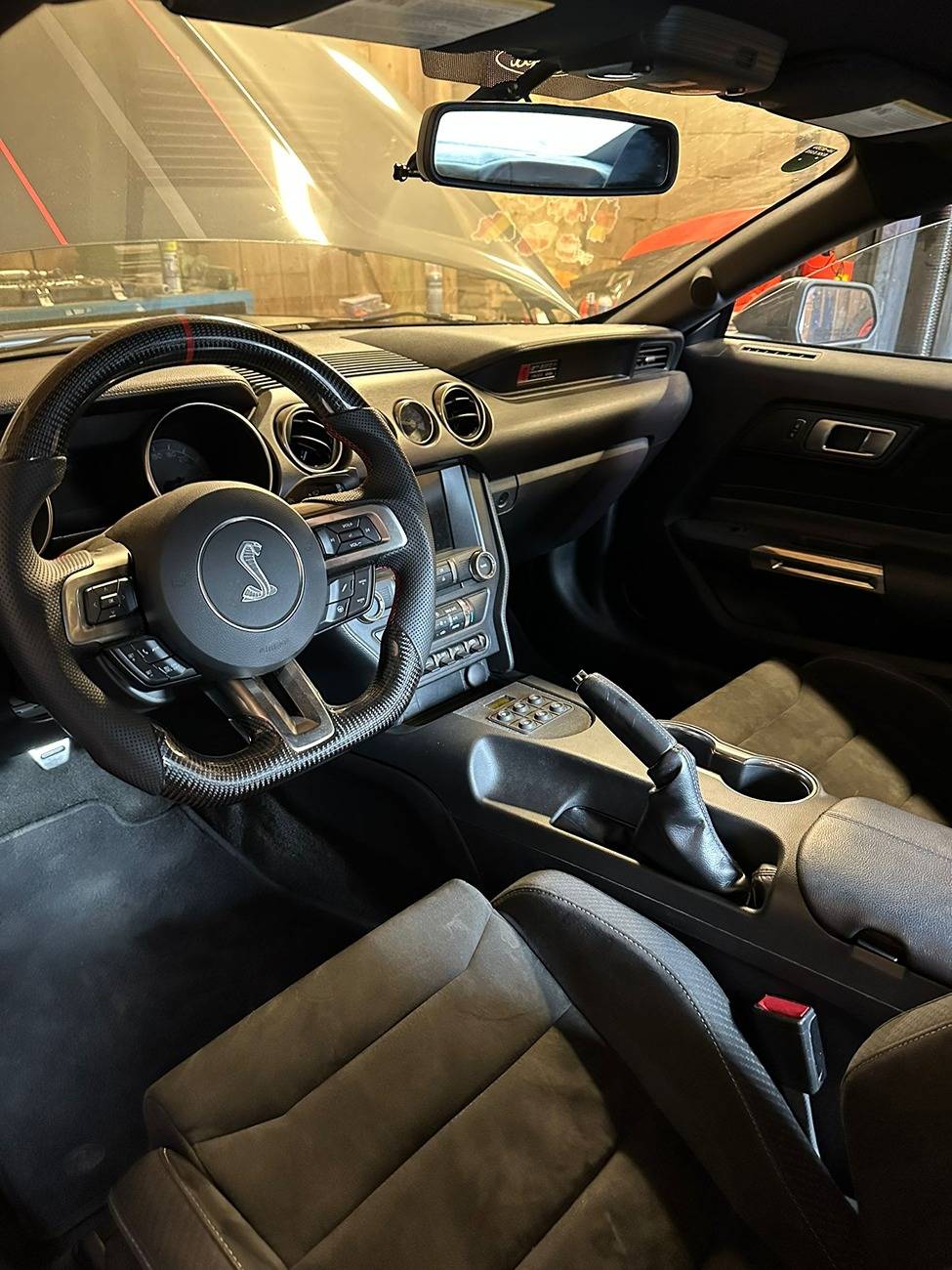

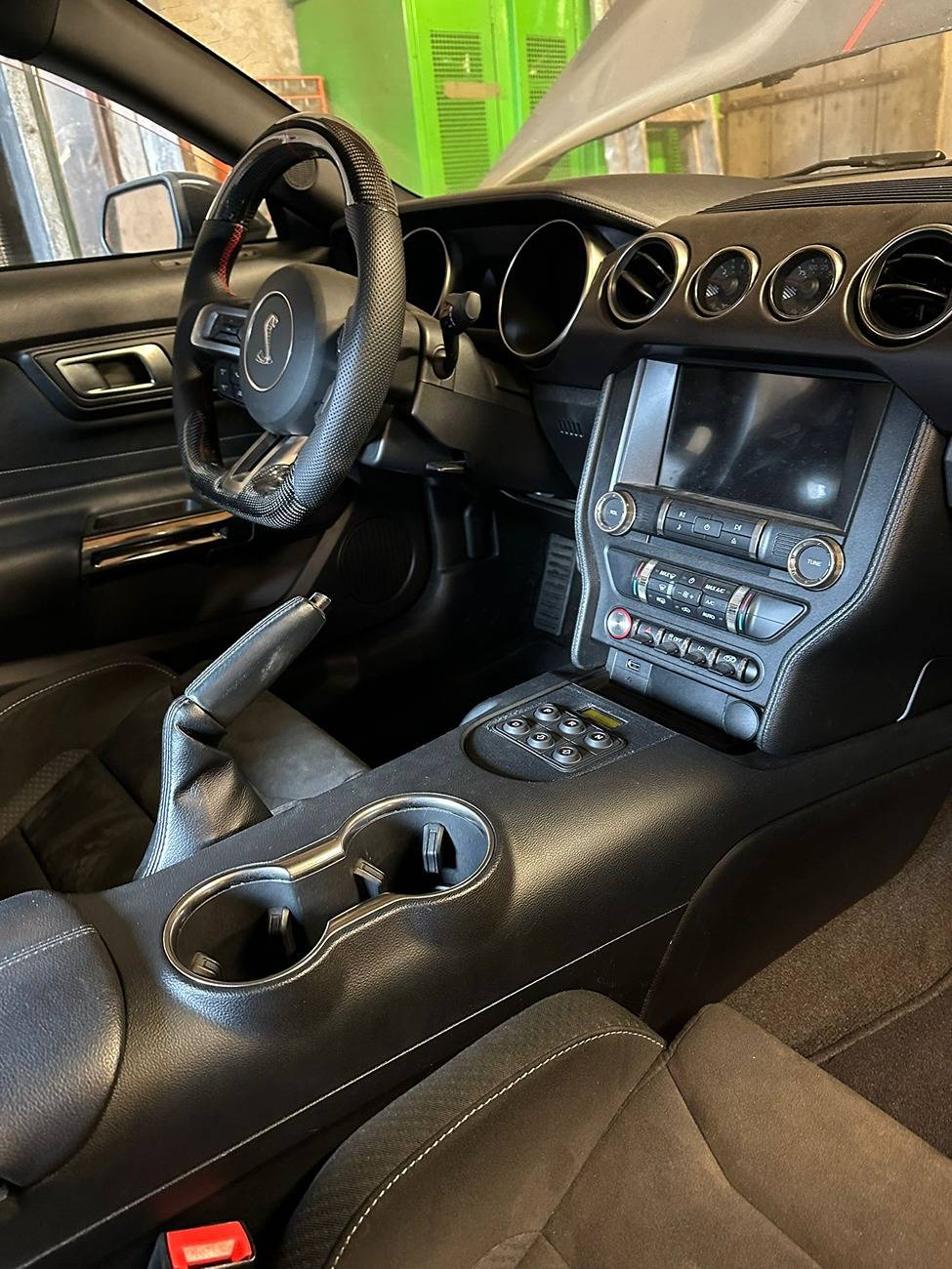

Shifter integration is harder than i thought and i will probably ditch the BMW shifter for the can keyboard.
To integrate the Bmw shifter i would need to cut away either the center console plastic or the sheet metal but i wanna keep everything reversible.
For the shifter you could always buy a center console out of a parts car to cut up and modify. Then you can keep yours fully intact for reversibility.

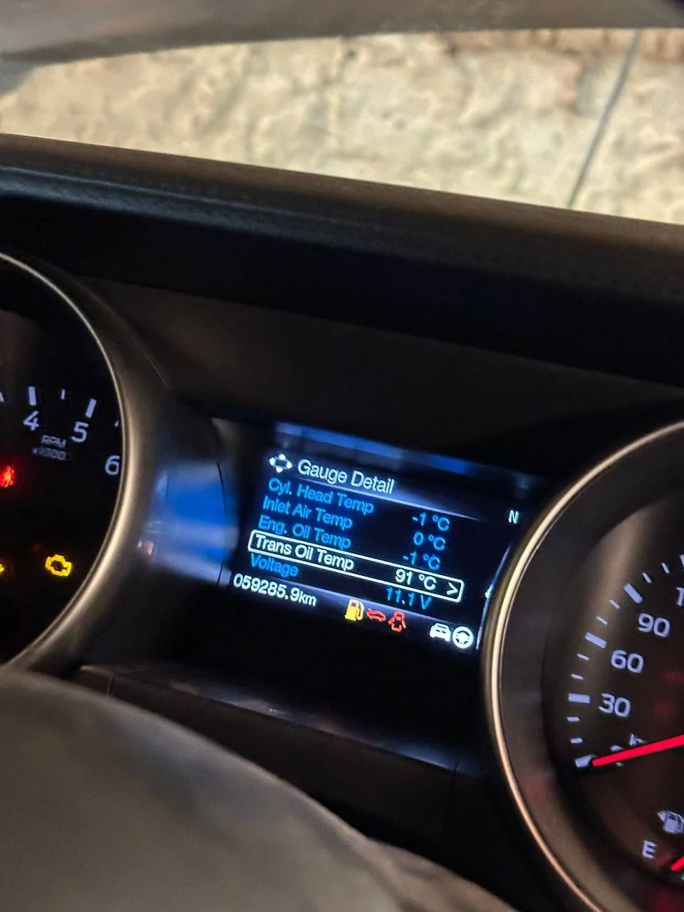

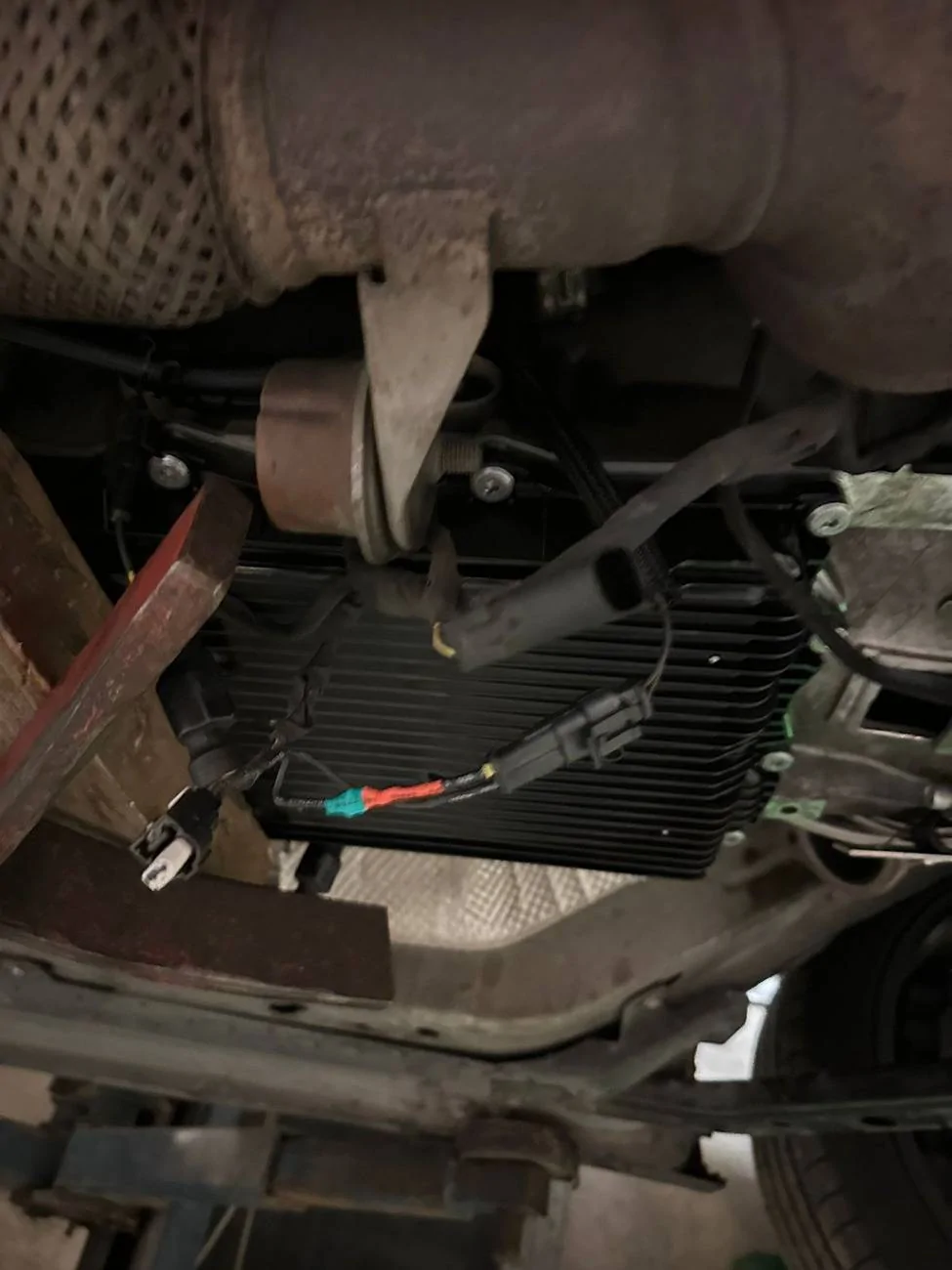

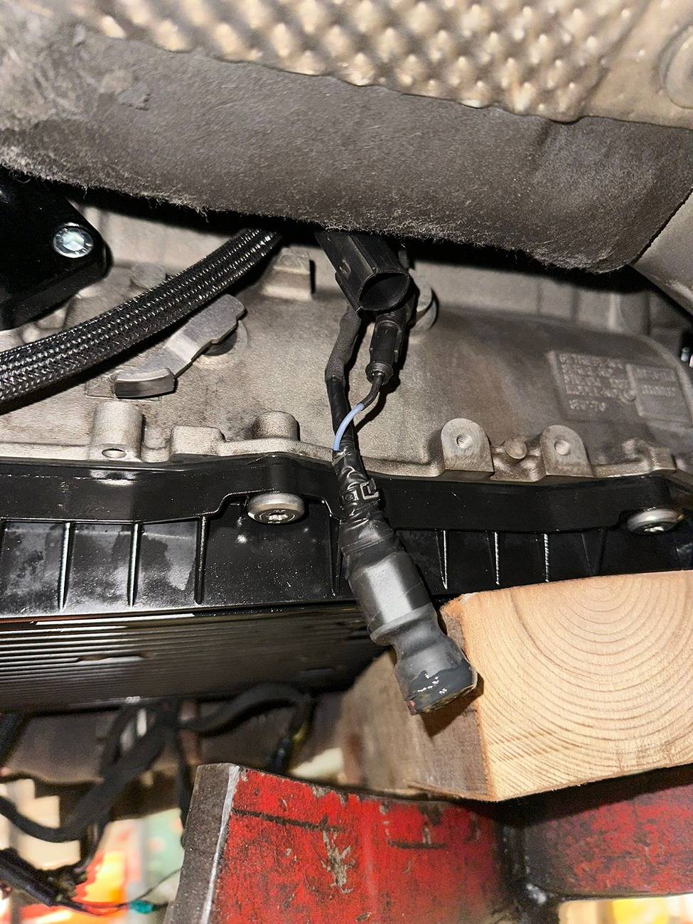

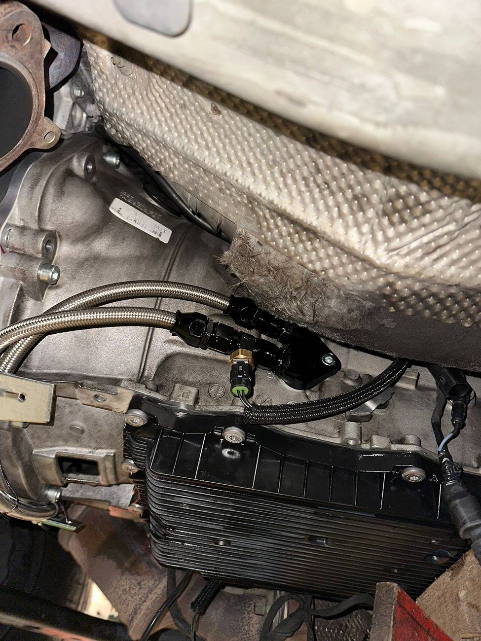

Wiring underneath the car is also finished(probably). The OEM harness has 3 connectors.
Oil Temp, VSS(OSS) and Reverse. VSS and Reverse wasn't a problem. I just use one wire from each connector for the signal and route it to the TCU controller.
Oil Temp was more work. I now use an aftermarket sensor that is screwed into an AN adapter.

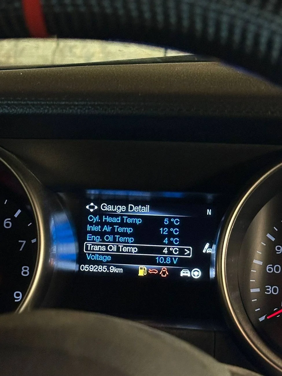

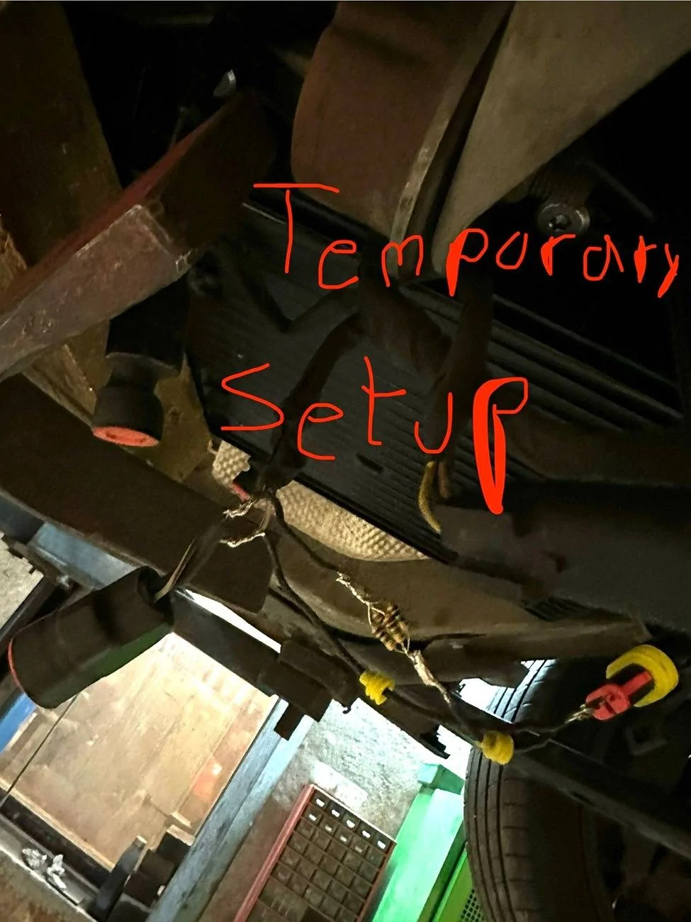

The new sensor uses a different scale so i put 4x 1/4W resistors in parallel to create one 1W resistor.
1 pic) Without resistor direct to aftermarket sensor
2 pic) Temporary resistor setup
3 pic) Accurate Temp
4 pic) Finished setup
5 pic) Oil Temp assambly
6pic) Sealed oem connector (nothing cut away so oem harness stays intact)
I also swapped out plastic zip ties with metal ones and put neopren between the oil hose and the bracket that holds it in place so nothing scrubs.

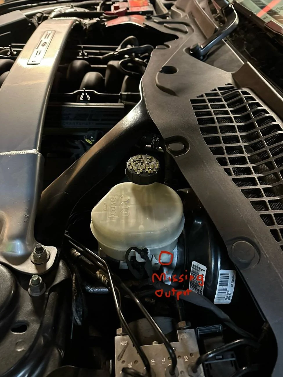

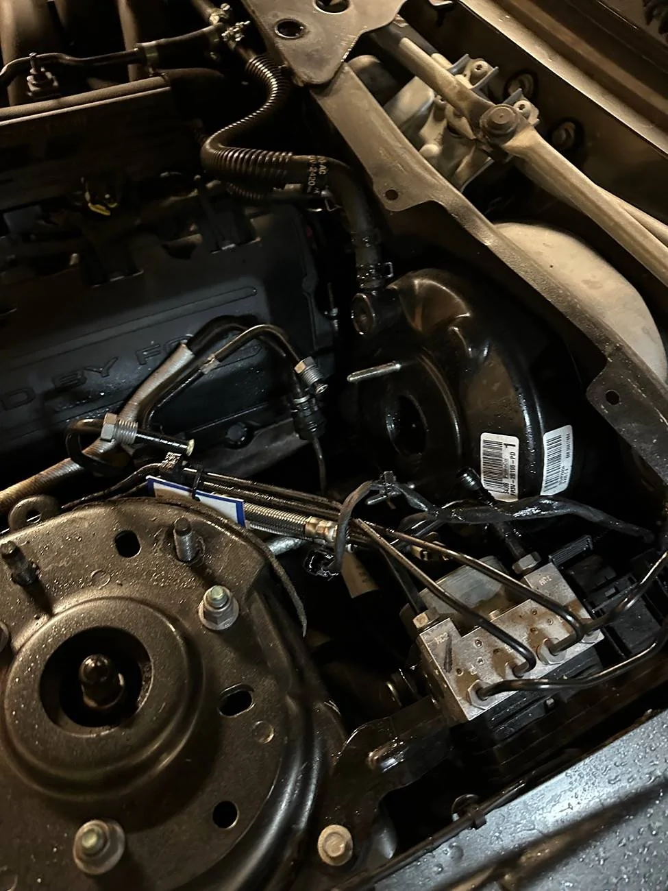

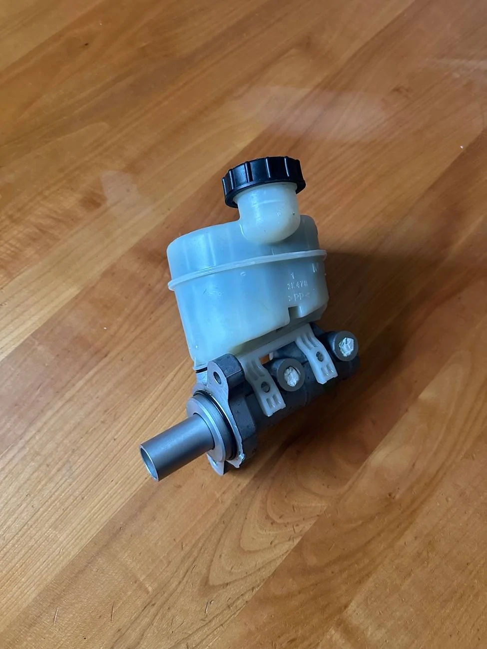

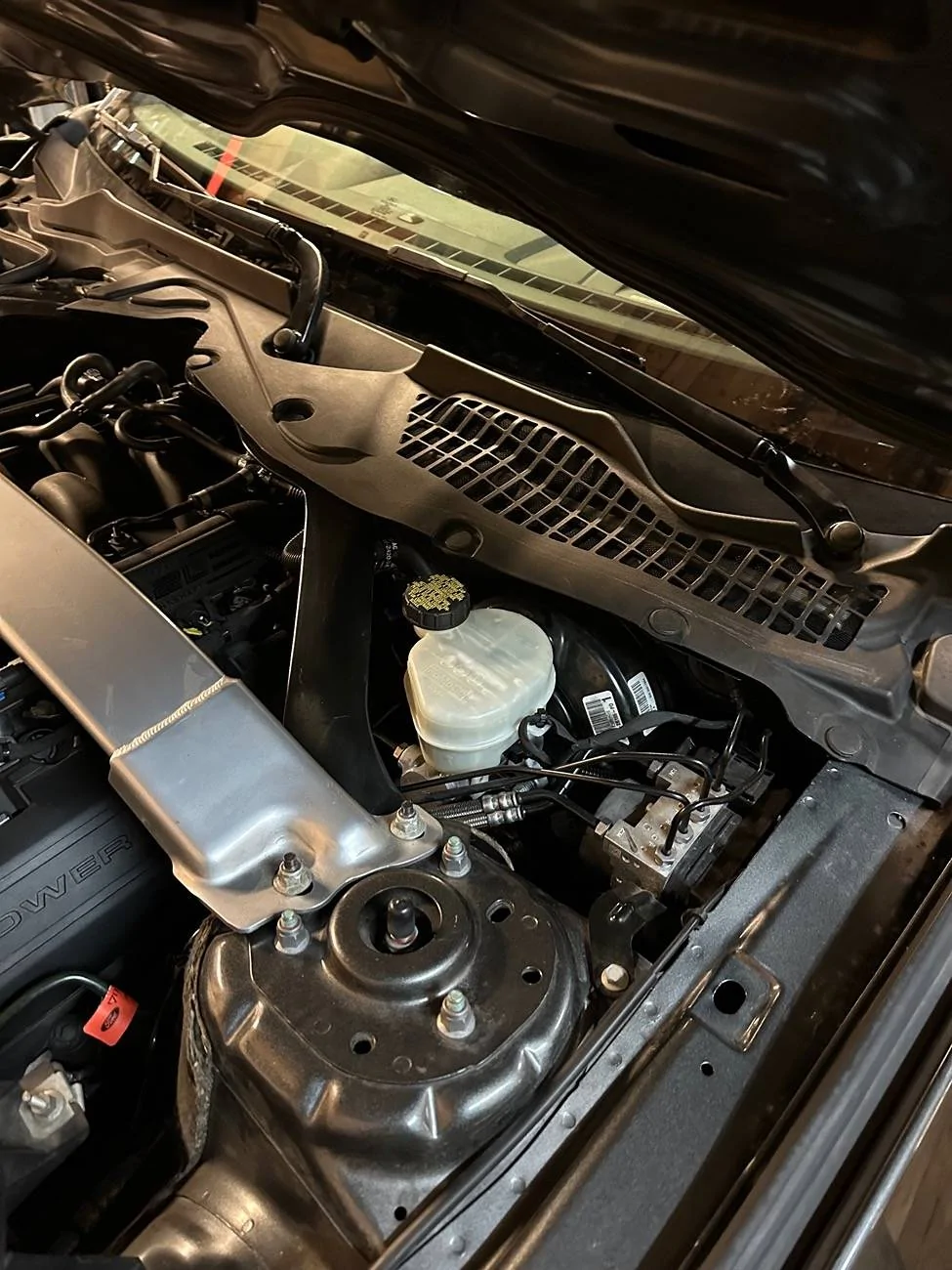

Changed my brake master cylinder since i don't need the output for the clutch.
This one is from a crashed ecoboost in Spain.
Fun fact the brake master for the gt350 is the same as the one for the base gt and ecoboost. The pp uses a different one.

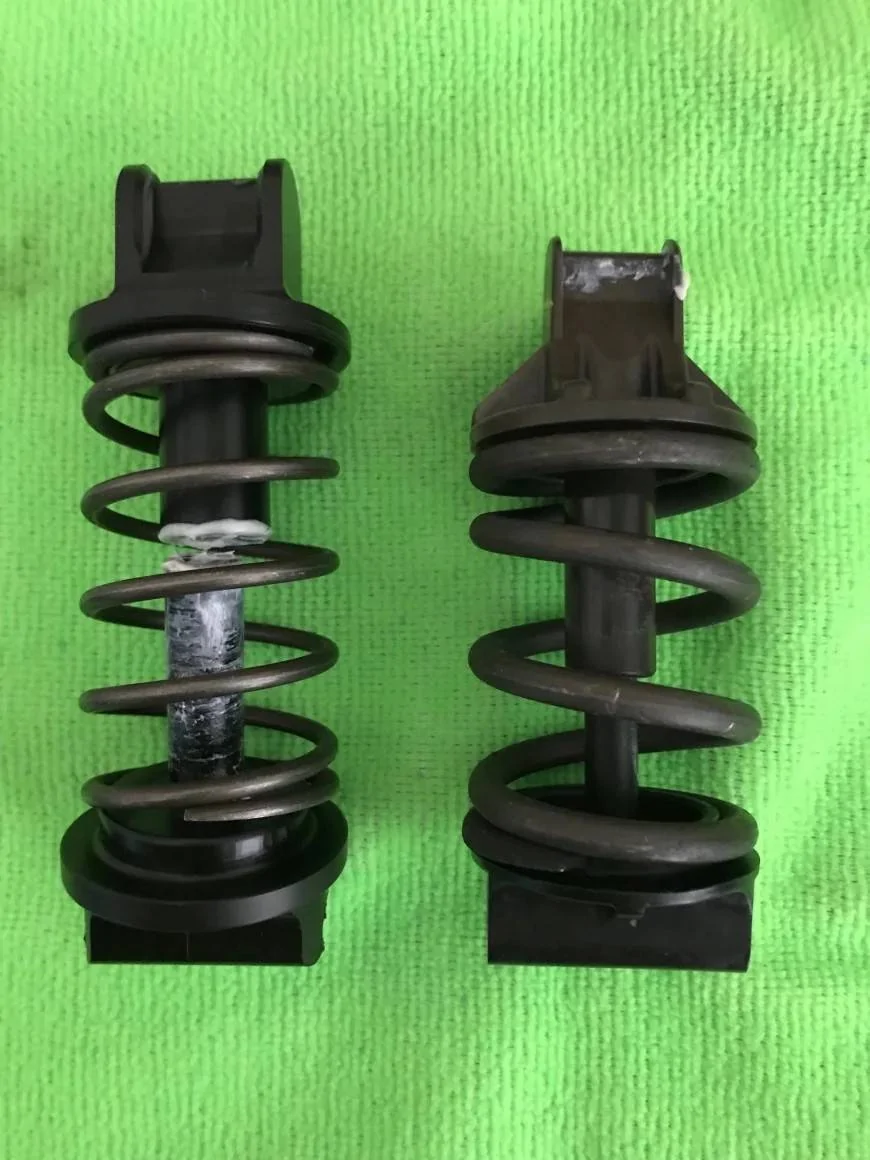

Is the pedal box of the GT350 different to the GT etc.?
The GT etc. habe this clutch spring assist:
